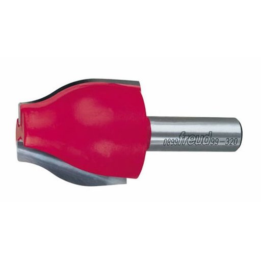

Here's something to consider when thinking about raised panels- the "vertical" router bits.
Because of the smaller diameter, they don't require quite as large of a hole in the router table.
