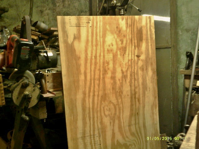

Made the lumber Run today....Cheapest 2 x 4 x8'  was..$3.15....at Lowes..  Got three and a 2'x4' panel of 1/4" plywood.   Good thing I get a 10% discount for my Mil. ID...

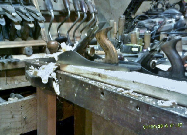

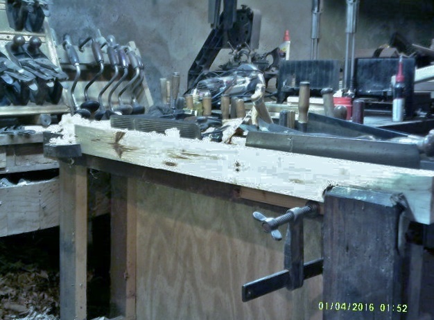

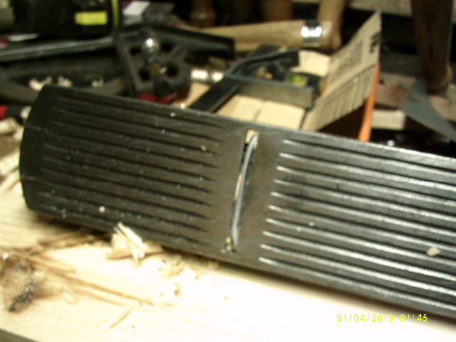

had four more blanks to surface S4S.. Used a couple larger planes for that job ( and you'll what the camera is doing, too)
That be a Stanley No.5-1/2, sitting in front of a stanley No. 6c   Apparently, the "Macro" setting was still on?   Or not..  Anyway, i got the four blanks looking decent enough..

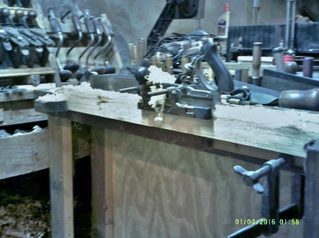

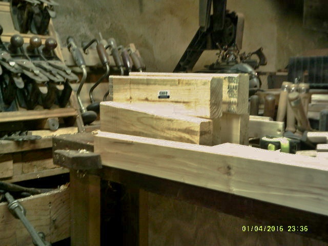

seems to be a lot of glare off the overhead light, too.  Decided to give the Stanley 45 a good run for it's money...

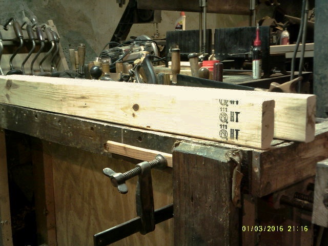

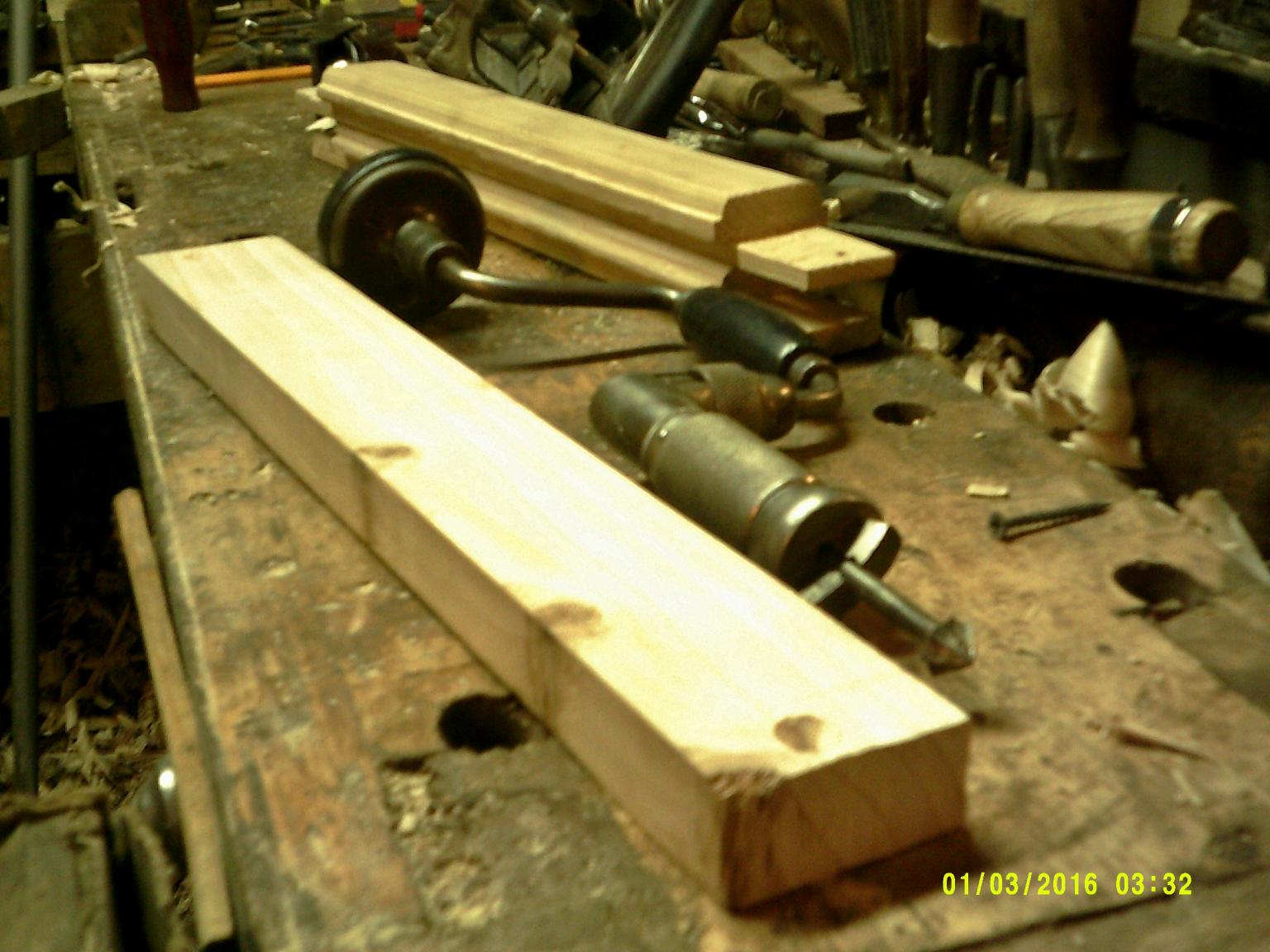

Got going too fast and rough on one edge...and the depth stop came off the cutter.    Got to checking the cutter....yuck, instead of a flat bevel, it has a rounded bevel...like a beer belly.  Will take the time tomorrow to straight that out.   Decided I could drill a hole into each end( tenons go there, anyway) and attach the blank to the side of the bench.   Needed to counter sink the holes a bit, so the fence won't hit the screws..countersink.JPG
Need to resize this one down, camera makes too big a picture.   Brace is a 6" Keen Kutter, by Millers falls.   Anyway, Once the blank was set up..
I could pound away with the 45.   Once each blank was done, time to make some tenons on the ends.   BTW:  I cleaned the rebate with an older plane..

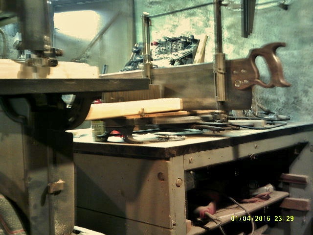

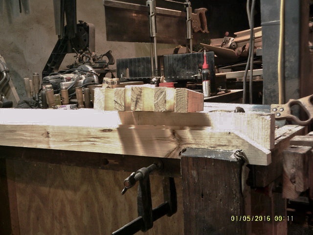

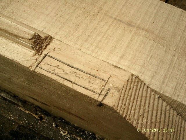

So,..tenons. I used the first blank to mark out where the tenons would be.   Took the blank around to the mitre box and cut the shoulders...

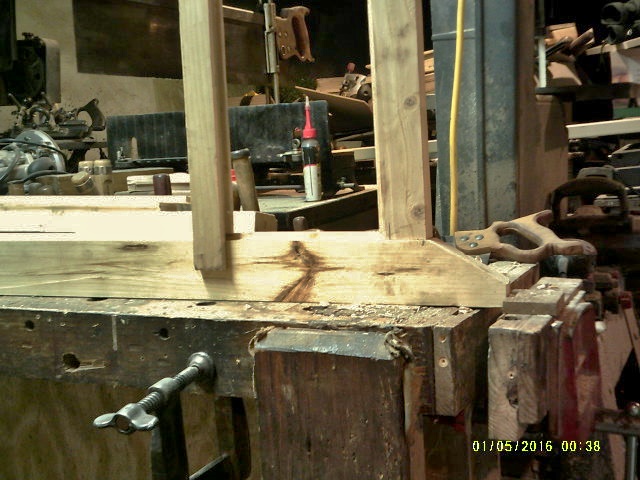

Has a stop cut set just about right.  Once both ends were cut, I could walk back around to the bench, and do the cheek cut..cheek cut.jpg
And let the waste drop off.  Cleaned up with a chisel..

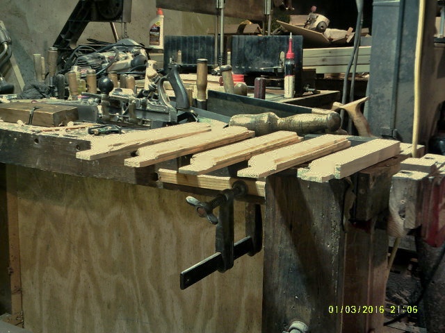

I got two with both edges done, and one for the bottom of the side.  The bottom and top blanks only have one molded edge.

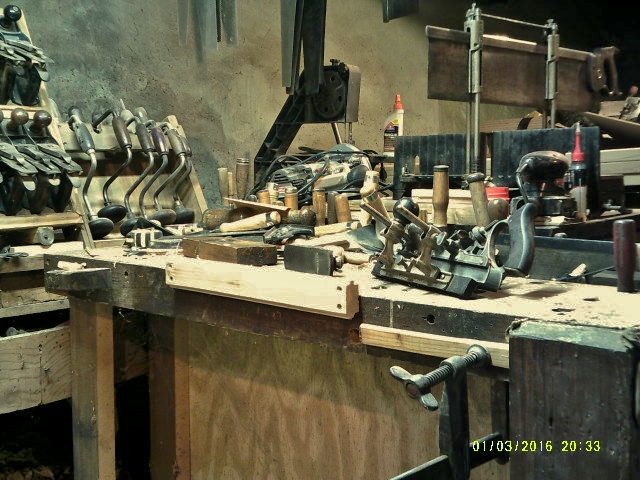

Ok, over in the thread about setting up the Stanley #45, I detailed what I had to do to tune it up.    I got the plane getting a lot better...but still needed a few other planes to tune the cuts..
Not too worried about those screw holes, either.   When I trim for the tenon, most of the holes get buried in the joint.  I even managed to get 5 rails done...only to find out I need a sixth one..finished rails.JPG

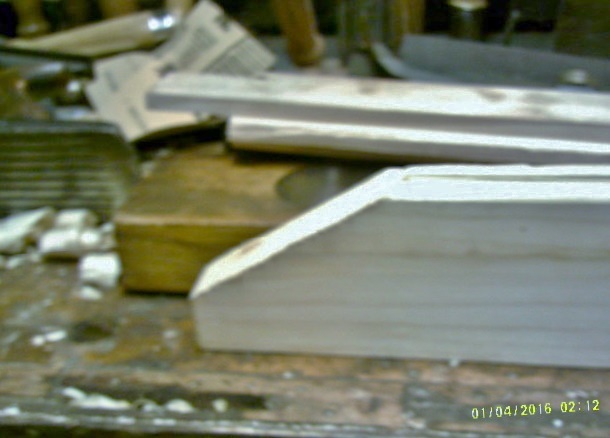

Hungry beasty.   Then jointed the edges,  a bit..
The big plane on it's side to the right? Stanley No.7c   Made  use of the crochet to help hold things in place.   Chose the best edge for the next step....

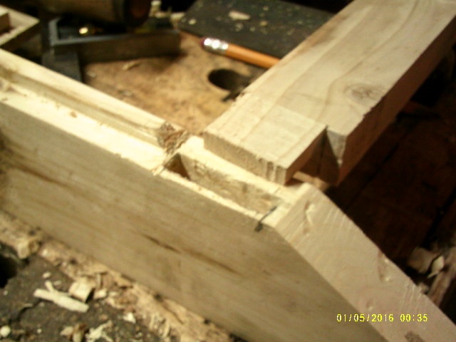

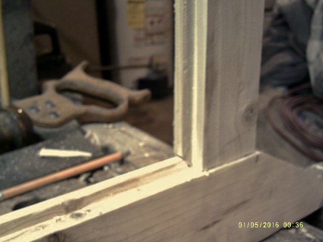

But, there was a problem with this set up, once i place the tenon into it's home..
It needed to be flush with the inside of the post......so, time for "Plan Boris"
I will come back a "daylight " that mortise. the rest of the rails will sit in stopped dados.   Laid one out here.  Need things flush on the inside, so panels made from this, will fit..
I'll cut out pans to fit from this 2' x 4' slab.   Two hours of shop time today.....might try for a bit more after Supper?    If not, there is always tomorrow..
