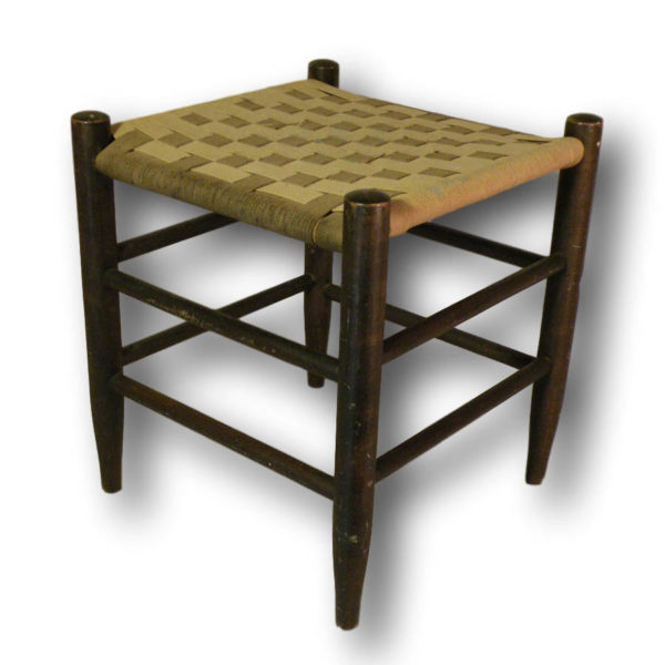

Hey guys, I am making a small stool today for my first shaker chair project, it's a warm up to get me used to using the lathe, and weaving the seat. The stool will be similar to the one below. My question is, the tops of the legs are rounded. And obviously exposed to view. When I turn these legs, which end should I mount to the lathes spur drive. I am using a traditional spur drive with a live center, if my terminology is even correct.

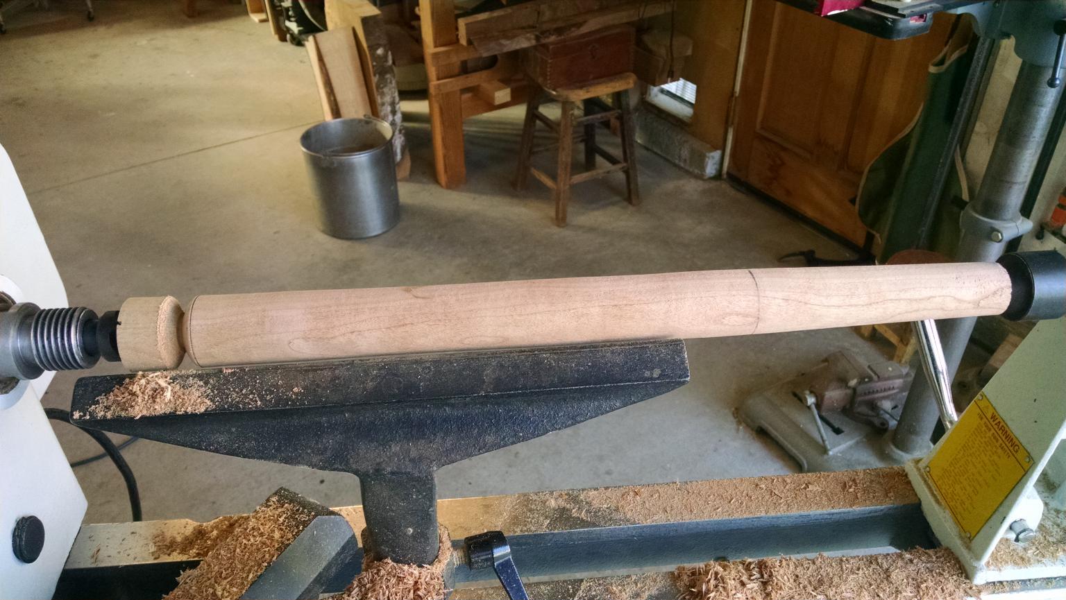

First leg done. Need to part the round top off. Top is at left, bottom at right.
I don't know how to part!:lol:
Couple of thoughts. When parting off, leave a little extra material on the turning and sand to the finished shape. Avoid using the parting tool to completely separating the the pieces. The spinning action of the lathe and inertia will tear the fragile last piece of connecting wood and it can pull out material on the end of the turning. Try using the parting tool and remove all but about 1//4" of the turning and then cut off with a hand saw- LATHE NOT RUNNING!
Another method of parting is using the skew chisel. It makes a "cleaner" cut. With practice you can cut completely thru without any tear out. You can also use a combination of parting tool and skew.

Lew has you going in the right direction John.  If you are not used to the skew use a small spindle gouge on the end to round it over.  You can work your way in as you are doing now and get most of the top smooth before sawing off the last eighth inch or more.  The parting tool leaves a rough surface so use a slicing cut with the spindle gouge across the end grain and not a scraping cut.

John you have some good advise so far. I would do some practice cut offs to try to get a smoother finish. Another thing to try is to use the spindle gouge to get down to about 1/4 inch then sand the rounded area to finish grits and then part or finish cut with a skew or spindle gouge.
