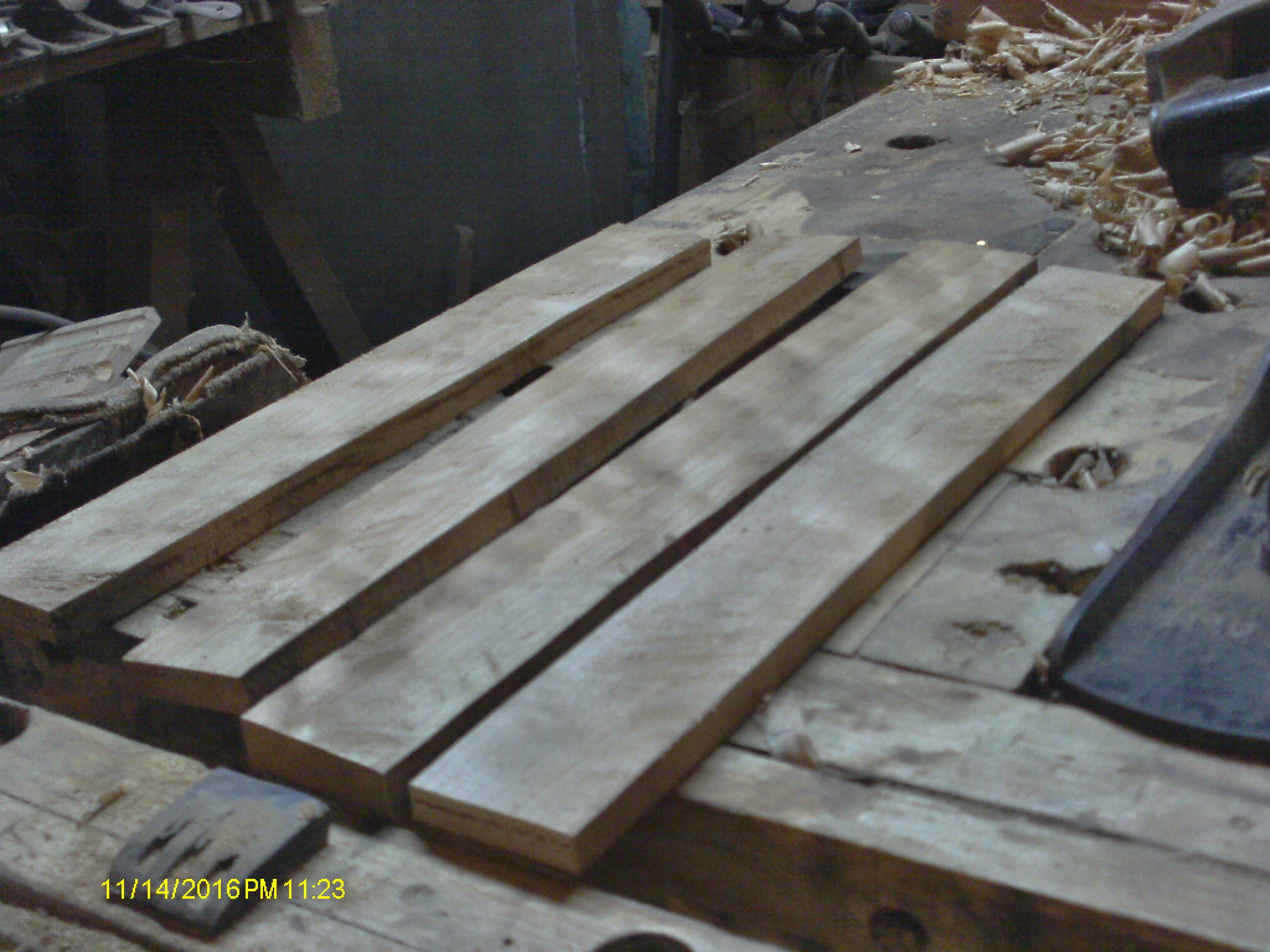

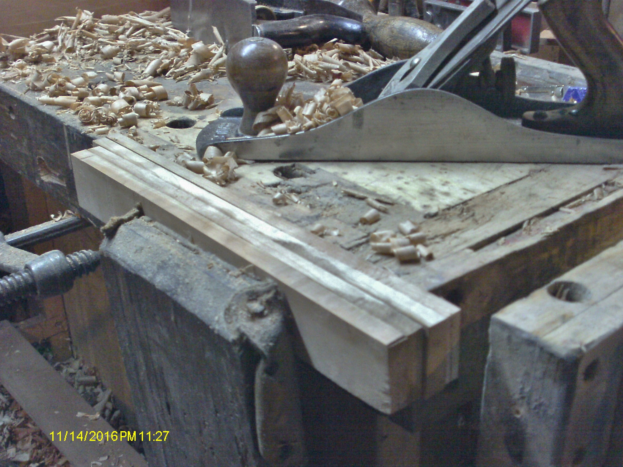

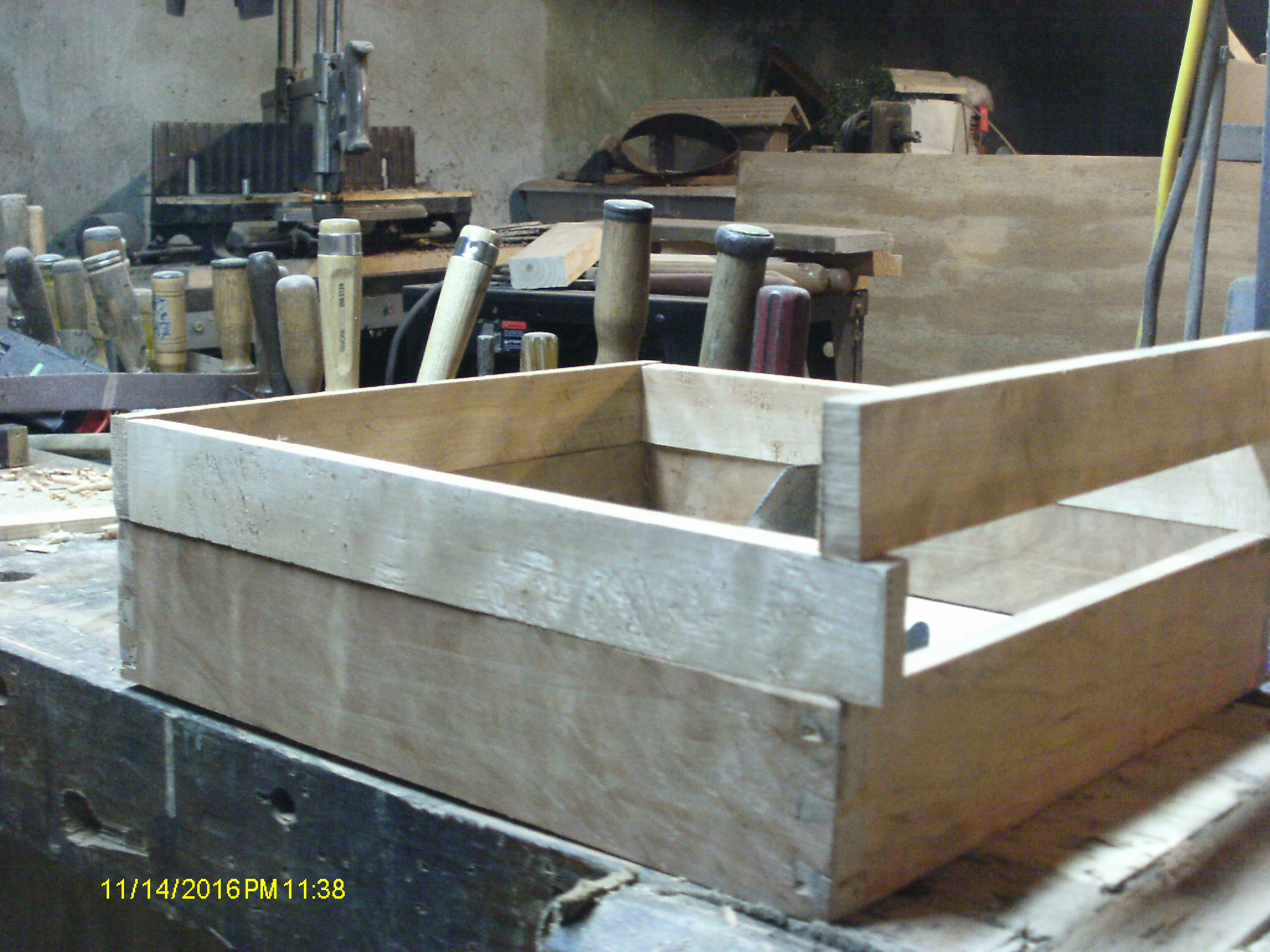

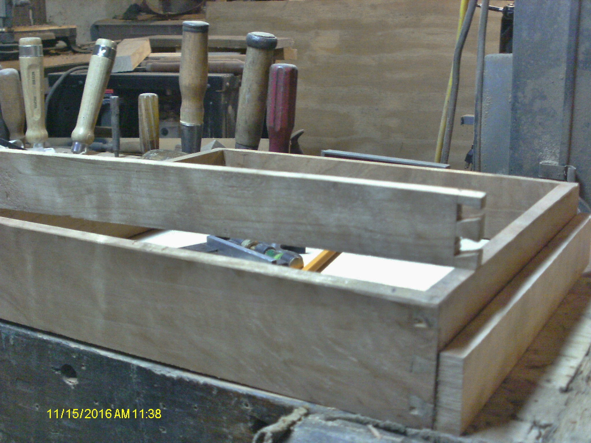

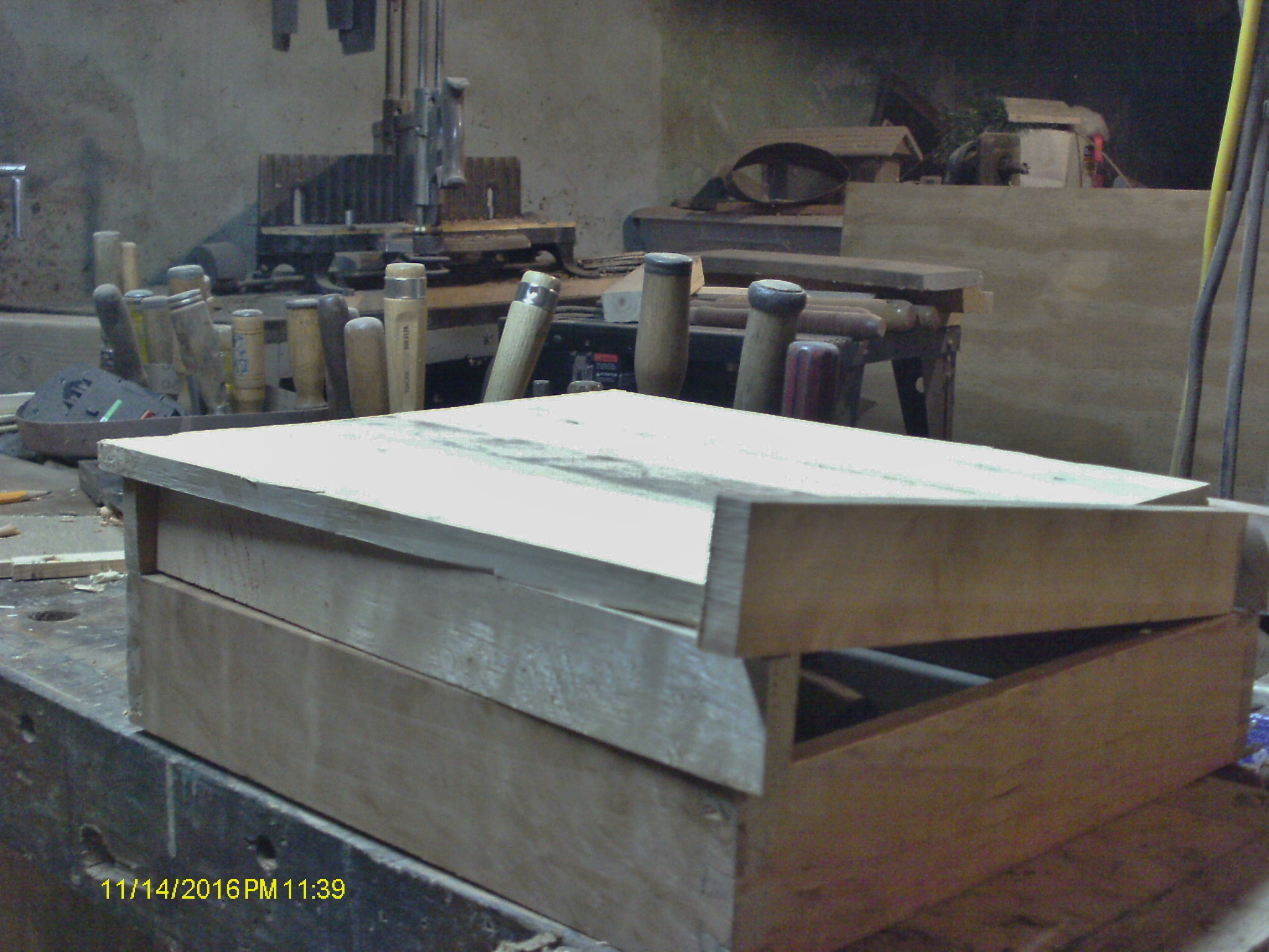

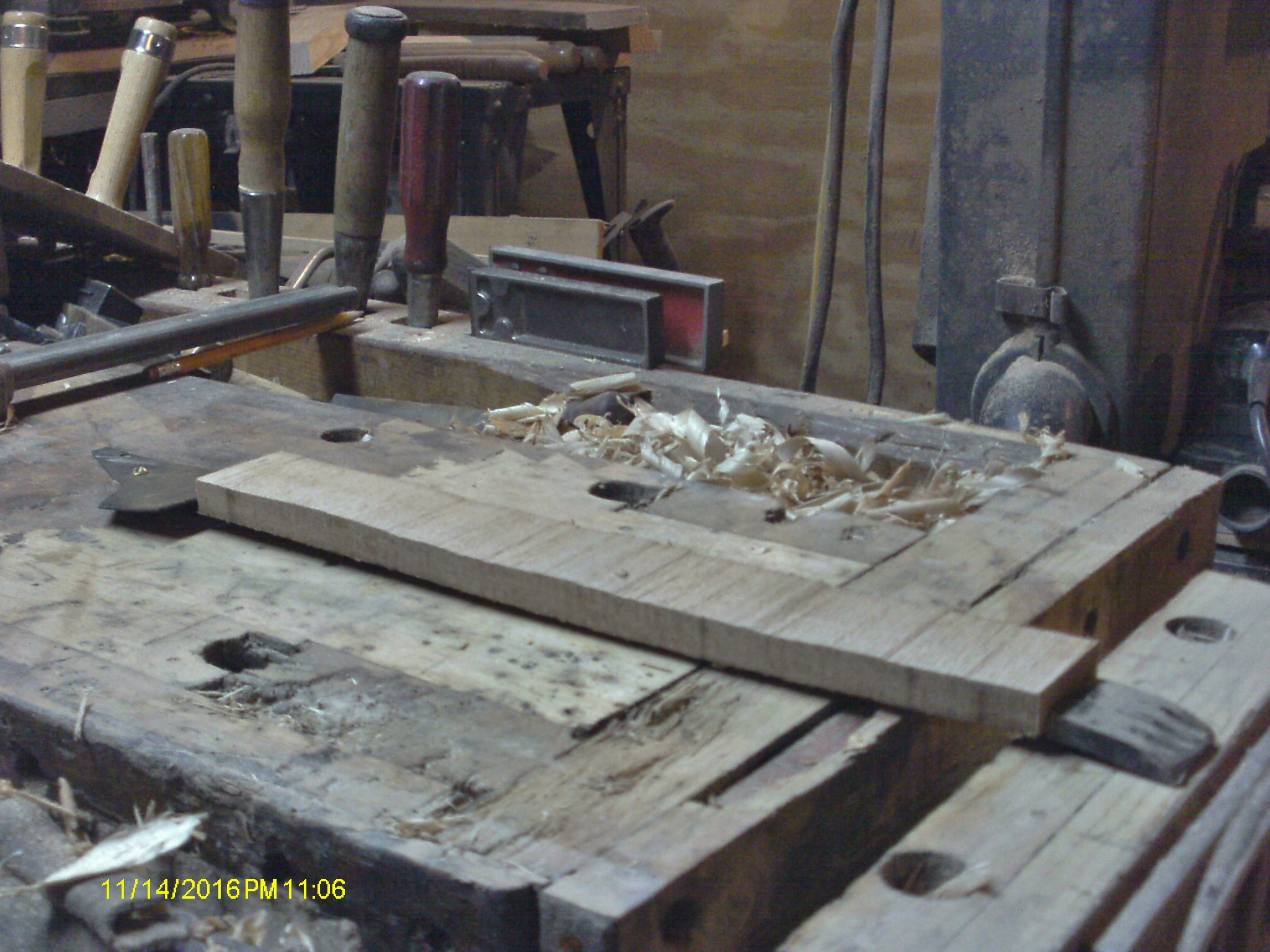

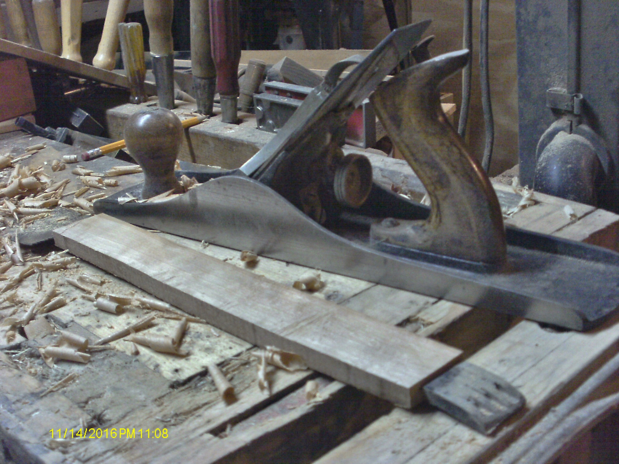

November 15, 201610 yr comment_84228 Ok, time for the "late Edition", Went back down to shop for a bit....had a little more work I could do.. Yeah,,, ugly things. We have ways of flattening this out.. Called a Jumbo Jack plane. Jack plane on steroids. The weight will help keep the board down onto the bench. Have to do both faces, and even a few smooth plane passes... Until I get these four slats, fairly straight, and smooth.....enough to at least work with them. But, there are those edges.. Back to the Jumbo Jack. Make one side straight, and then gingerly flip the sammich over, and do the other edges. Without any of them moving around...mallet comes in very handy.. Testing the fits... Have to allow for joinery on the ends. Longer sides were ok for length, had to trim the shorter two a bit......Stack all the mess up into one spot.. Have a few more jobs to do with this mess...dovetailed corners, a Stanley #45 to plough a groove for the panel, size the panel and raise it, Might take a day or three..."Say Goodnight, Gracie" Report

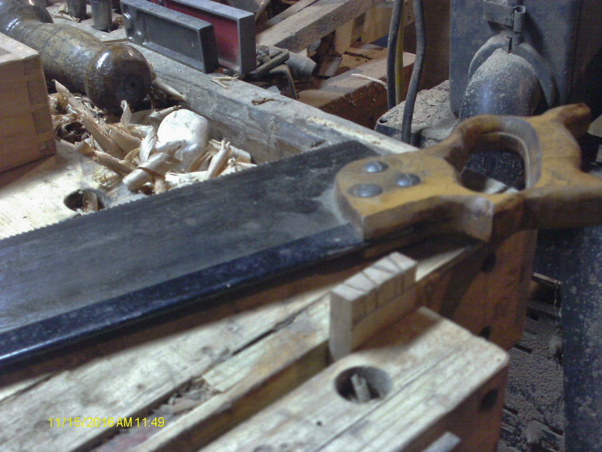

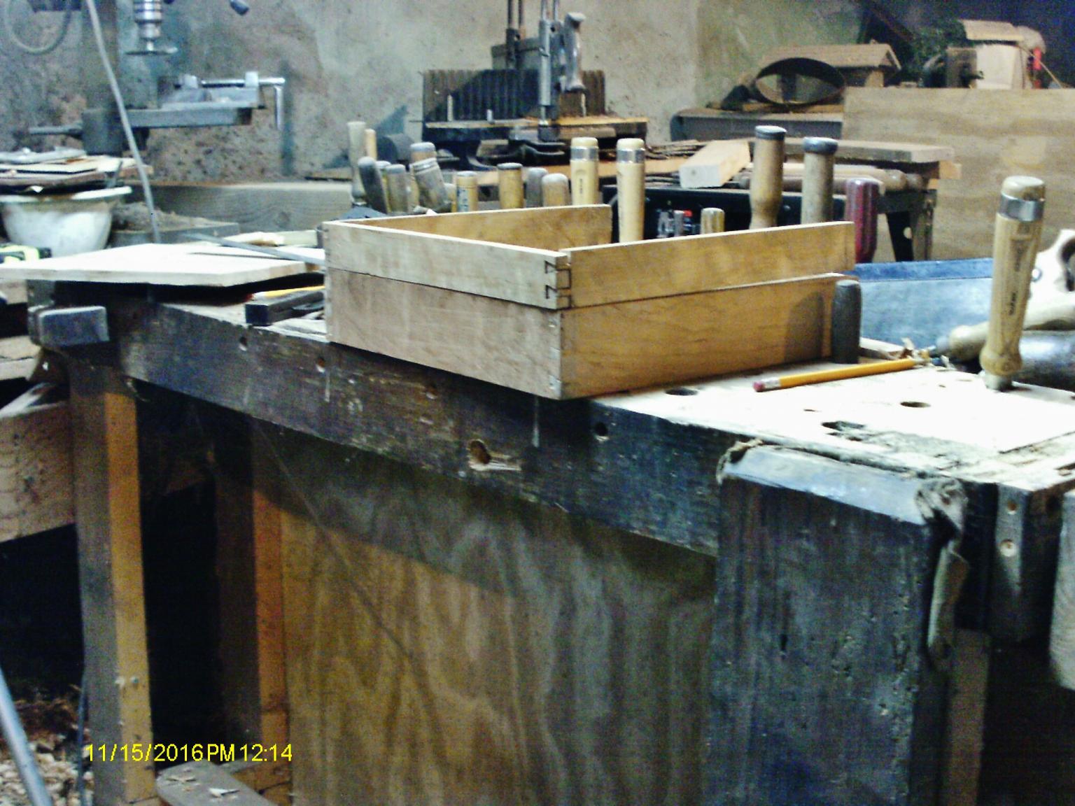

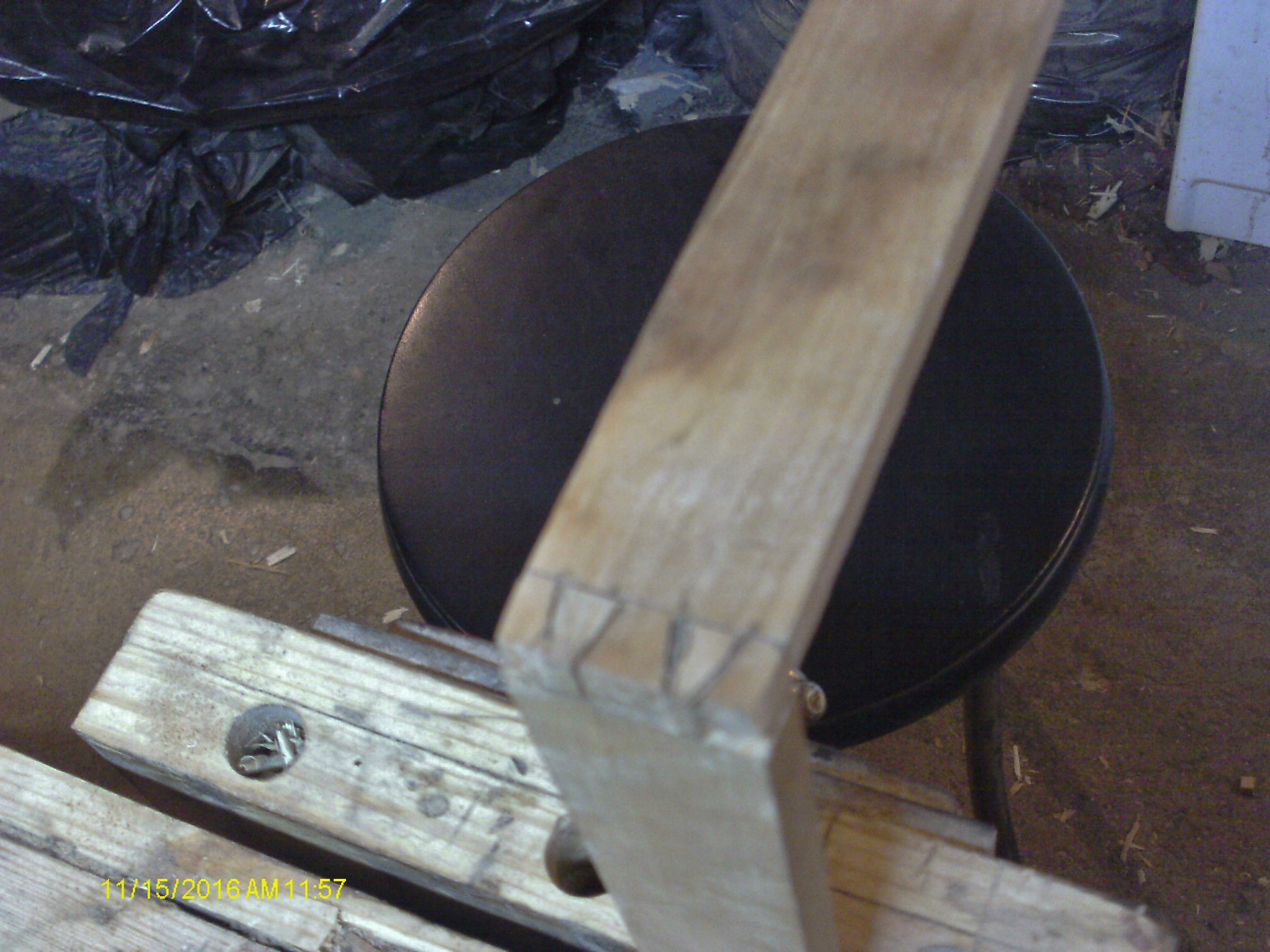

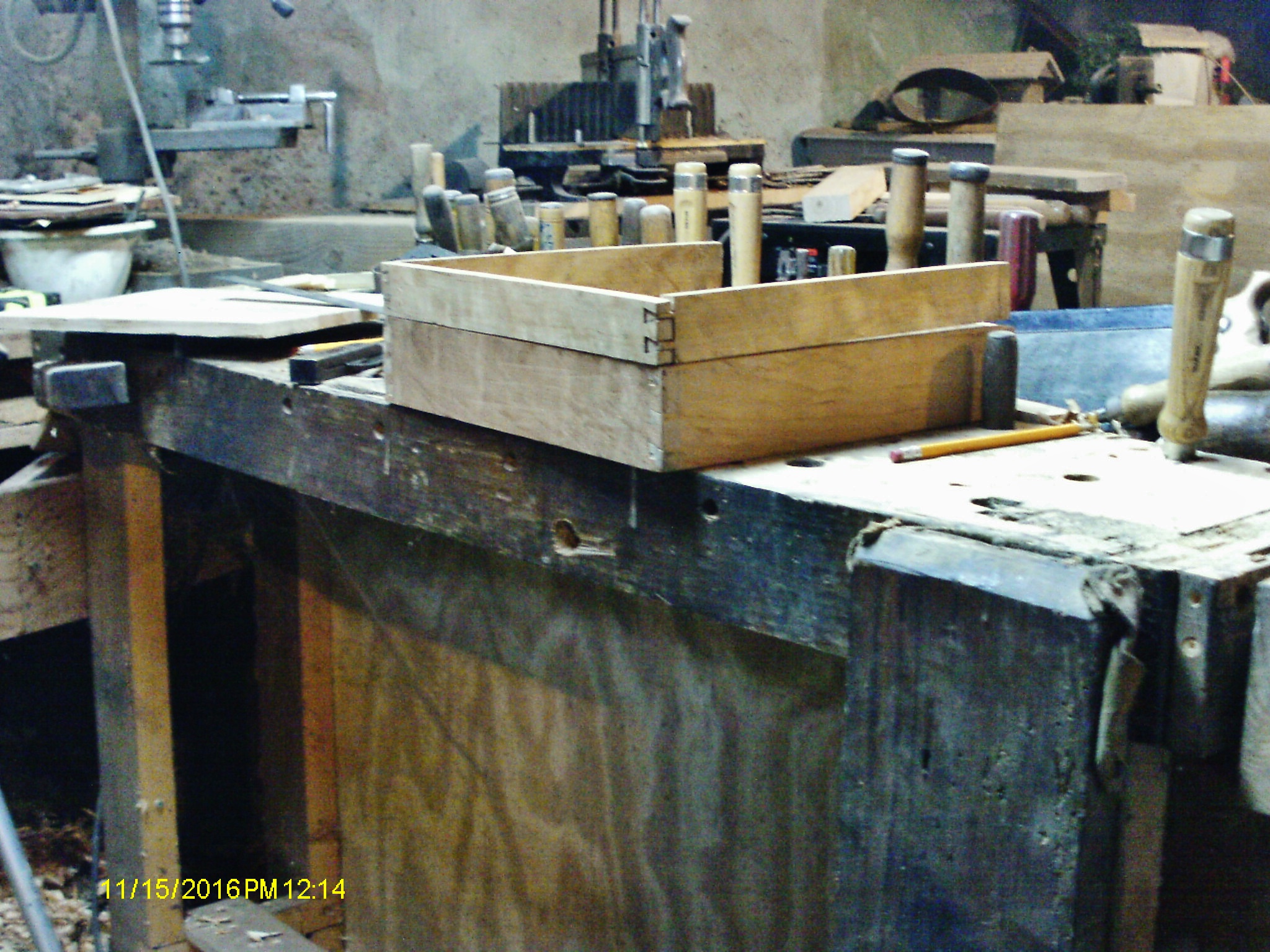

November 15, 201610 yr Author comment_84280 Did a little bit this morning, before errands get ran... I usually don't like to do tails first, because when I then do the pins... I forget which side of the lines to saw on, leading to something like this.. Not really that bad. Second corner, I remembered which side to run the saw on.....tighter joints.. I can fill those gaps with sawdust and glue. Second corner is mallet driven together. Went to Lunch, will leave the other two joints for when I come back after errands are ran. Will do pins first on those corners. Need to get these done, and dry fitted up...THEN I can size the raised panel and start on it. Need to dig out the Stanley45 and set up for 1/4" x 1/4" grooves. Panel will need some place to sit, after all.... Report
