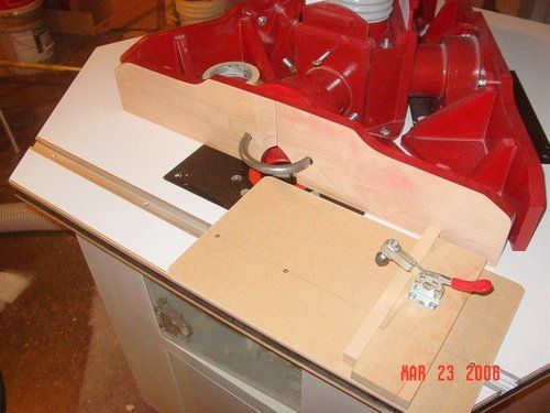

October 27, 201610 yr comment_81084 2 hours ago, HARO50 said: When using a sled, is the workpiece not higher than the table? Wouldn't this be a problem? Or is the base of the sled so close to the bit that it wouldn't matter? John It is higher than the table but so far that hasn't been a problem as the sled base does run close to the bit. I mostly use this for stick and cope joinery. Report
October 27, 201610 yr comment_81095 3 hours ago, HARO50 said: When using a sled, is the workpiece not higher than the table? Wouldn't this be a problem? Or is the base of the sled so close to the bit that it wouldn't matter? John I think you have to set the bit height to compensate for the thickness of the sled . Herb Report

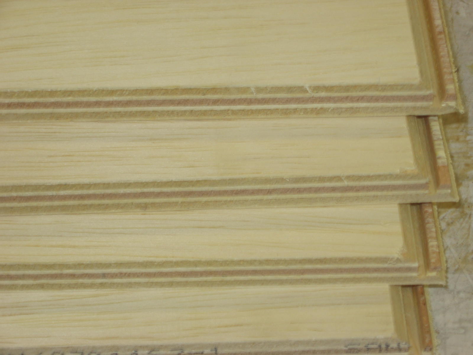

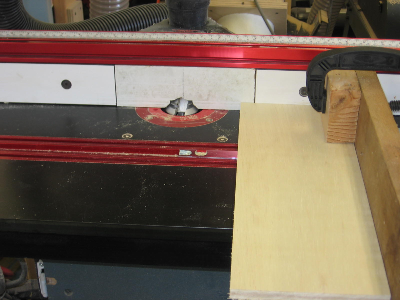

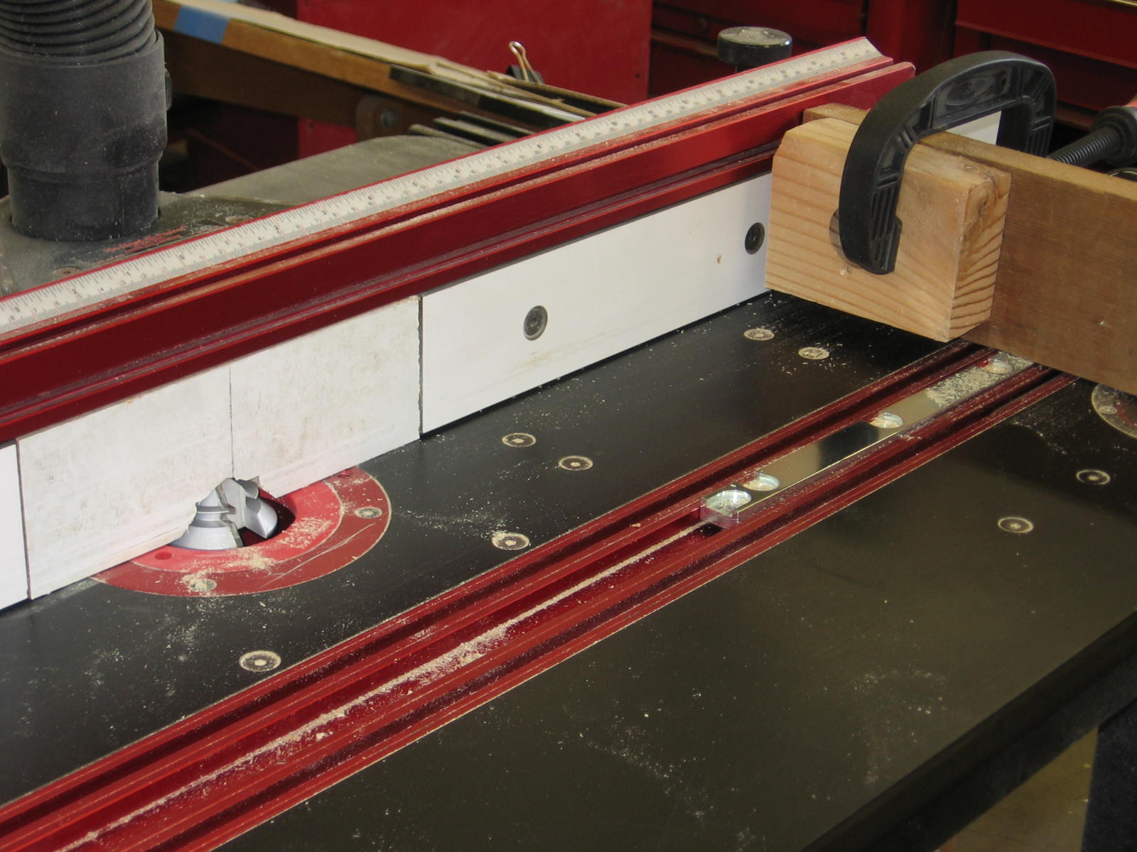

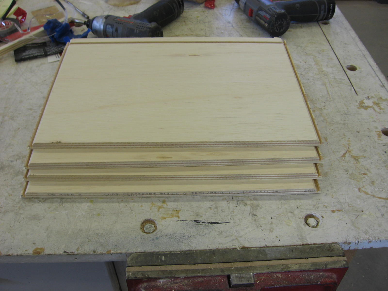

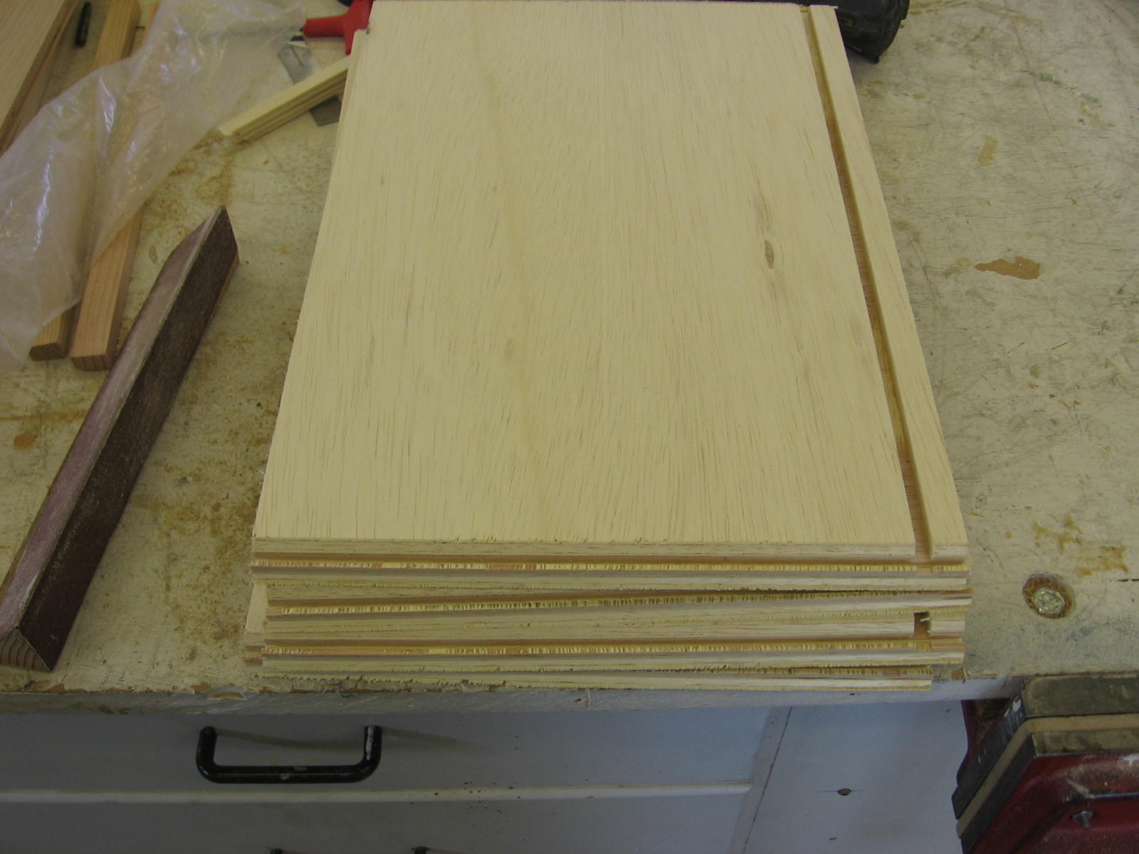

October 27, 201610 yr comment_81099 Here is an example of using a miter gage on a router table. It gave me a lot more stability than free hand. Herb Report

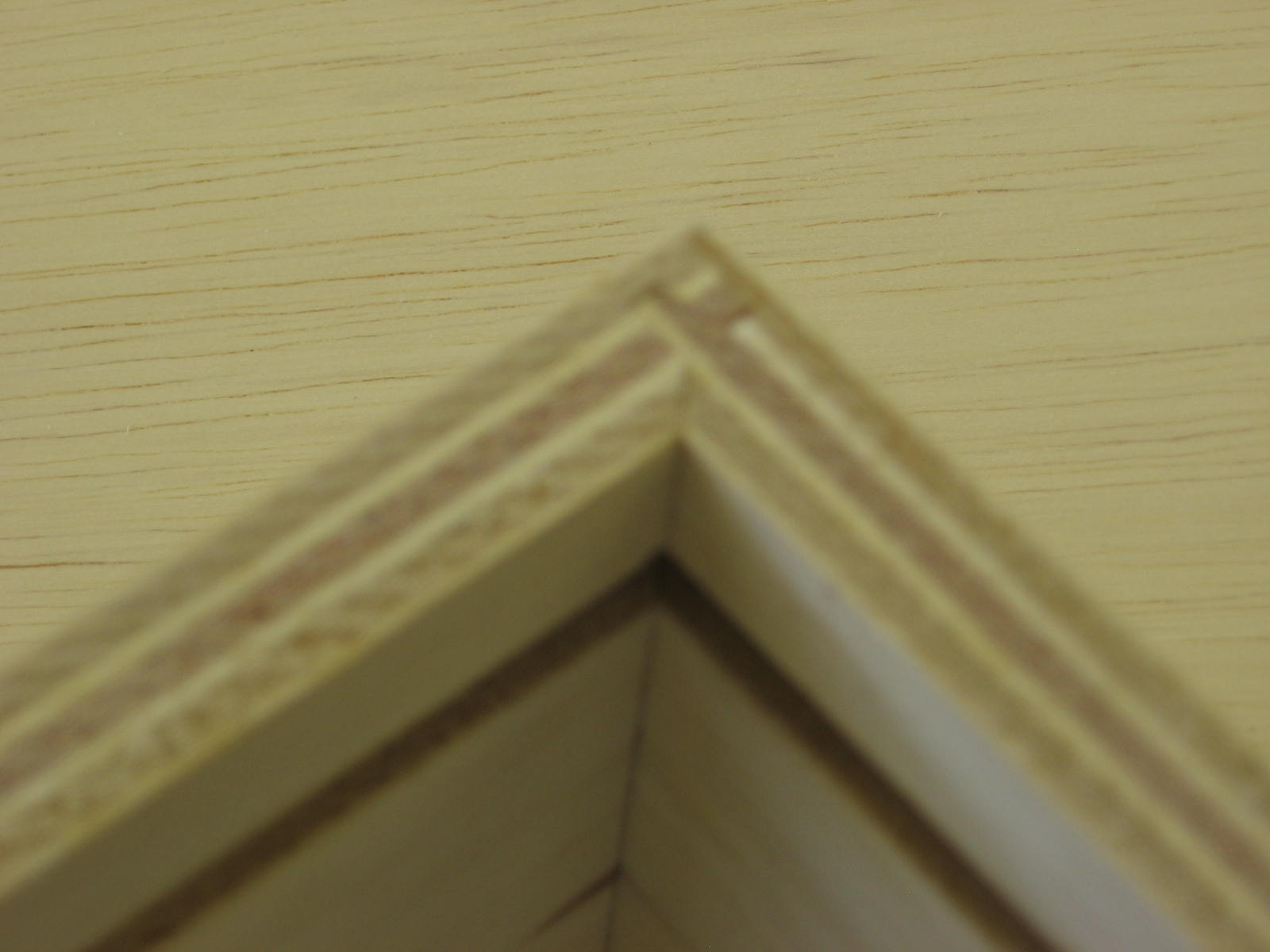

October 27, 201610 yr Author comment_81101 38 minutes ago, Dadio said: I think you have to set the bit height to compensate for the thickness of the sled . Herb I realize that, my concern was that the workpiece would dip lower than the sled, but I see where the sled (carrier?) is very close to the bit, so that wouldn't be the case. In the pictures, is that a lock miter bit? John Edited October 27, 201610 yr by HARO50 Report

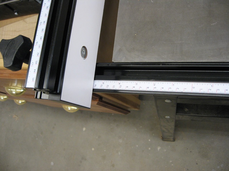

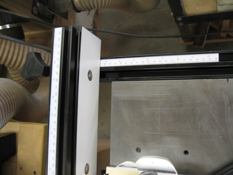

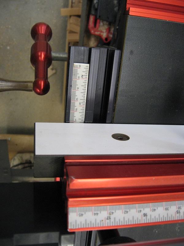

October 27, 201610 yr comment_81105 13 hours ago, Dadio said: If you measure the distance from the bearing to the "T"-slot then set the fence the same on each end, the miter gauge will be perpendicular to the fence if the miter gauge is set @ 90deg. My fence is set on 2 rails at the ends of the table. There are tapes attached that read in metric and emperial units. I can set my fence to the tapes and it is parallel to the "T"-slot.. Herb I like the sound of your fence attachment . Do you have a picture? Report

October 27, 201610 yr comment_81124 53 minutes ago, HARO50 said: I realize that, my concern was that the workpiece would dip lower than the sled, but I see where the sled (carrier?) is very close to the bit, so that wouldn't be the case. In the pictures, is that a lock miter bit? John Yes ,John,it is a Lock Miter bit on a set of drawer sides. 36 minutes ago, Gerald said: I like the sound of your fence attachment . Do you have a picture? I will post some pictures soon. 15 minutes ago, lew said: that's right but the sled is about .25" thick so I do have to raise the bit to compensate. It hasn't been a problem for my projects. I think you are already doing that since you are setting the bit to make the correct cut on the material. Say if you left your bit set at that height and tried to make the cut without the sled, it would not cut at the correct height, the bit would be too high. Herb Report

October 27, 201610 yr comment_81127 Most sleds work for the material laying flat on the sled. A different type of sled is required for the material being held vertical against the fence. Herb Report

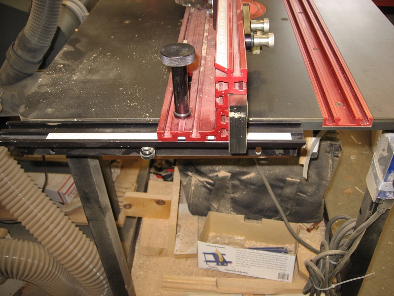

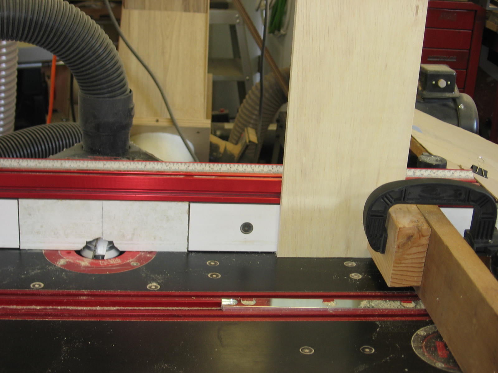

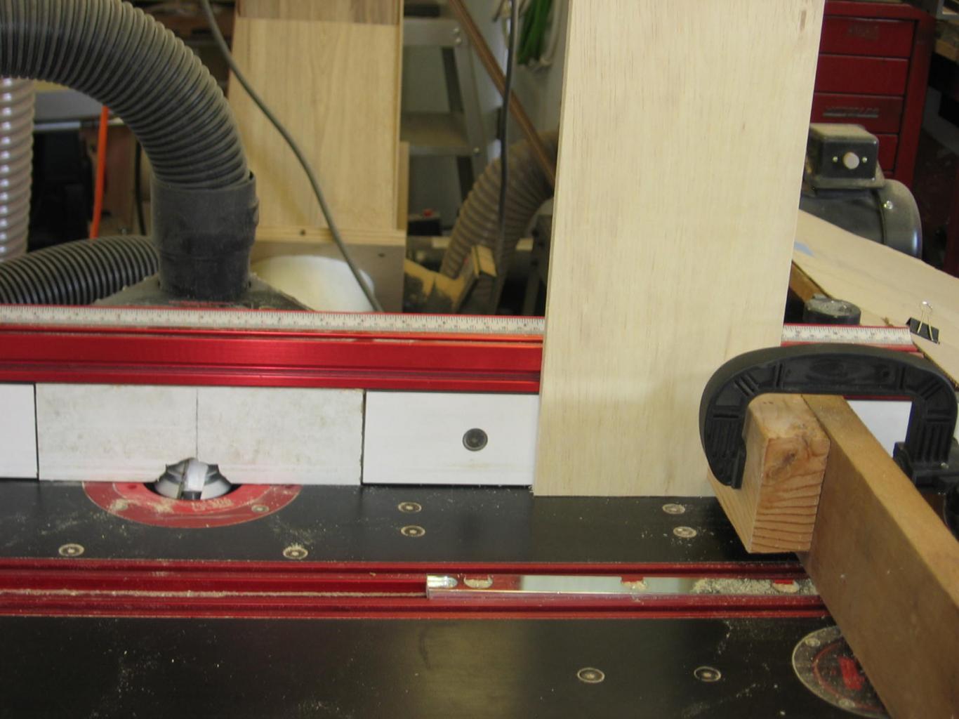

October 27, 201610 yr comment_81135 1 hour ago, Gerald said: I like the sound of your fence attachment . Do you have a picture? Here are some pictures of both tables. Herb Report
October 27, 201610 yr comment_81138 26 minutes ago, Dadio said: Here are some pictures of both tables. Herb Is that fence in the first pic all made from double channel or did you purchase commercially? Report
October 27, 201610 yr comment_81163 1 hour ago, Gerald said: Is that fence in the first pic all made from double channel or did you purchase commercially? Gerald, I purchased the table used off Craig List and the fence was on it. The whole thing is made by Jessem, lift,table, and fence. Report

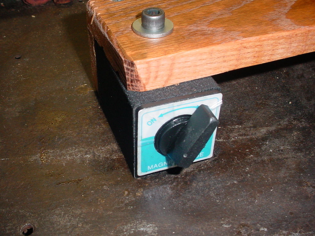

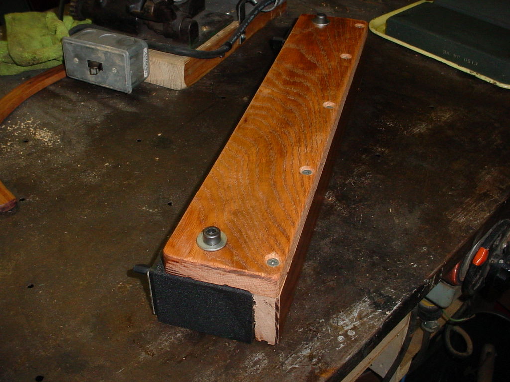

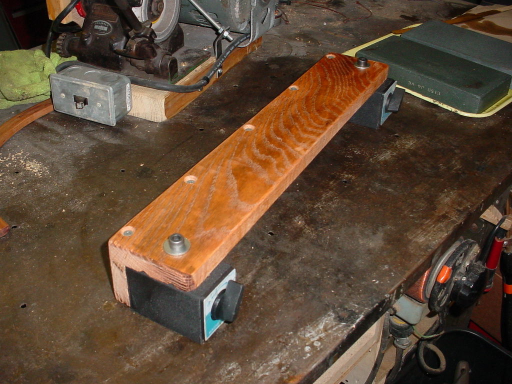

November 18, 20197 yr comment_209253 I use a miter gauge fence mounted on two Big dial indicator magnets bases that can be used on any of my table saws, band saws or router table. Report
