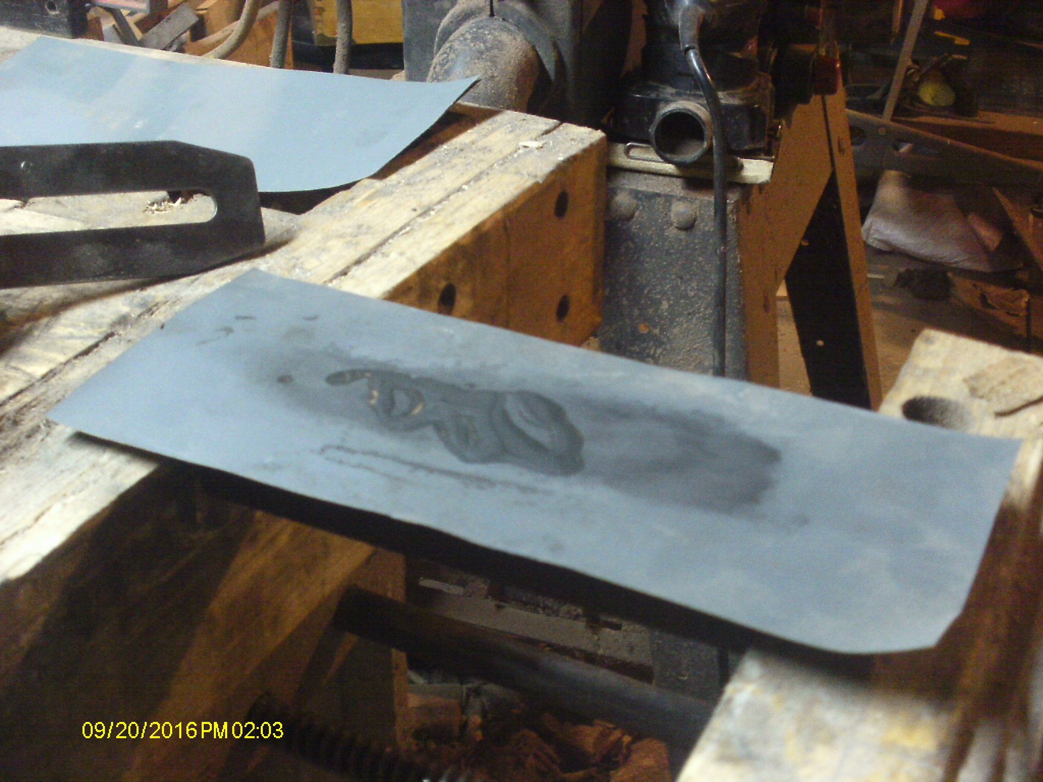

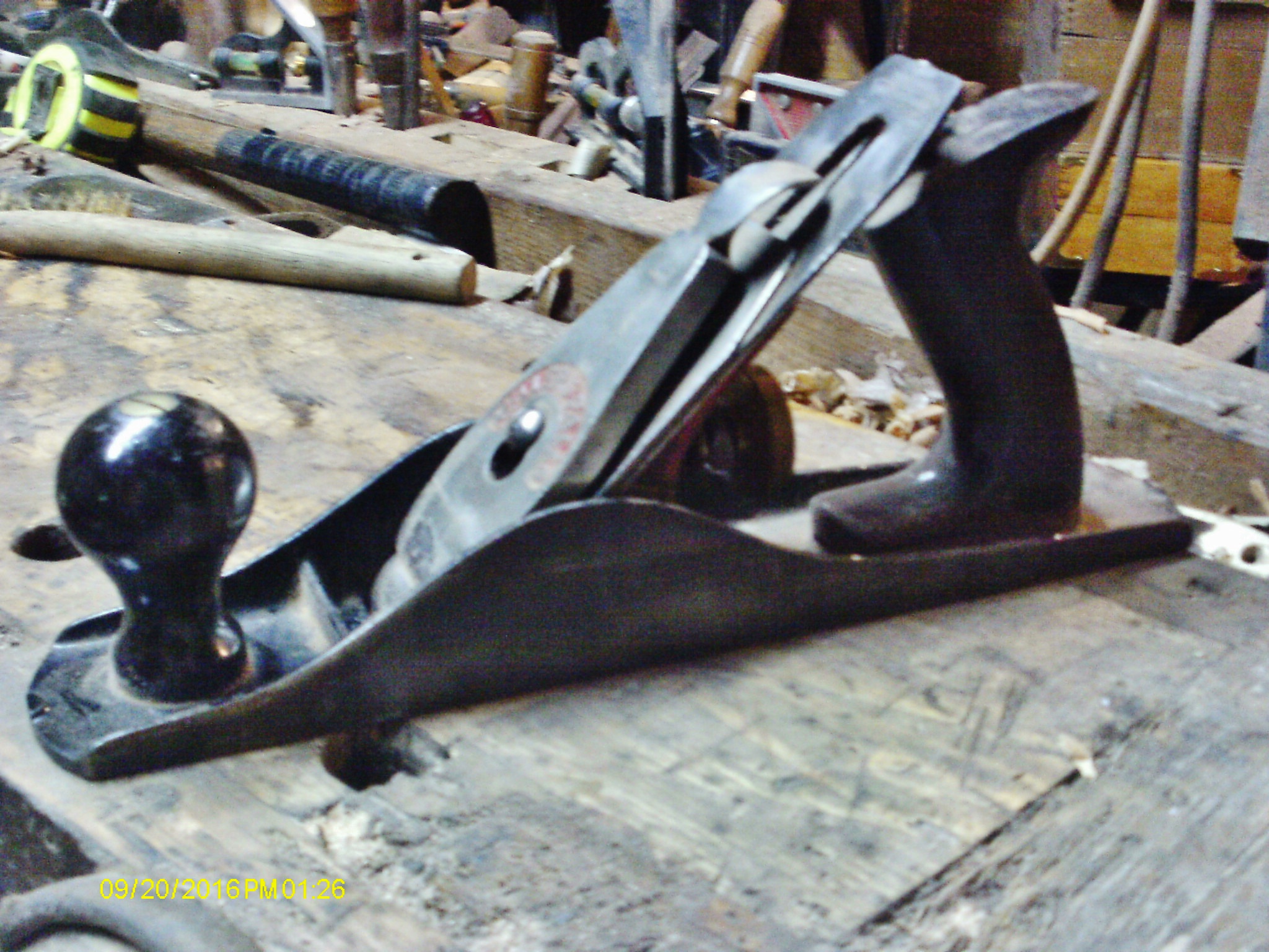

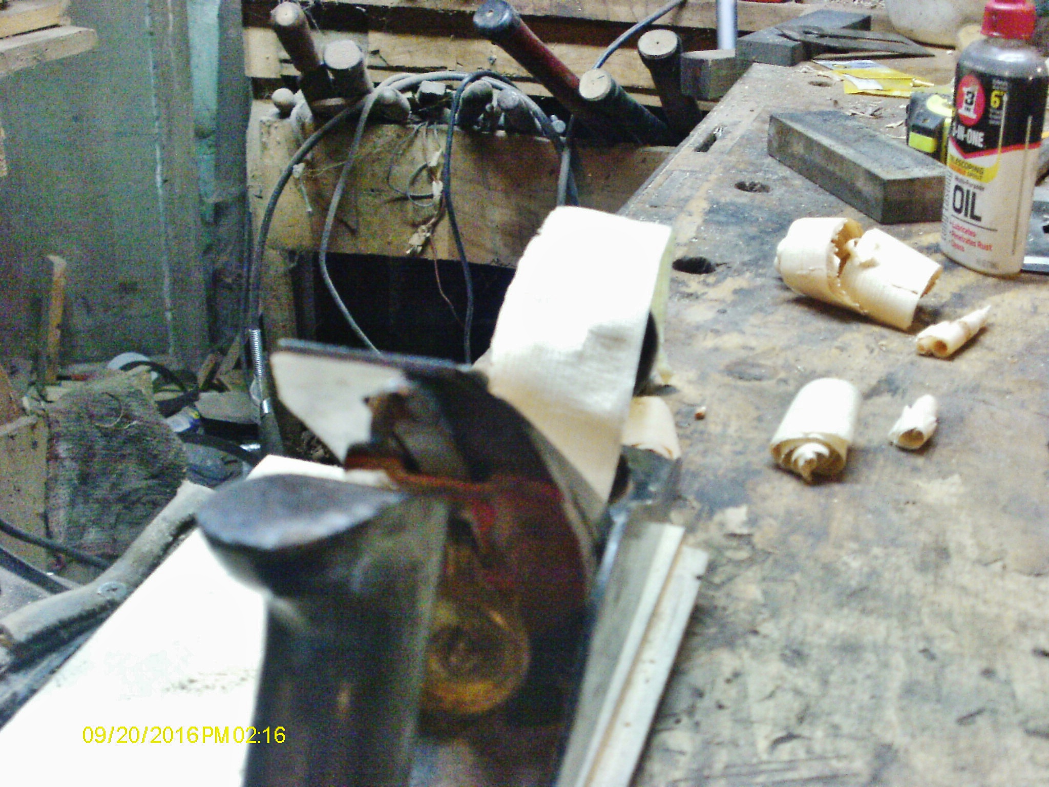

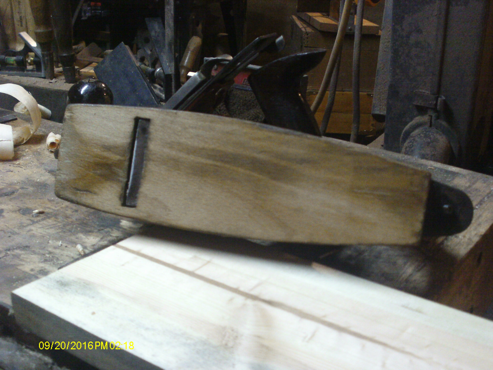

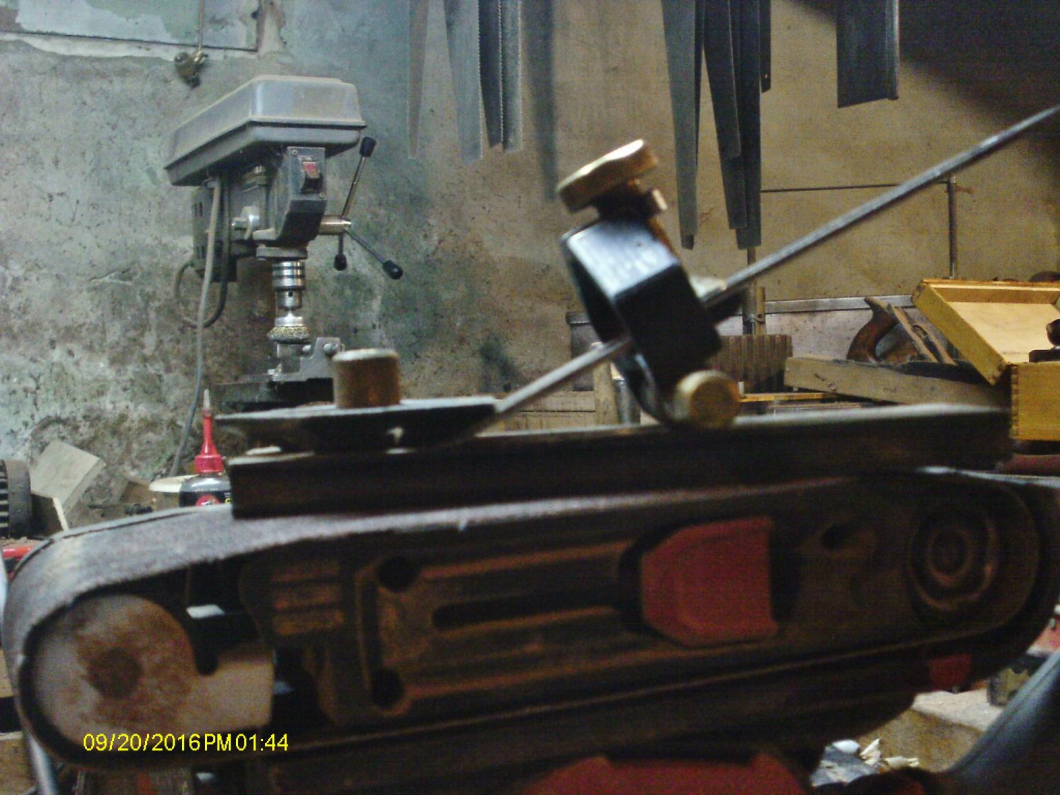

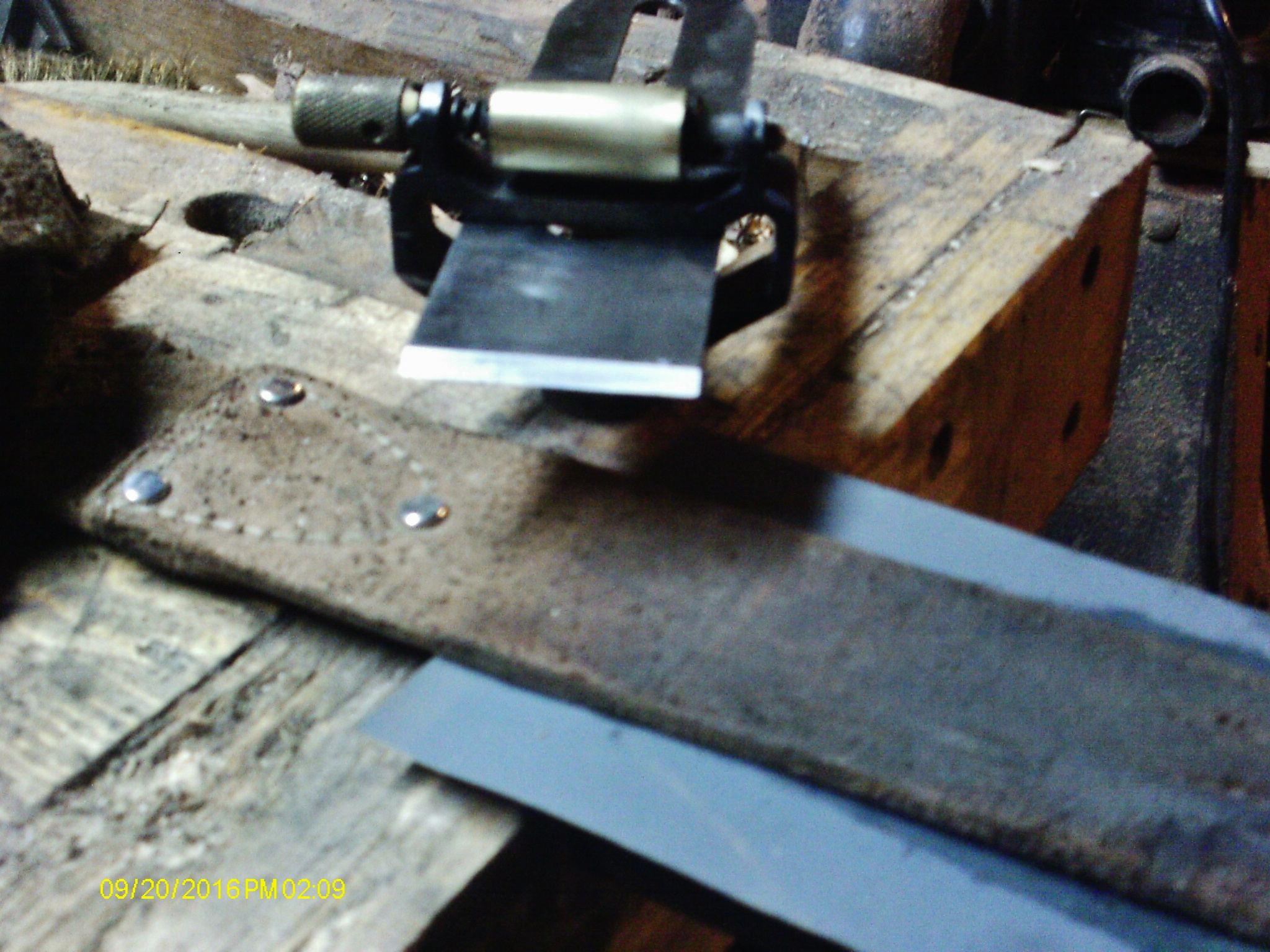

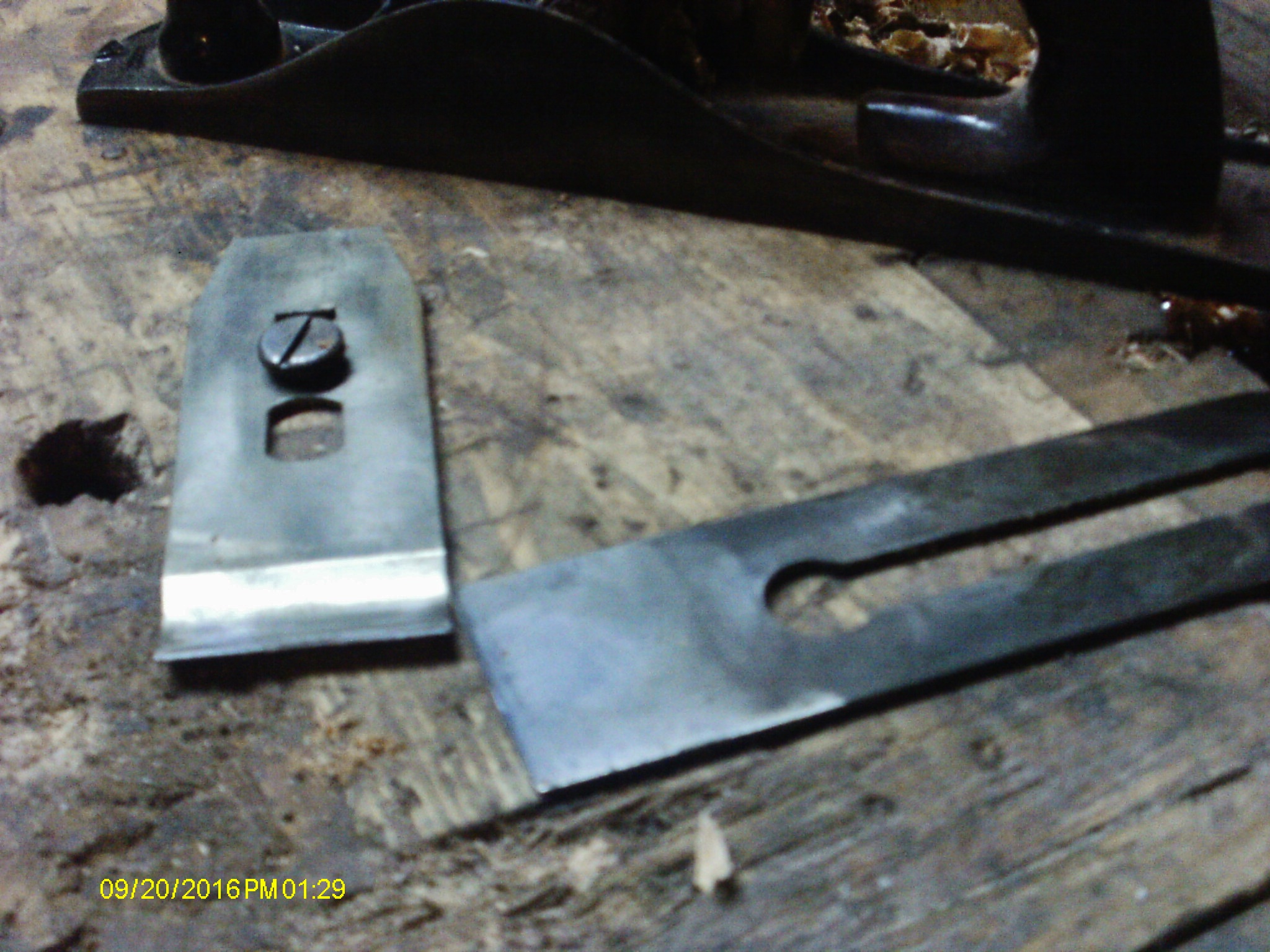

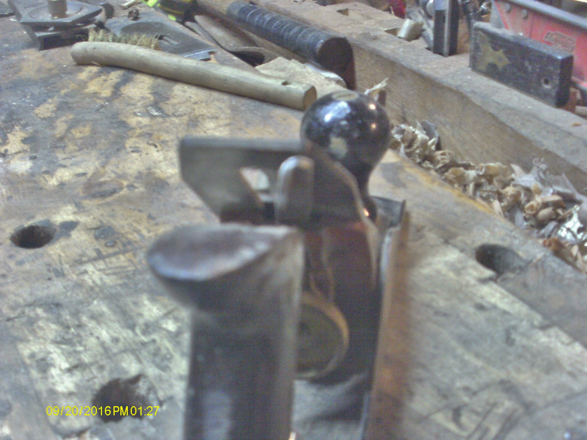

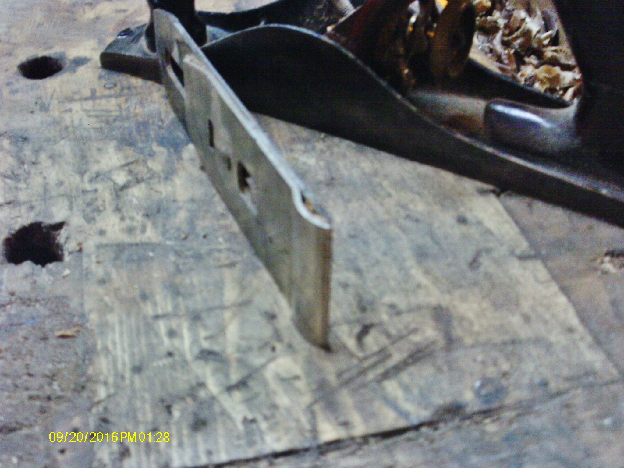

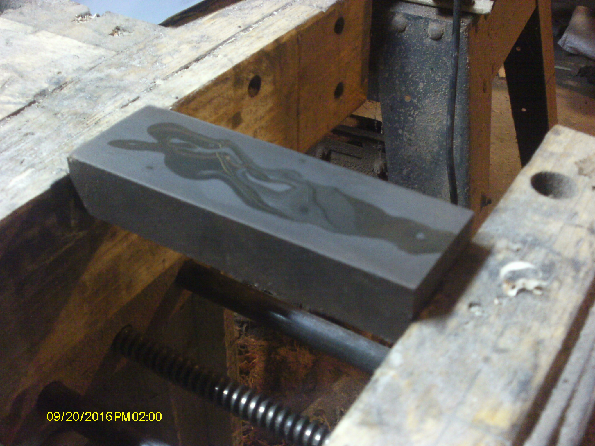

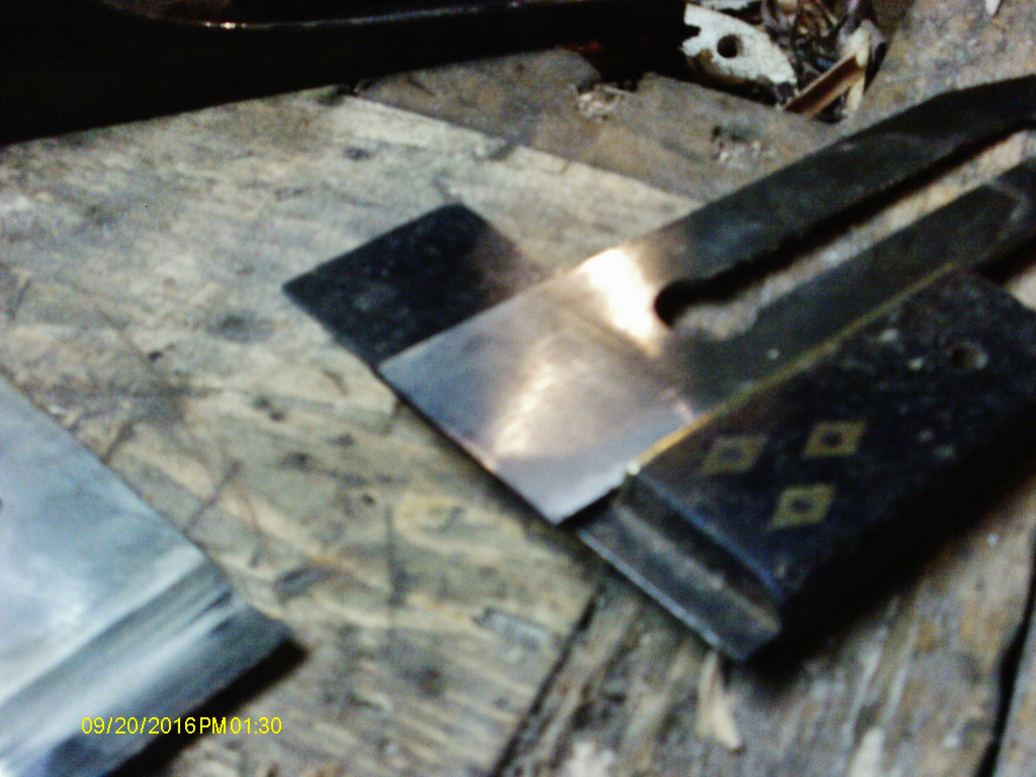

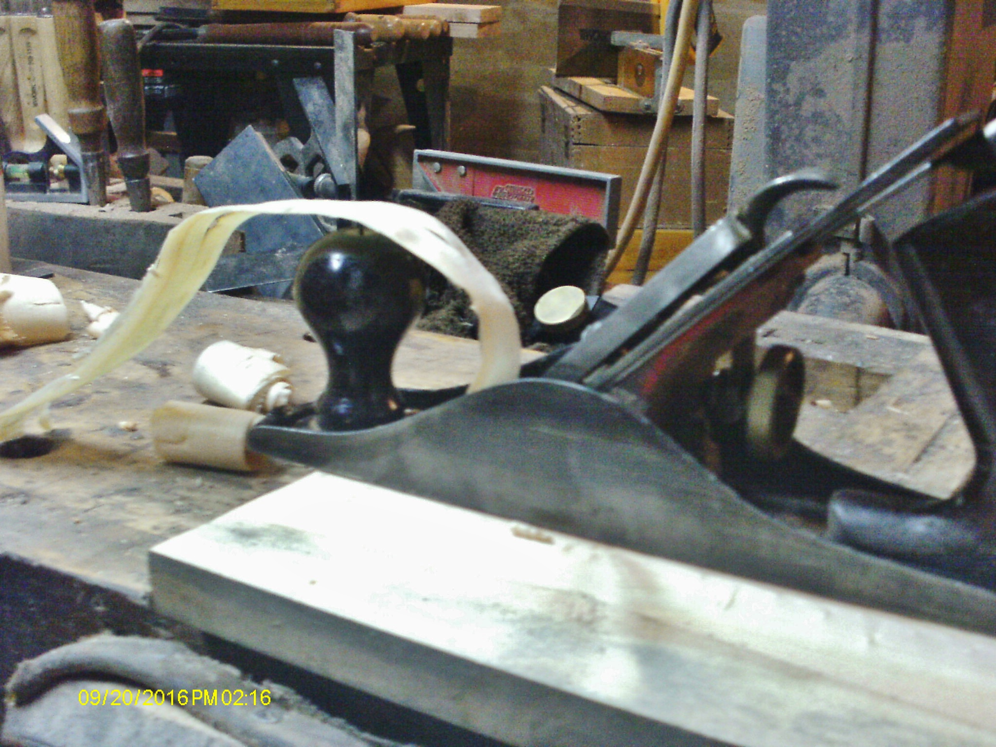

September 20, 201610 yr comment_75144 Trying to type this and eat supper ( my own cooking) at the same time....so, here goes. been having a bit of trouble with one of the planes.. As the lateral lever kept going to the side as I used the plane, just to get an even shaving... Leaning way to one side. Was having trouble with stuff getting jambed up, as well. Took the plane apart.. Look like a mismatch going on. Took things apart.. Back has a hollow to it. Chipbreaker has burrs.. Edge of the iron was a little out of square, too. Set up the first tool I use for this,, Have the platten set to about 25 degrees or so. I also had a big bowl of water handy Hollow grind a bit until the square was "happy".. I had cleaned up the parts with that wire cup on the drill press. I used the MK1 jig to set the bevel at 25 degrees. The sander? Well, I run it to sand out the hollow grind, and make sure the bevel is what I want. I can also flatten the back of the iron, Fingertips tell me when the steel is getting too hot, then a dunk into the water. Once the bevel looks even, I can put away the sander, time for one of these.. Squiggle of 3in1 oil. Stone is a 600 grit medium India stone. Iron is left in the honing guide. Moosh the iron around a while, until the grinder/sander marks are gone. Then onto these.. I found out that IF there is a layer of oil still on the stone, the sandpaper will "stick" there, and not move around. Went through the 1000 grit, and the 2000 grits. I spent as much time on the bevel as on the back. Getting both polished up.. The corners have a slight radius, to keep them from digging in. The leather sitting there is an old work belt, now serving time as a strop. Just bare leather, maybe a touch of oil. Time to put the plane back together, and do a test run.. Much better? The coils sitting there are called Moxxon TP. The lateral lever? A little more centered. I think this one is about ready to go back to work? Now, as for this old plane... That "boat hull" of a body has a big curve to it. Only the area around the mouth is in contact. I can push down either on the front end, or the stern. Sooo, next time, I will have to flatten this sole.. Yep, it is that ugly, even the camera didn't want to look at it. next time I get to the shop, a tune up will happen to this old Ohio Tool Co. 035 Razee.....yep, it do have a tapered iron... Edited September 20, 201610 yr by steven newman Report

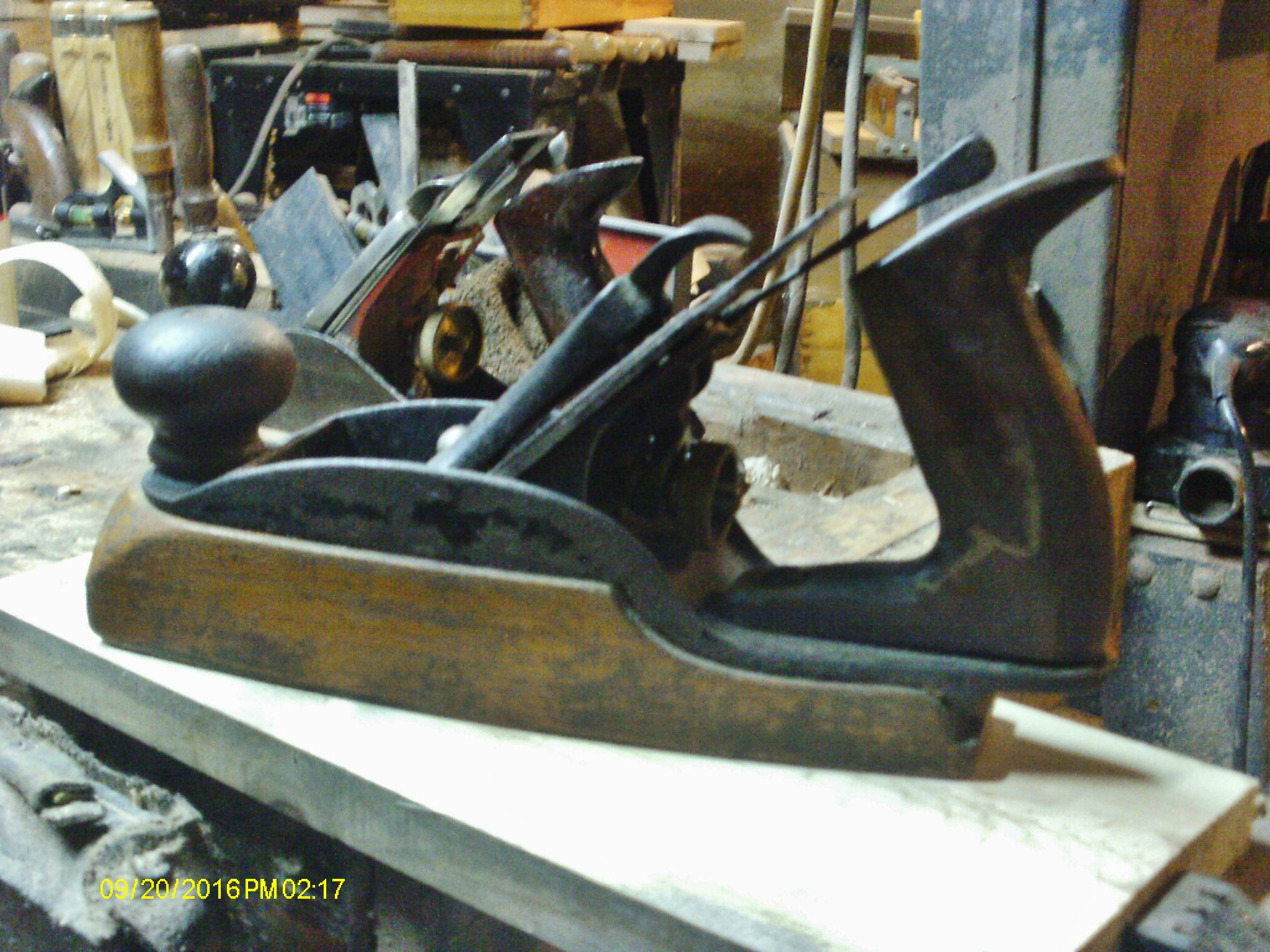

September 21, 201610 yr Author comment_75281 Need to find some fellow named Gumption.....too nice a day outside, to go hide in the Dungeon Shop.....yet, I still have that #035 Razee plane to work on....maybe a new thread for that type of plane? Report
