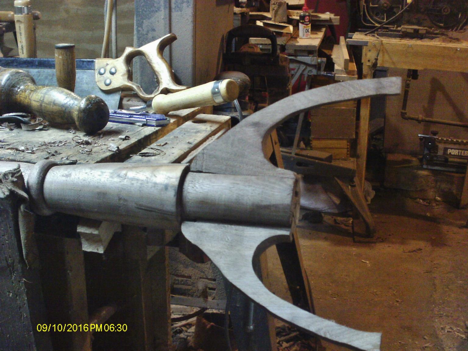

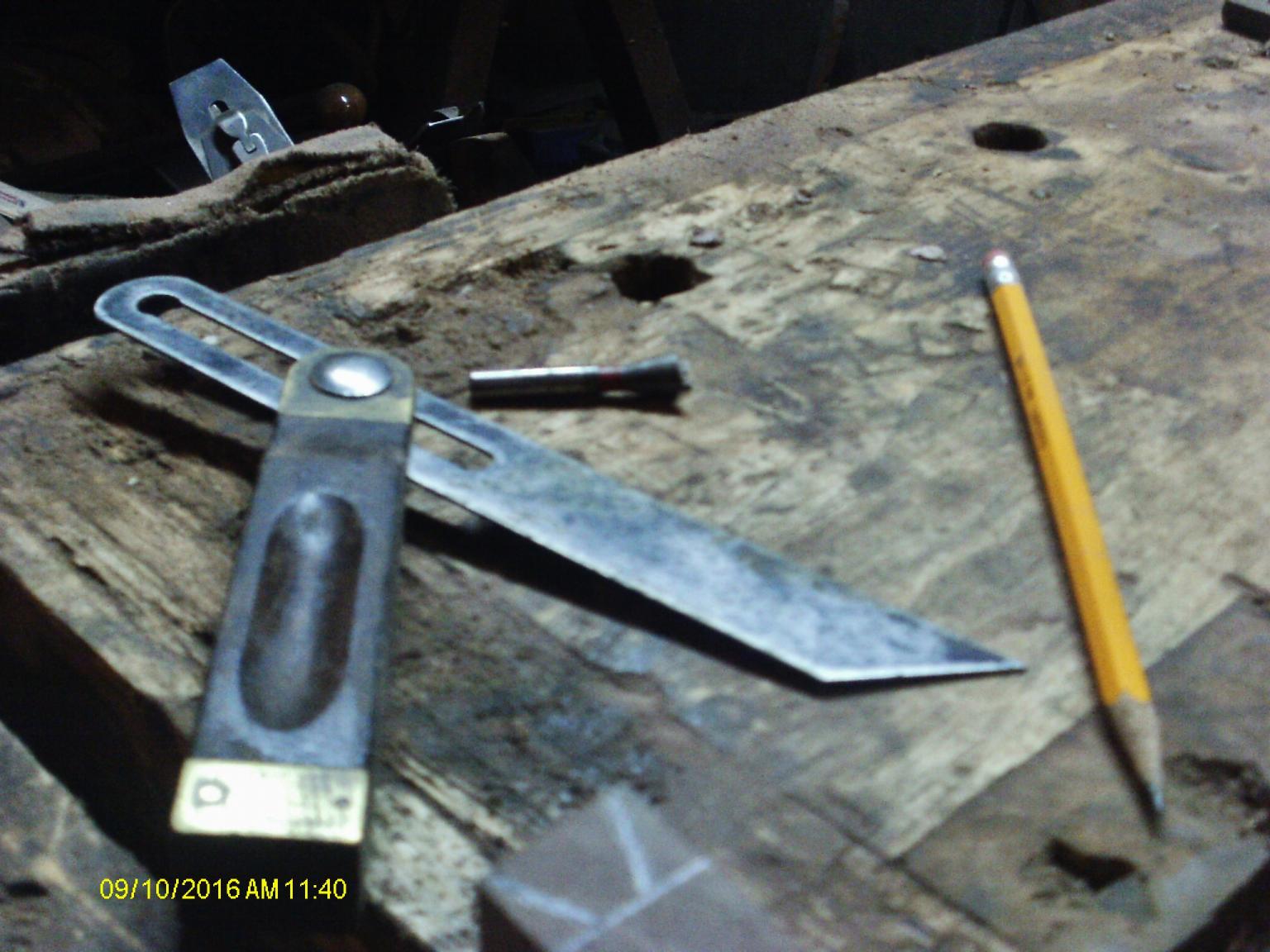

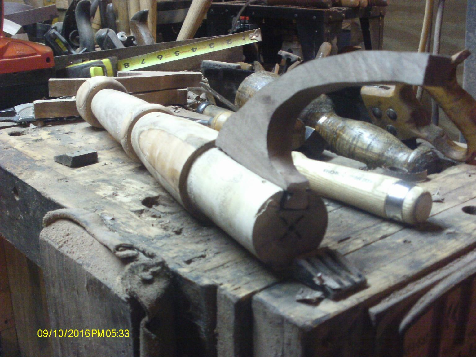

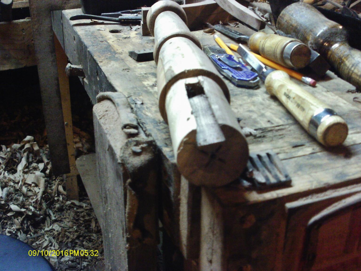

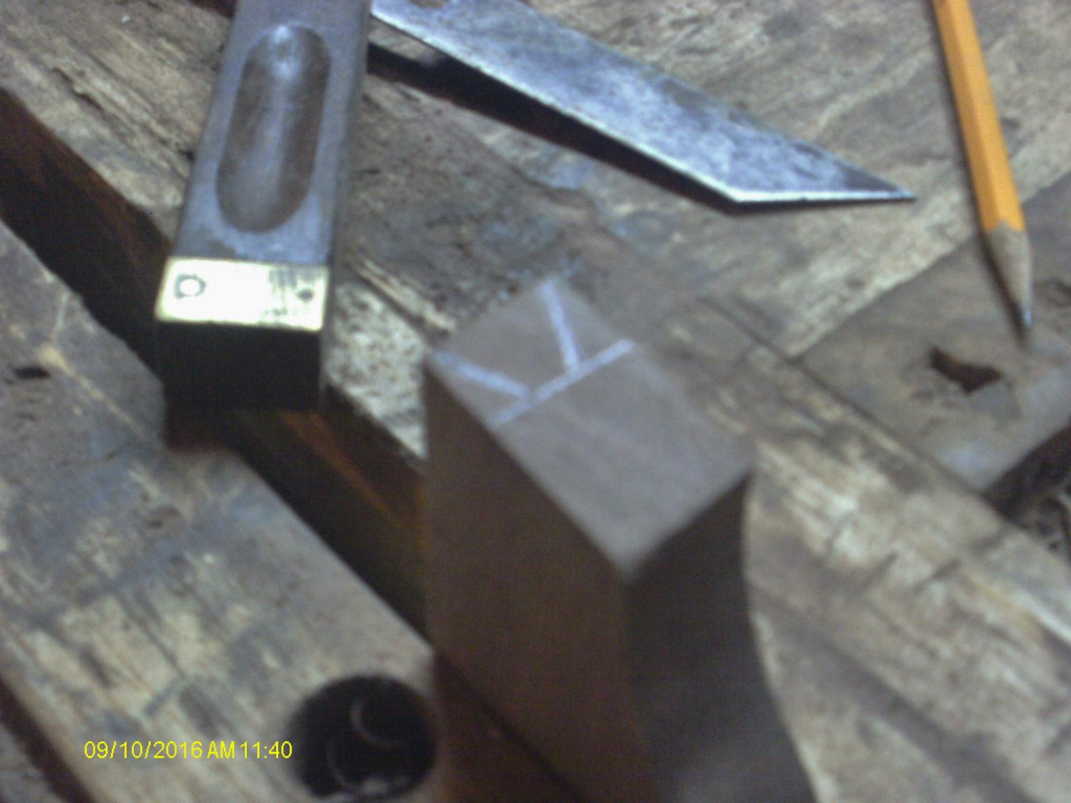

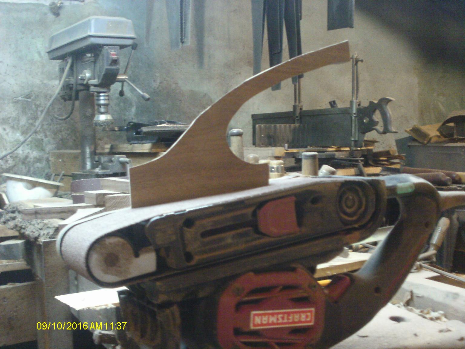

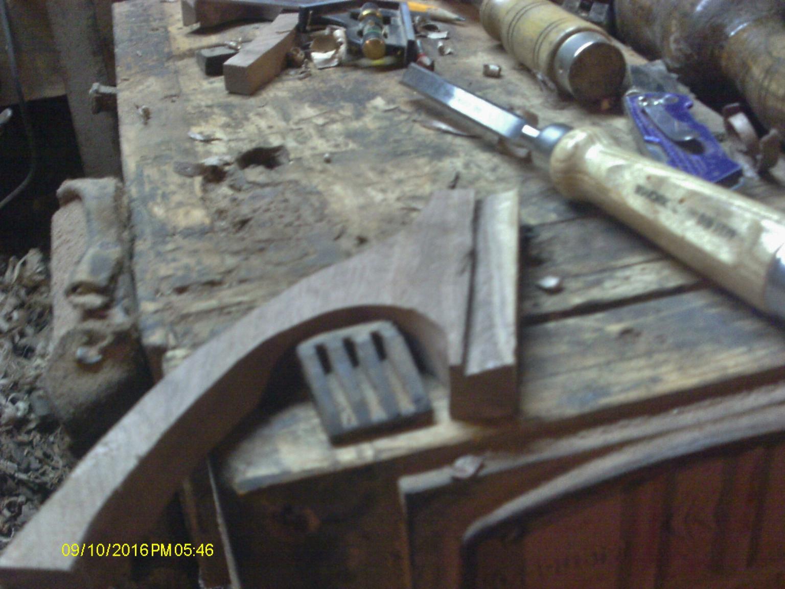

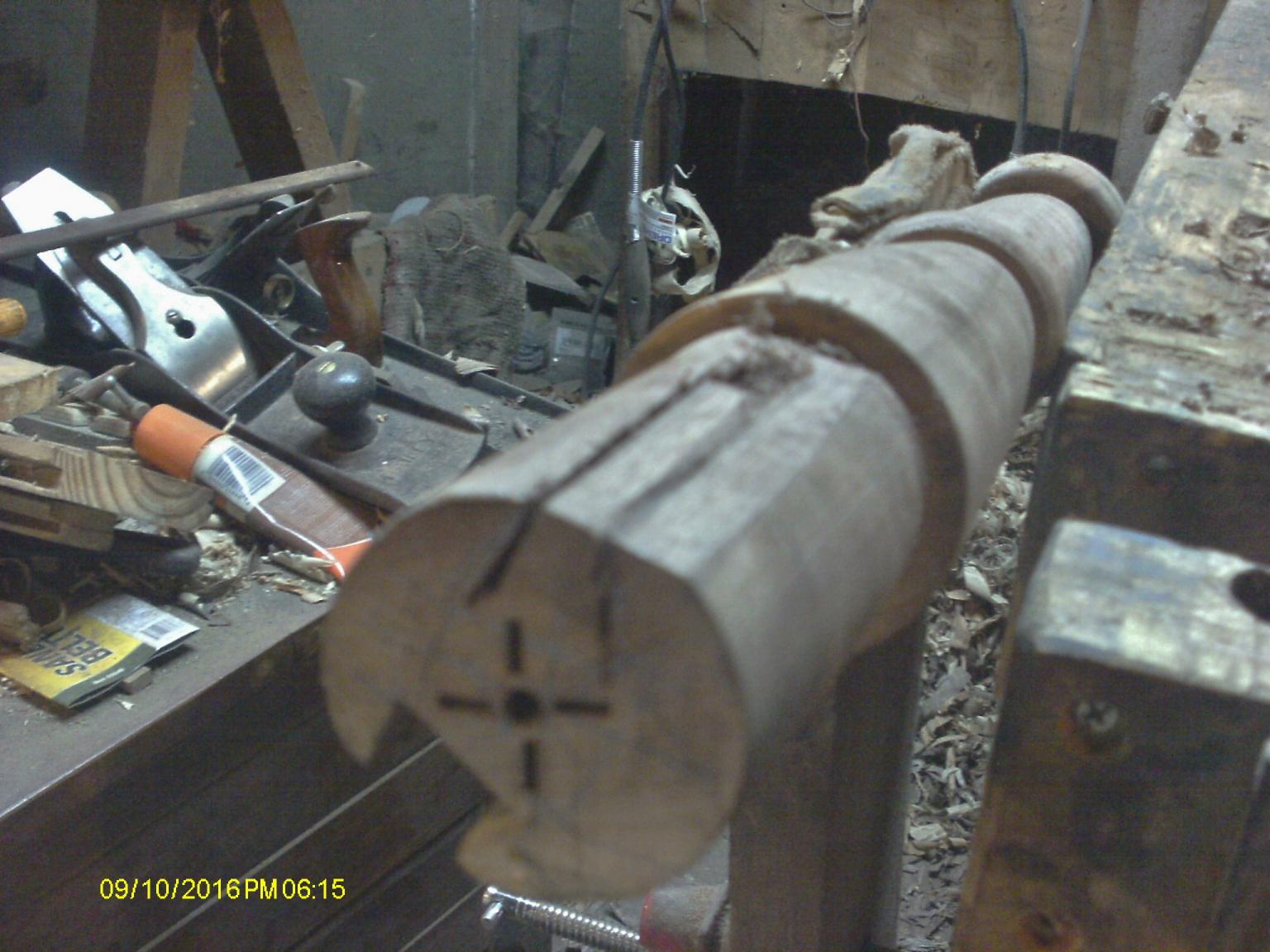

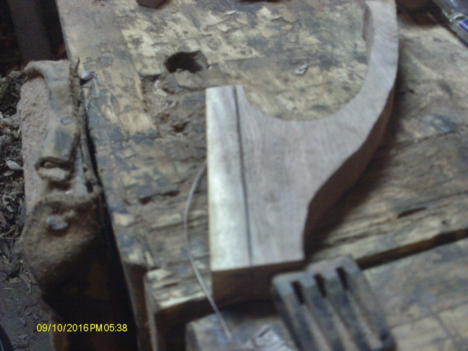

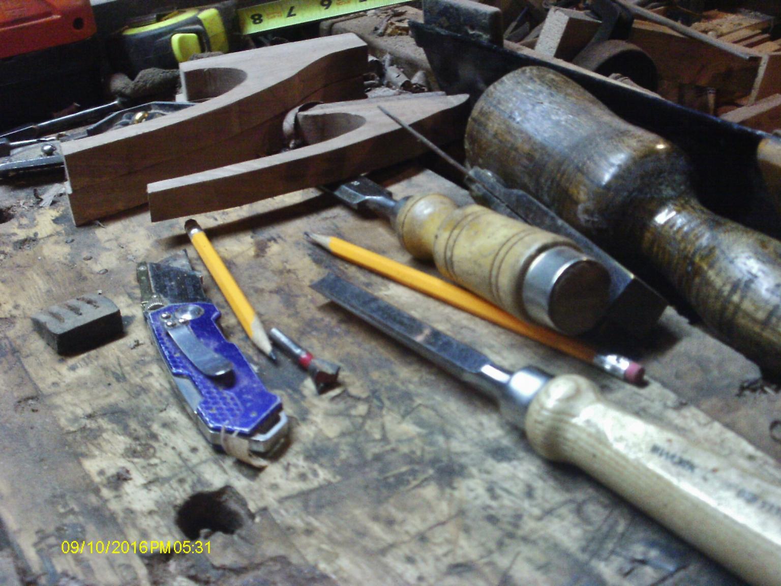

September 10, 20169 yr Worked for a little bit this morning, waiting on my helper to finally get up out of bed...Camera died, too. Took the van to my Mom's place, where we could work on it inside, out of the thunderstorms.....Tasks? Front and rear brake pads needed changed, tires rotated. After all of that, then come home and do a bit more wood work... That front wheel is a perfect fit. Legs are now all the same thickness, saw marks are gone, curves look better... Layout tools to mark a dovetail.... Carried a few lines done the sides, gathered a few other tools Knifeline cutter, chisels, chisel pusher....somewhere there is a #4 backsaw. Backsaw the line. Down to the other line.. Chisel away the waste. Repeat for the other side. Use this to lay out a spot on the leg Just a matter of saw the sides, and chisel out the waste. checking for fit.. Not too hateful.....repeat all those steps again for the next leg. Sometimes, things get a bit squirrelly.. Needed to add a couple pieces to help hold this thing sting. You can see the saw lines, and where I dug out an escape hole. More chop and fit, test fit, and chop some more. I also planed a "flat" where the legs will go. Finally got #2 to fit.. two down, one to go. Maybe tomorrow I can get the third one fitted? I also cut out a slat, for attaching the column to the top.. It might be a pattern for a better one, later. Right now/ I am plain tuckered out. I intend to just sit here on my foundation and have a tall glass of ice and lemonade....stay tuned..

September 11, 20169 yr Program timer is set for next episode. Rest the knees after the brake job...thought I would have to crawl to the house Monday after doing the same on my daughter's van. Enjoy the lemonade...give it some kick and add sweet tea to it! Edit add: BTW, was that a dovetail router bit I saw on the bench? Edited September 11, 20169 yr by Grandpadave52
September 11, 20169 yr Author Yep, use it as a pattern for when I cut dovetailed stuff. Sets the angle to the dangle for me.. If'n I want a bit of a kick to the lemonade, the water would be replaced with Beefeaters Gin... Edited September 11, 20169 yr by steven newman
September 11, 20169 yr 13 minutes ago, steven newman said: Yep, use it as a pattern for when I cut dovetailed stuff. Sets the angle to the dangle for me.. If'n I want a bit of a kick to the lemonade, the water would be replaced with Beefeaters Gin... ...you'd forget about the knee for awhile!!
