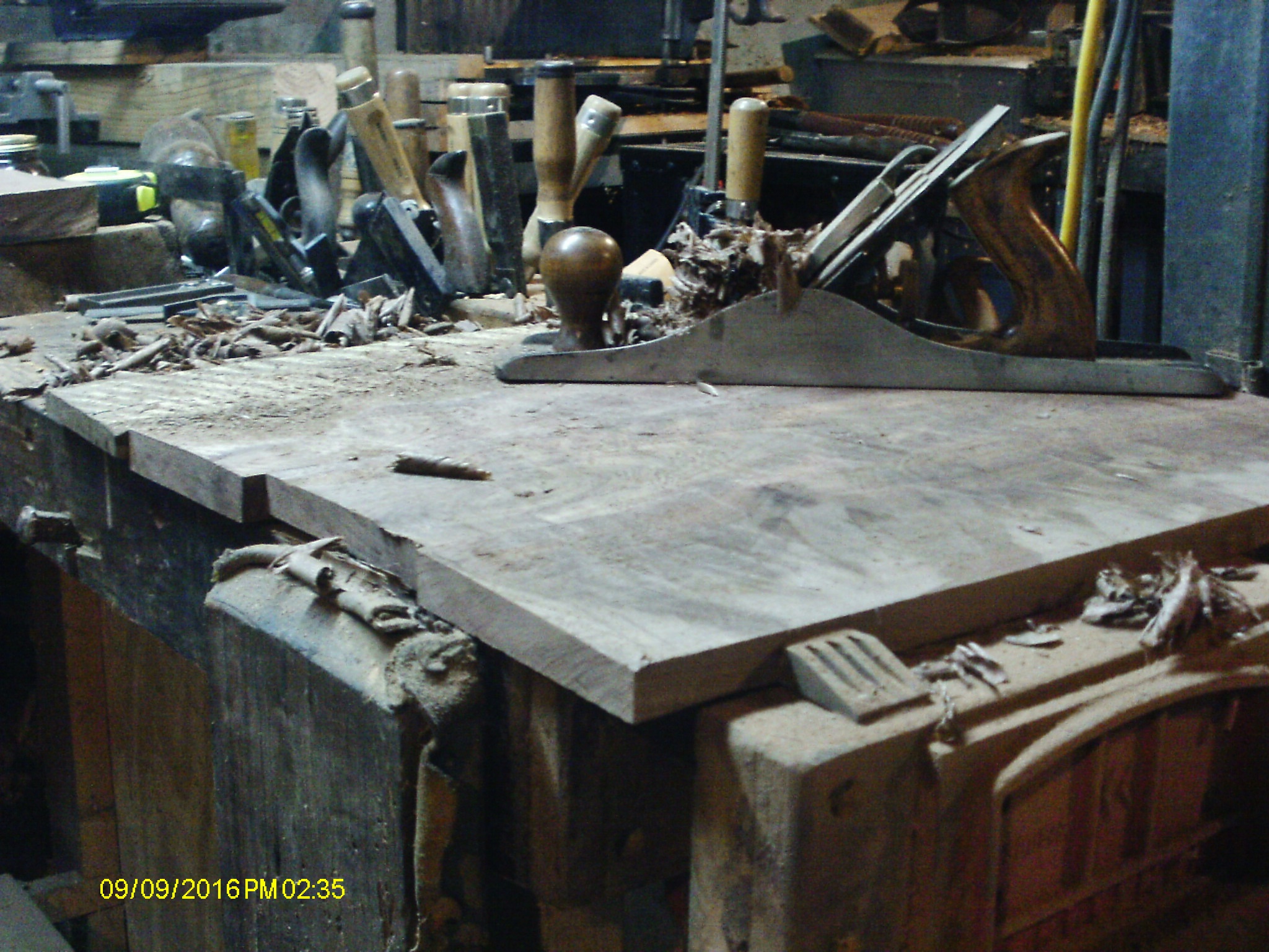

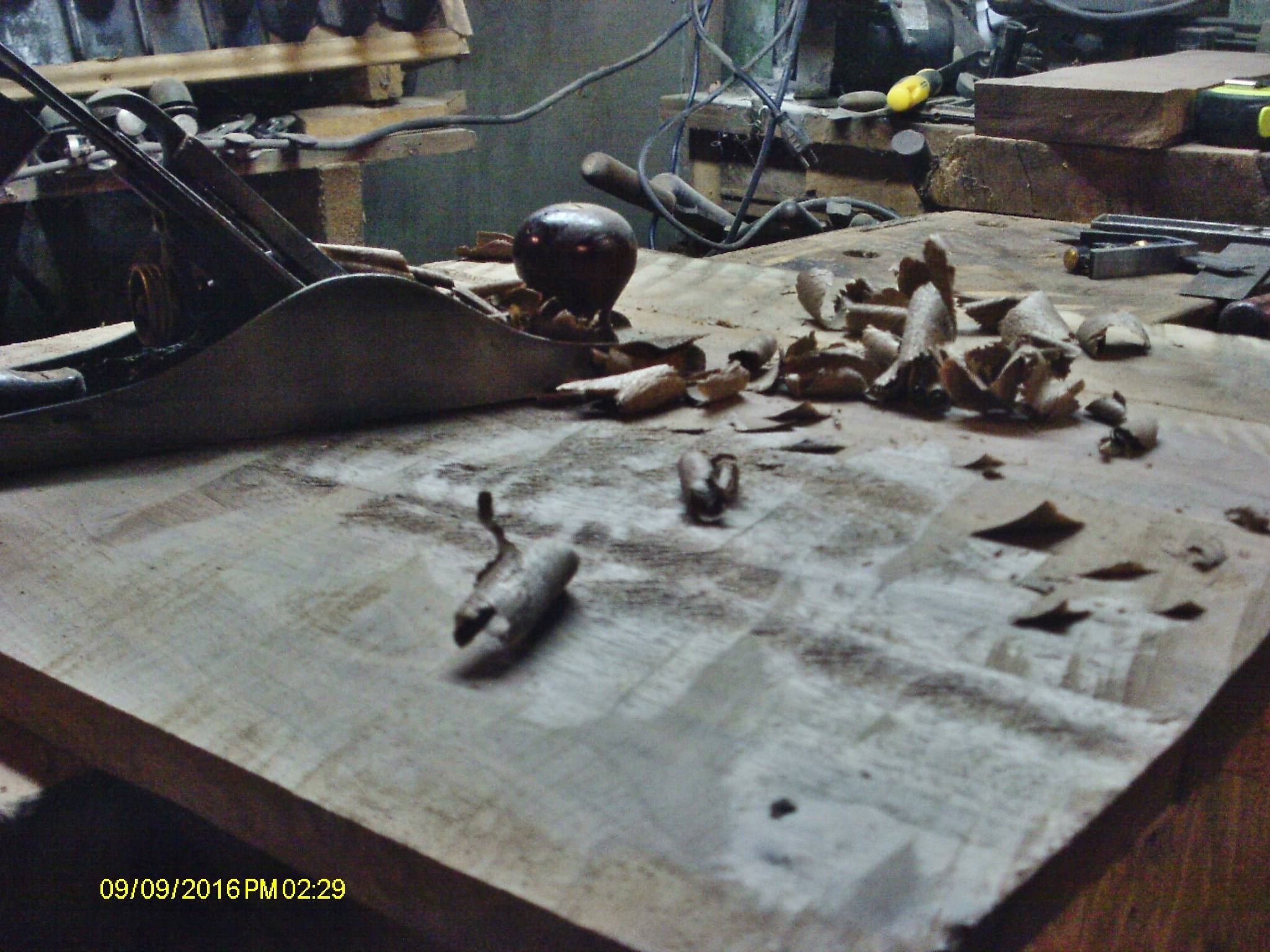

Anyway, today task was mainly to get a top almost done.  Cambered Jack plane to level the playing fields..
Followed by a slightly larger plane

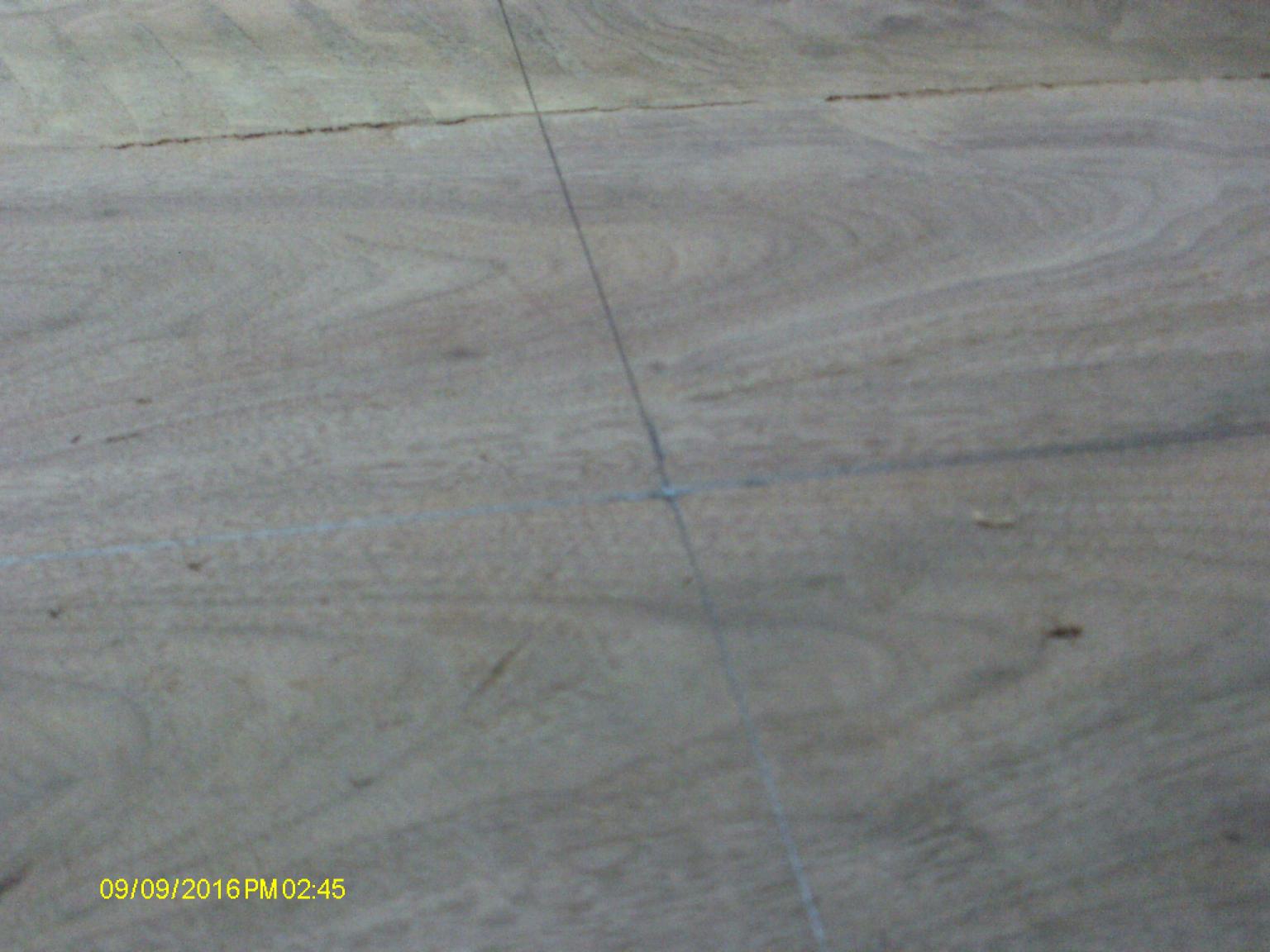

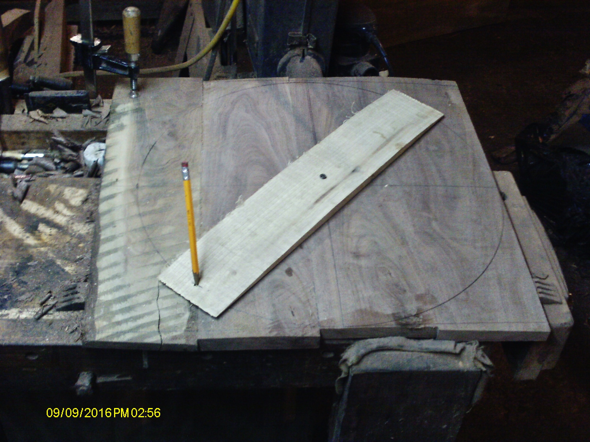

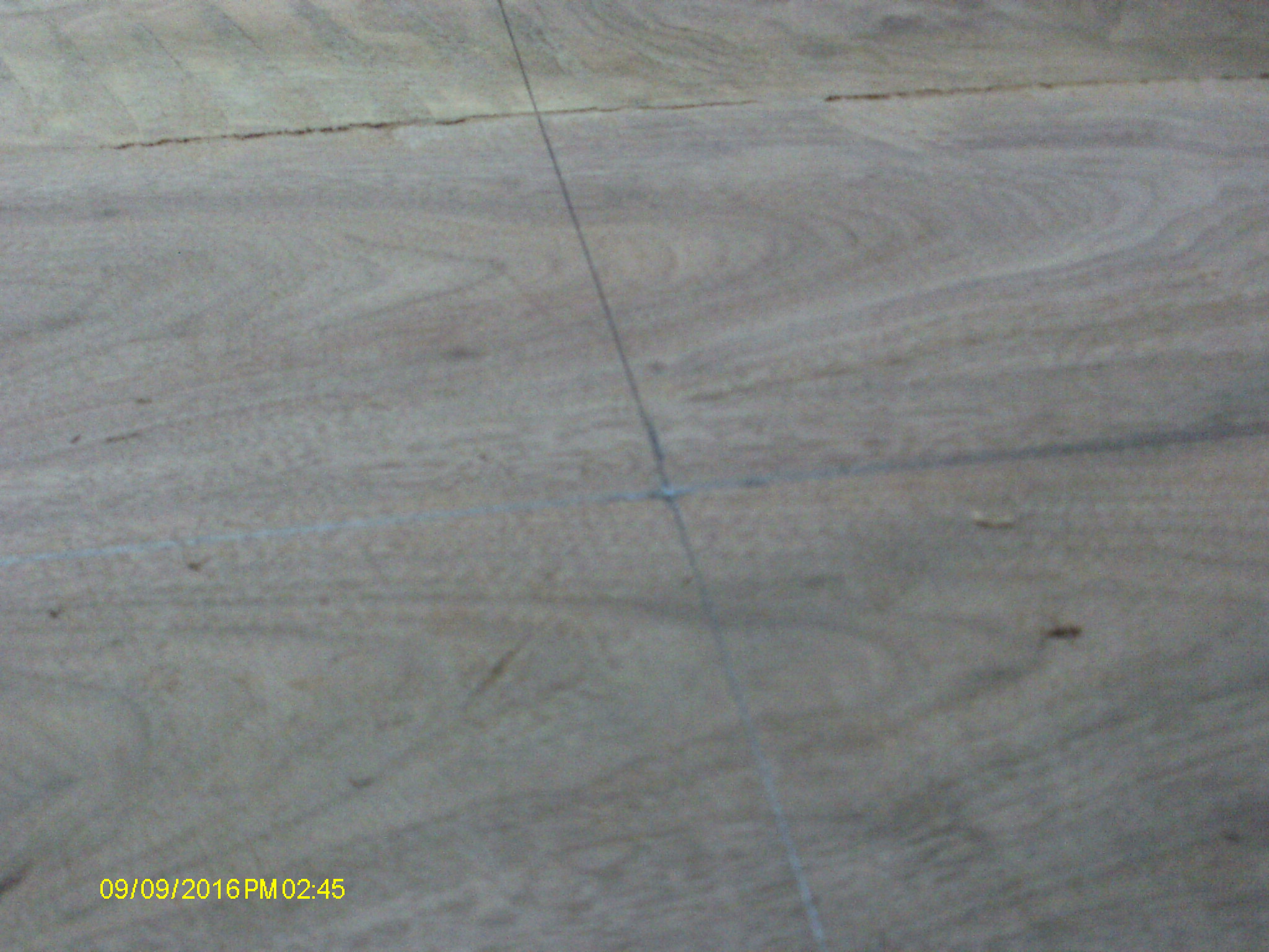

Once the place was flat, time to make a jig.   First I needed a center point..
And, as for the jig?

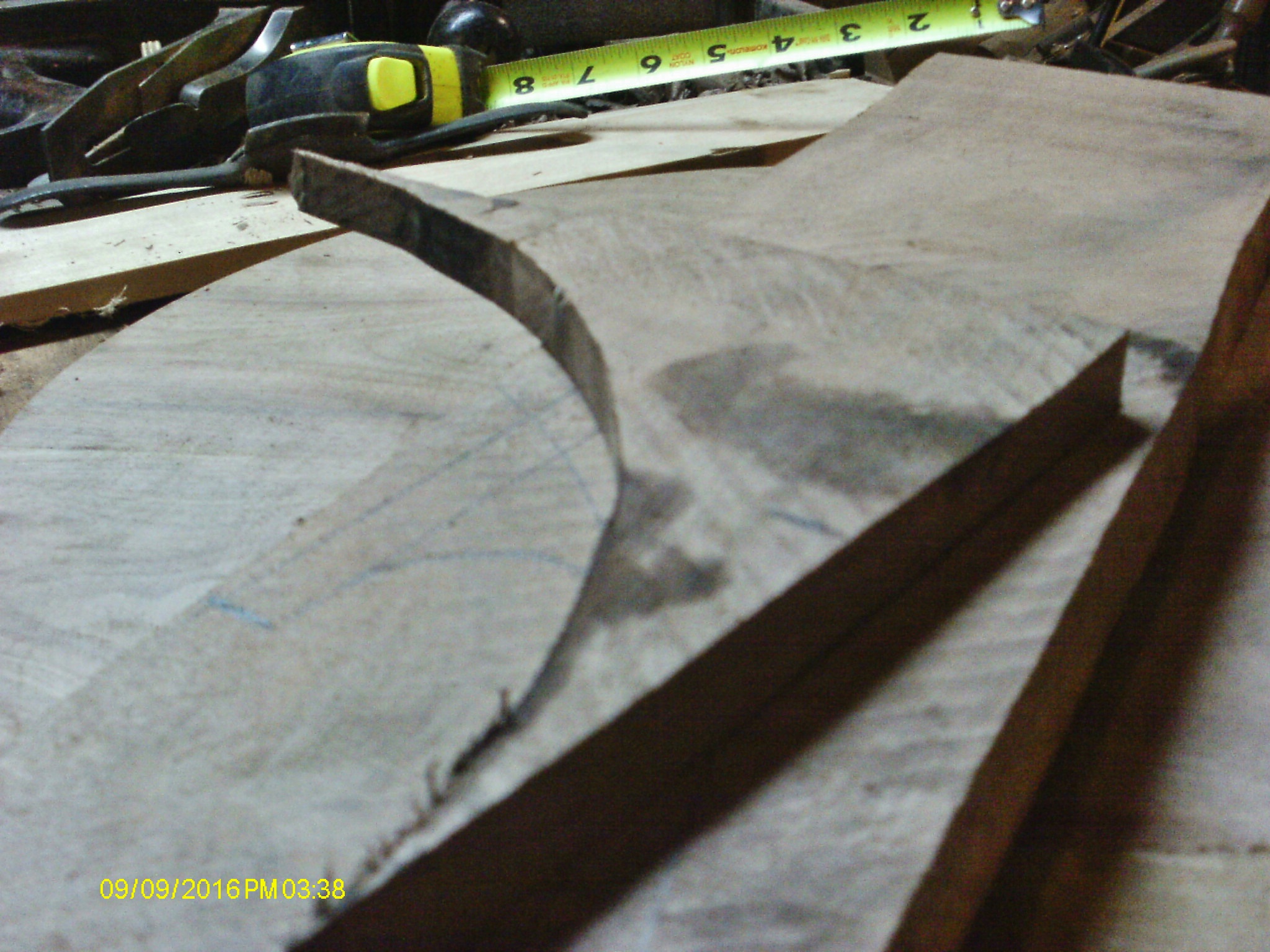

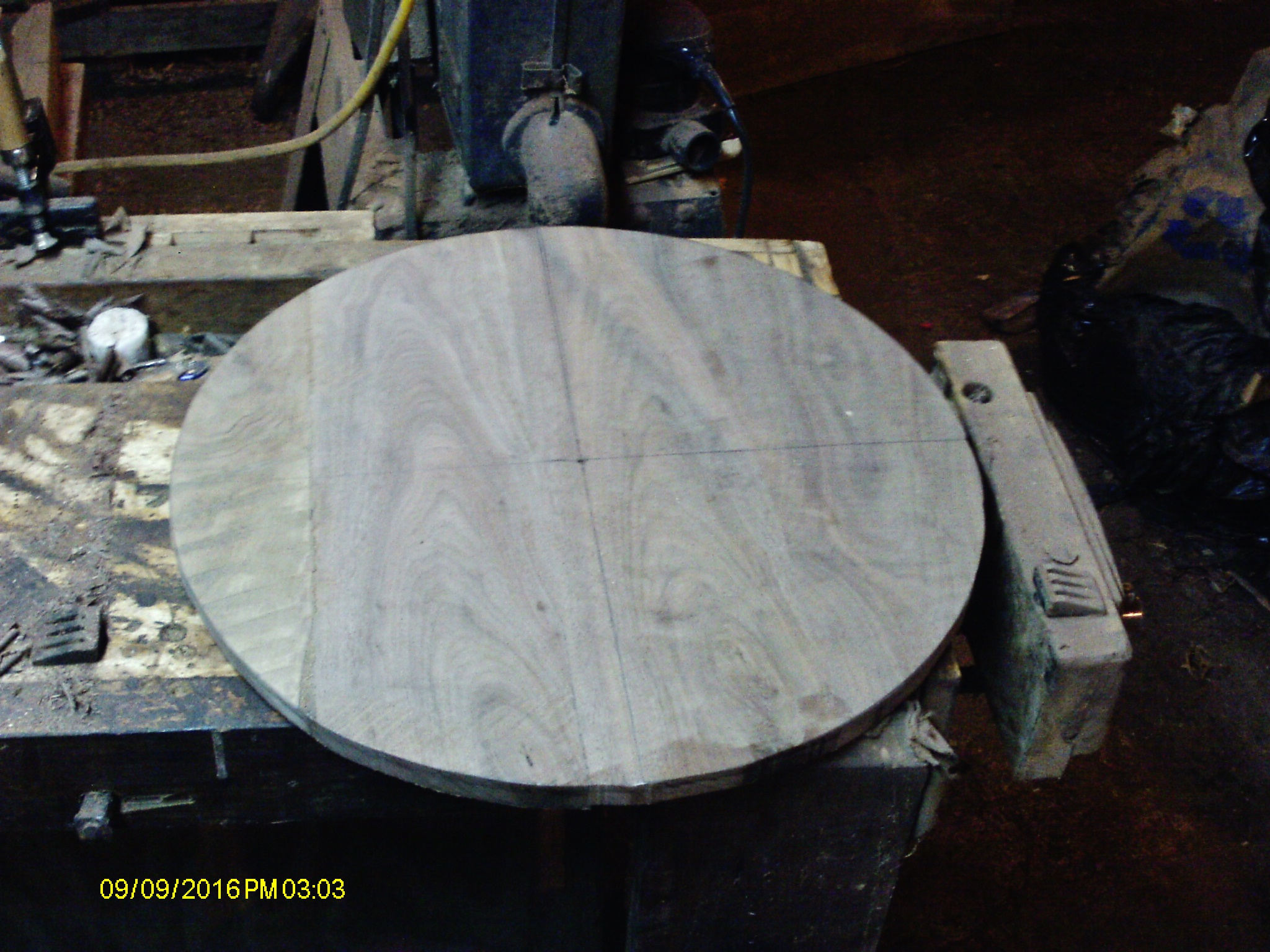

Just a scrap of wood, a screw in the middle, set in the center of the panel.  Another hole is 9" away, for a pencil to mark a circle.   Not enough room here to build Norm's circle cutting jig...I had to free hand it on the bandsaw. Trying to leave the lines, at least...

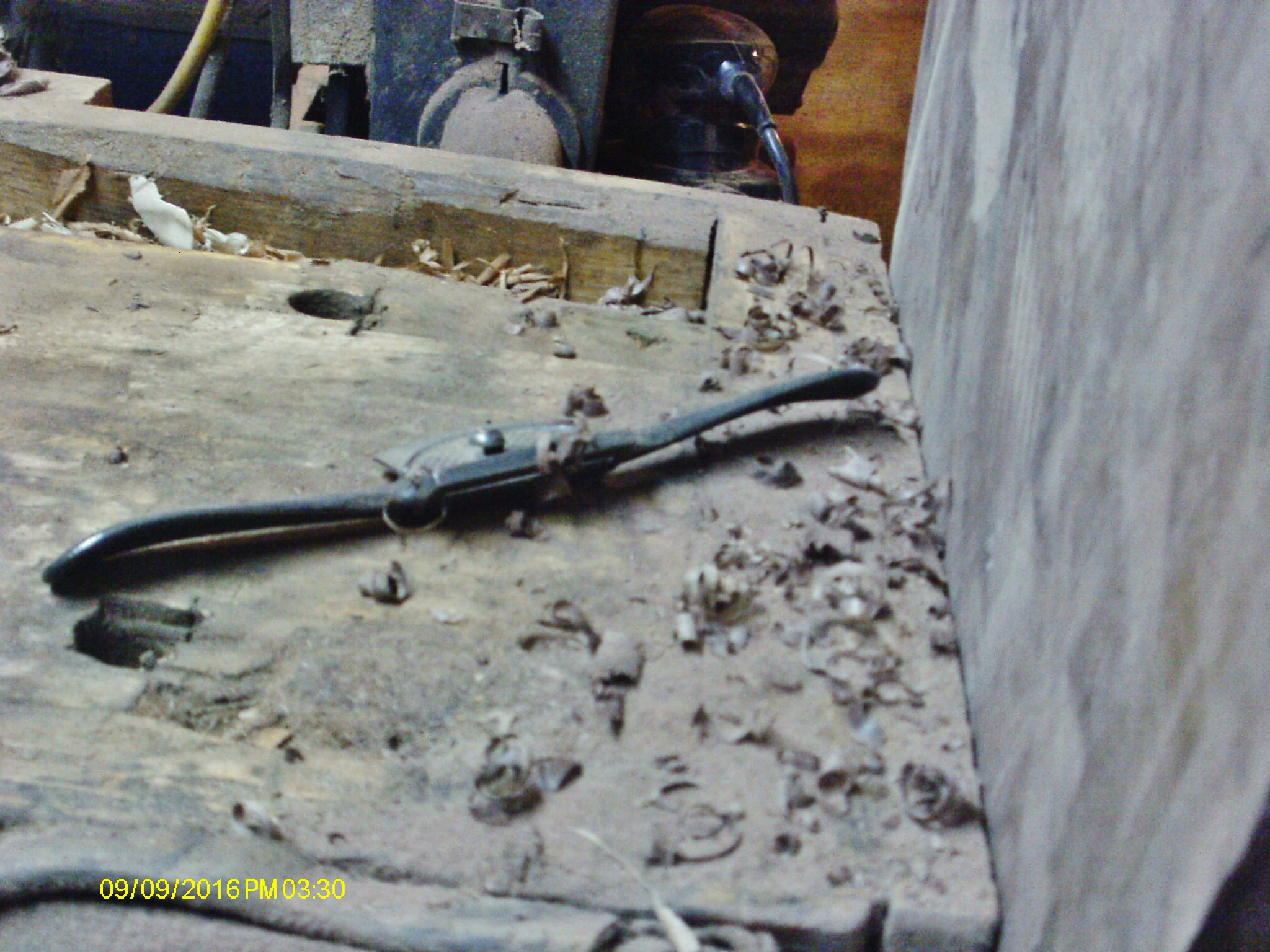

Well, it is close. anyway...beltsander, palmsander to smooth the curves a bit.  Then time for this to take over

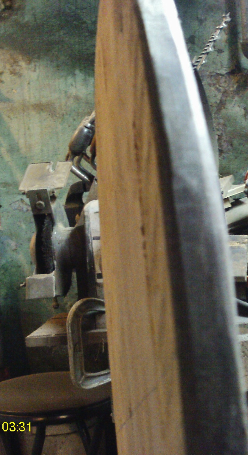

a spokeshave?   worked the the edge down to something I liked..

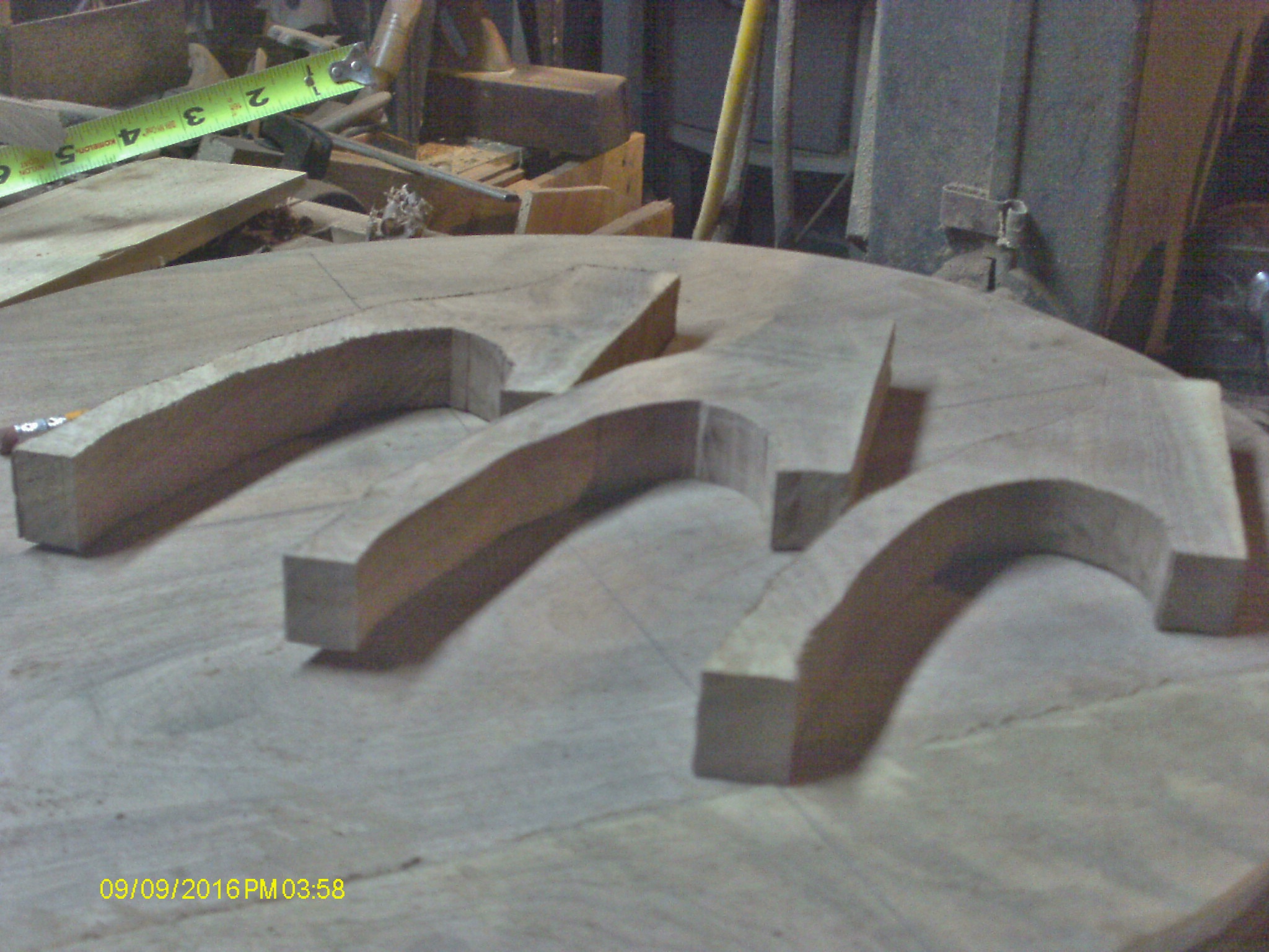

Tried to also round the edges a bit, too.   I don't like to throw away scraps, as they can be handy to have around...this time it was one of the cut-offs from the circle cutting..
This could give a little help, drawing out some legs?   A few adjustments, here and there, had to allow for a dovetail as well......Resawed a blank down to a bit thinner section, and got these critters..
Leg blanks?   Something like this?

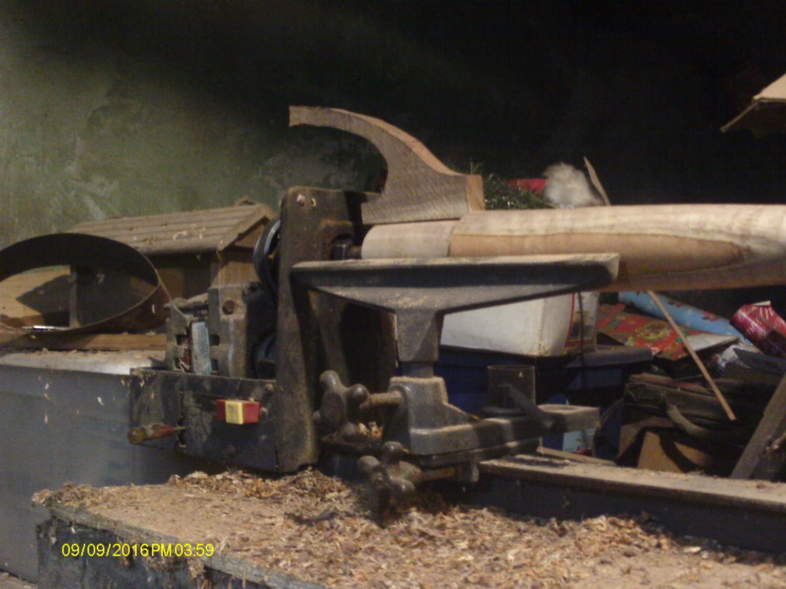

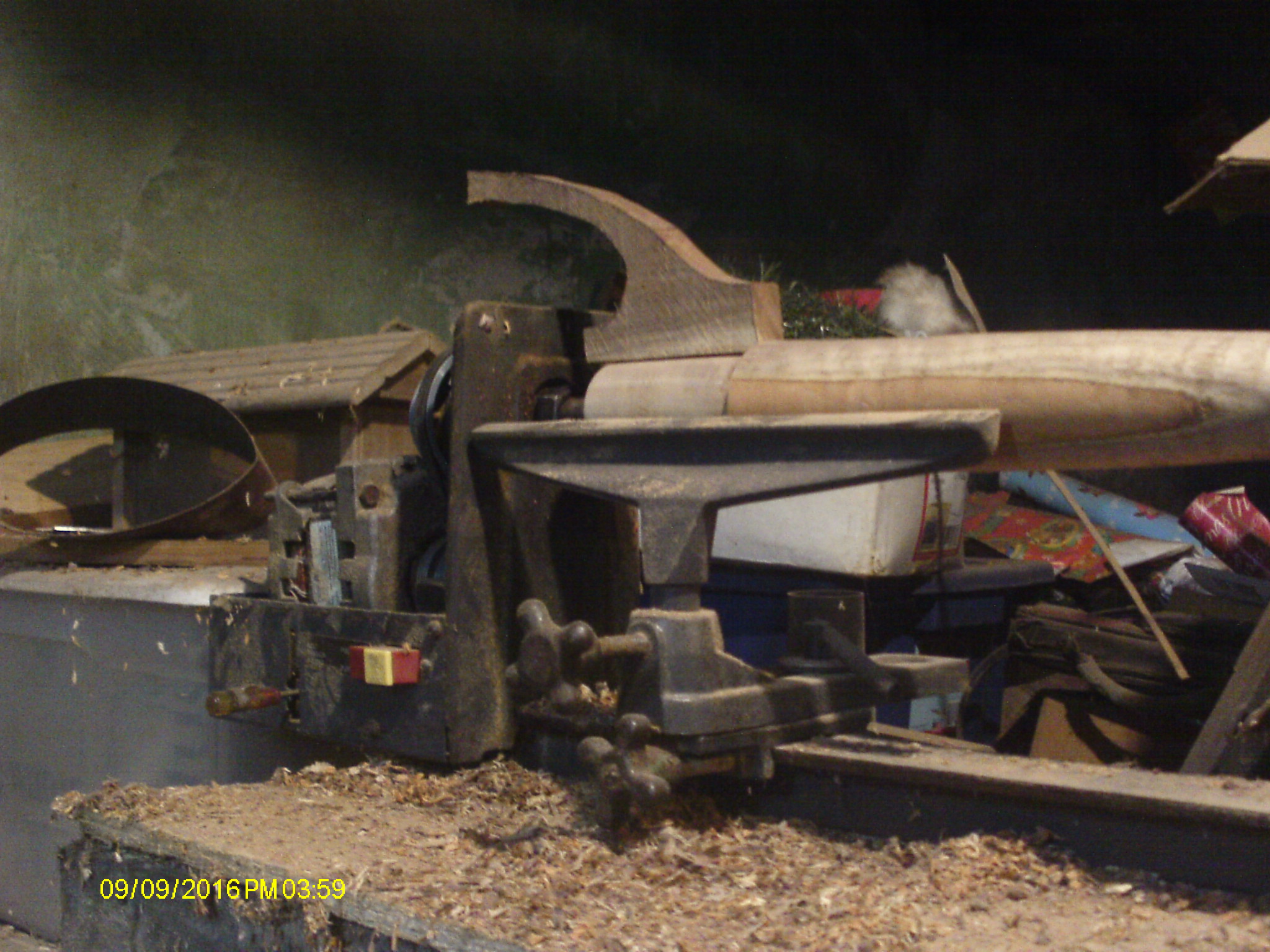

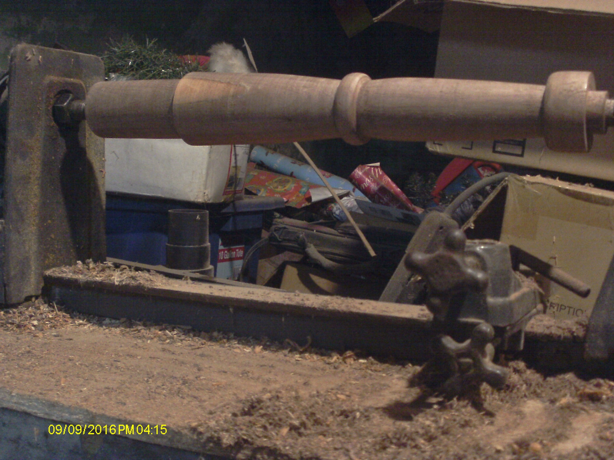

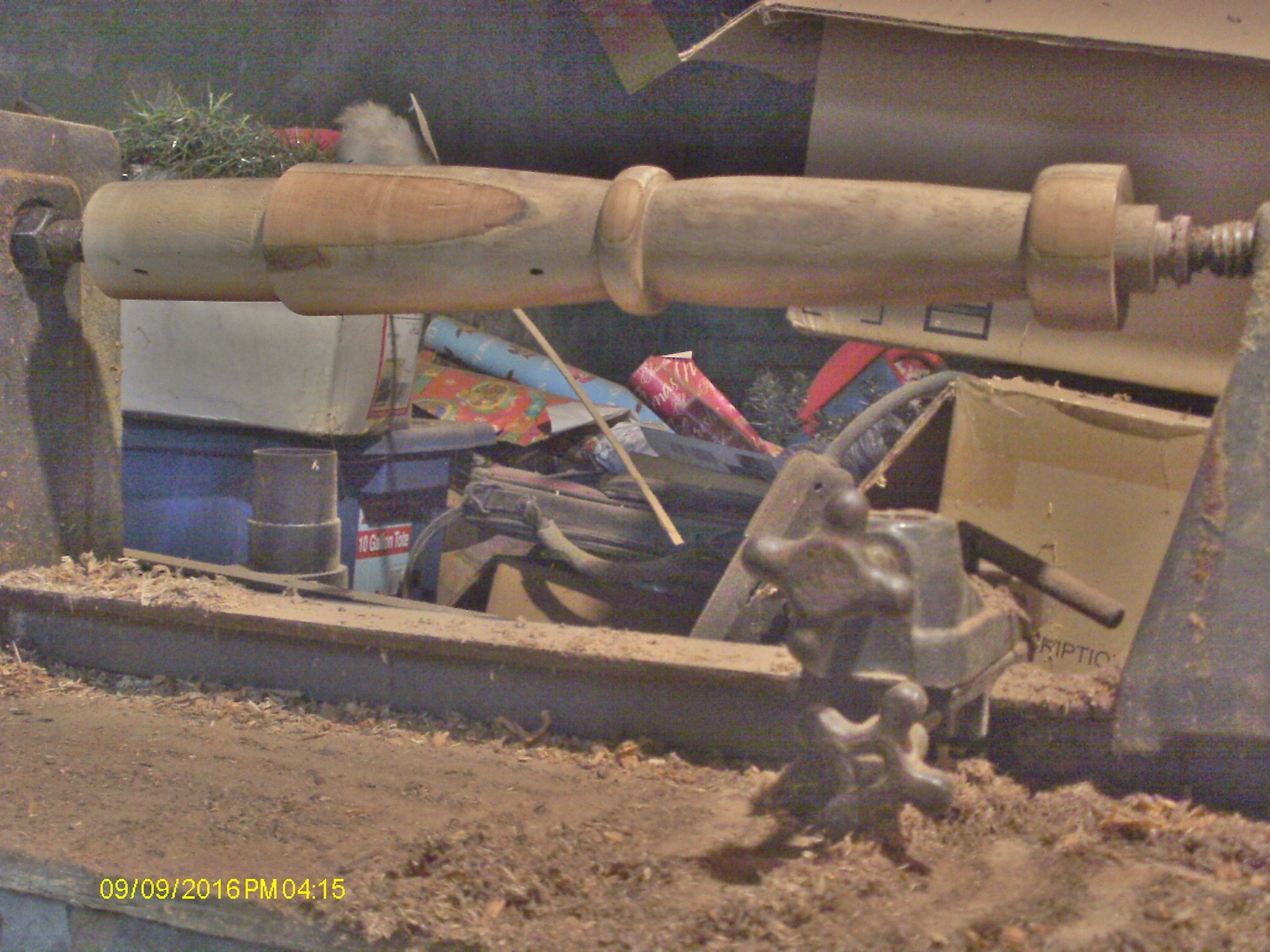

Well..it is a start, anyway.   As for that column thingy.......needed a break from sweating over a hot ..bench, so..
The "Fancy Side".  Final shaping, and sanding.   The "plain side?

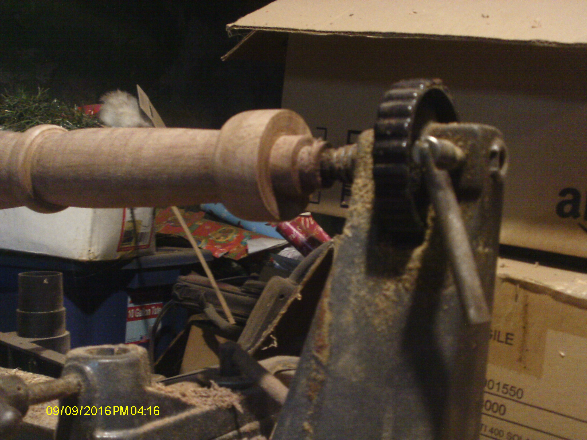

I also thinned down the collar and the tenon.    Note there is a bead in the middle of the column now...
Have this almost parted off, before I remembered sanding.....I also rubbed a stick of Cherry along the spinning blank, for a bit of shine.
