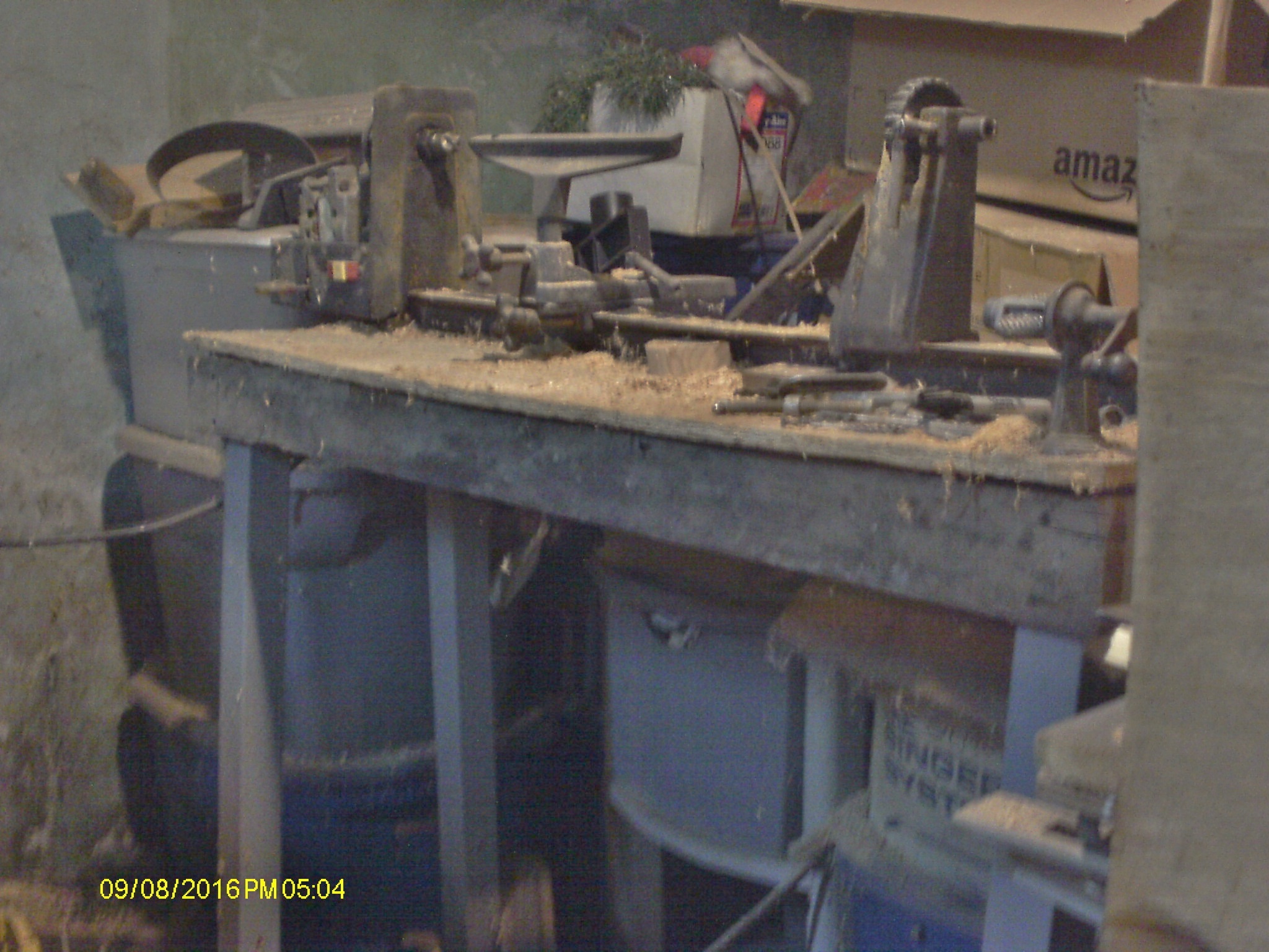

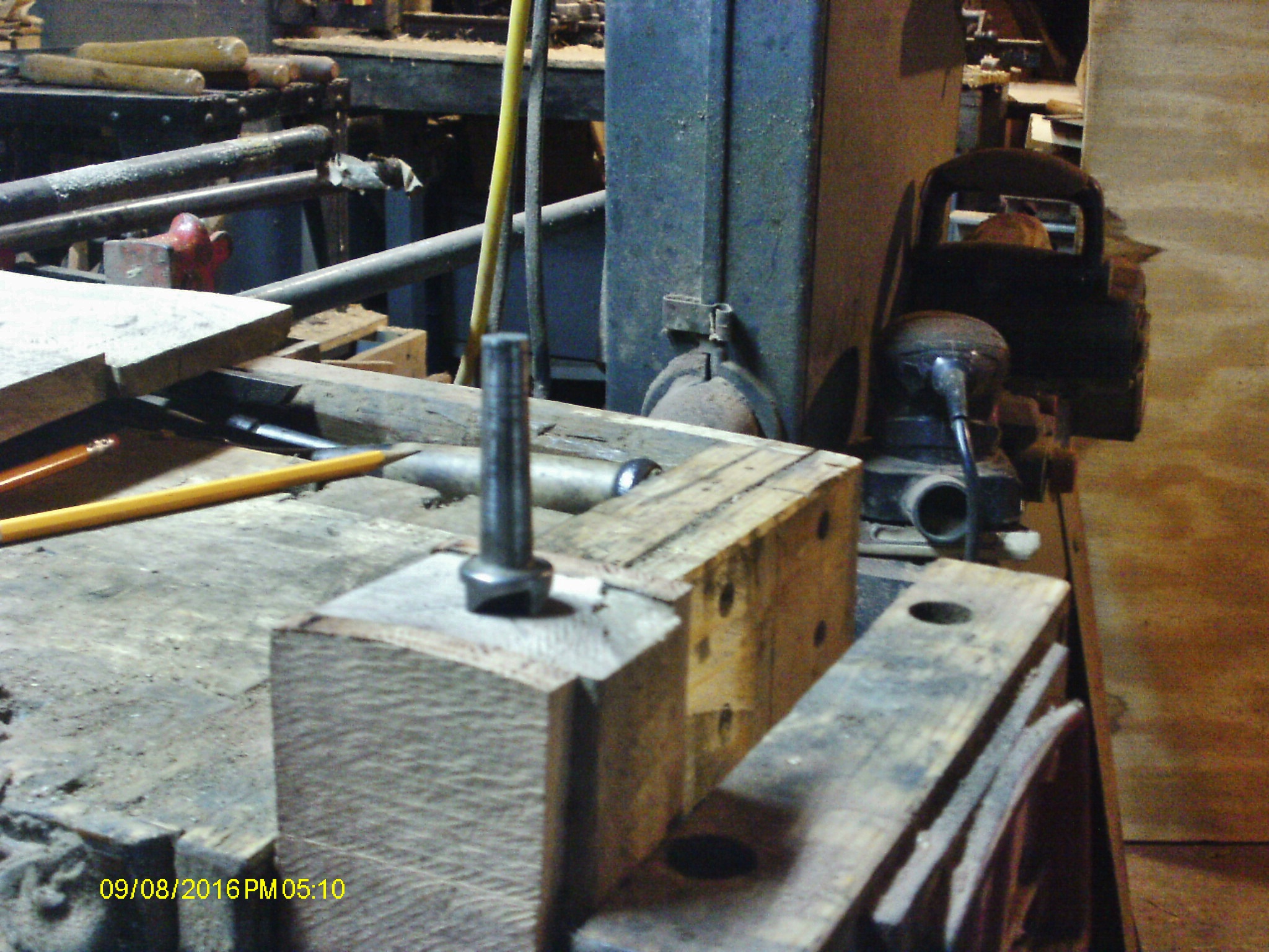

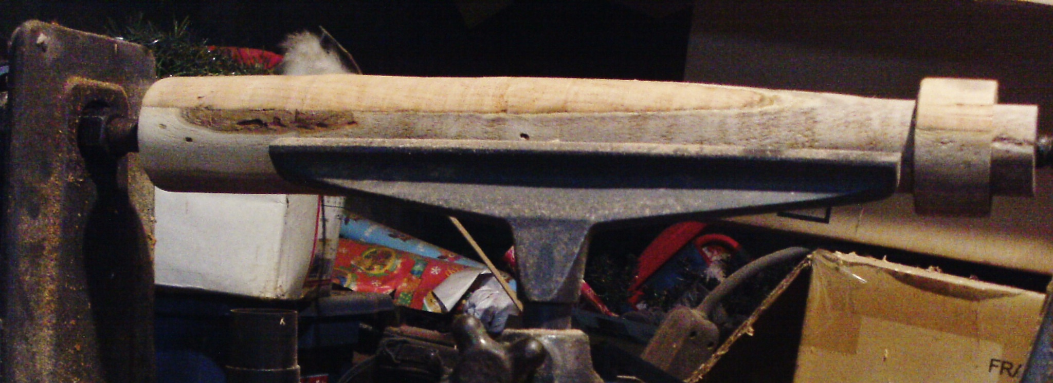

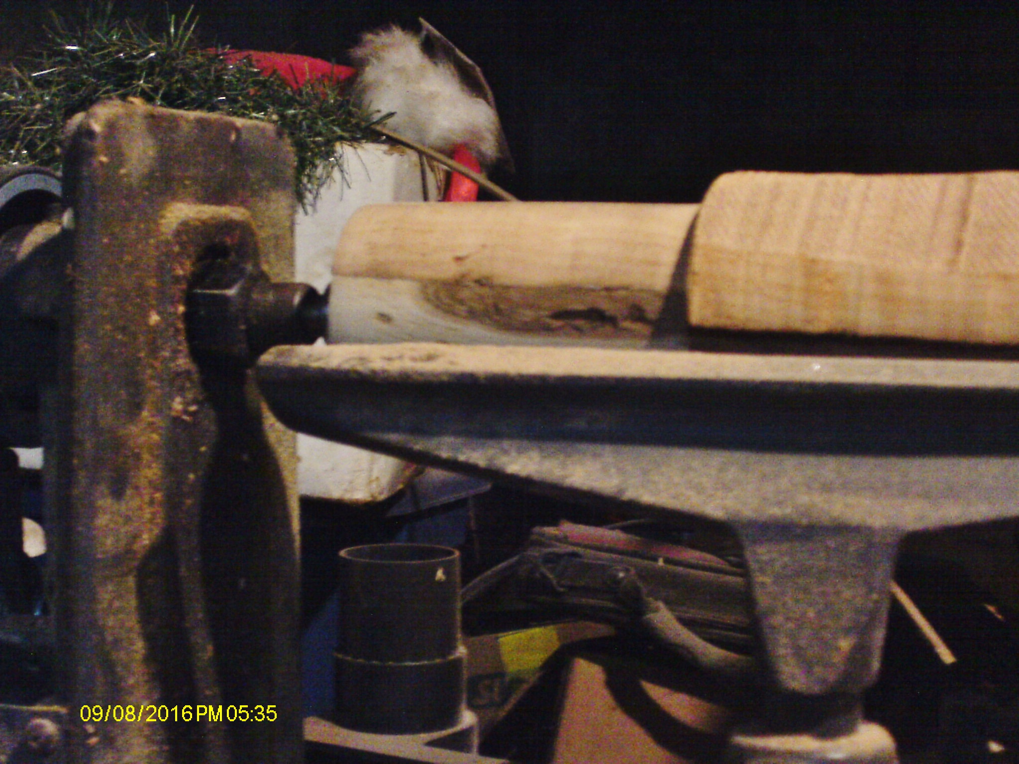

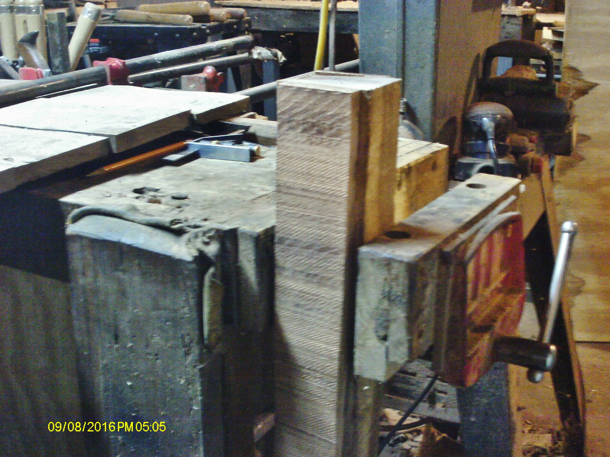

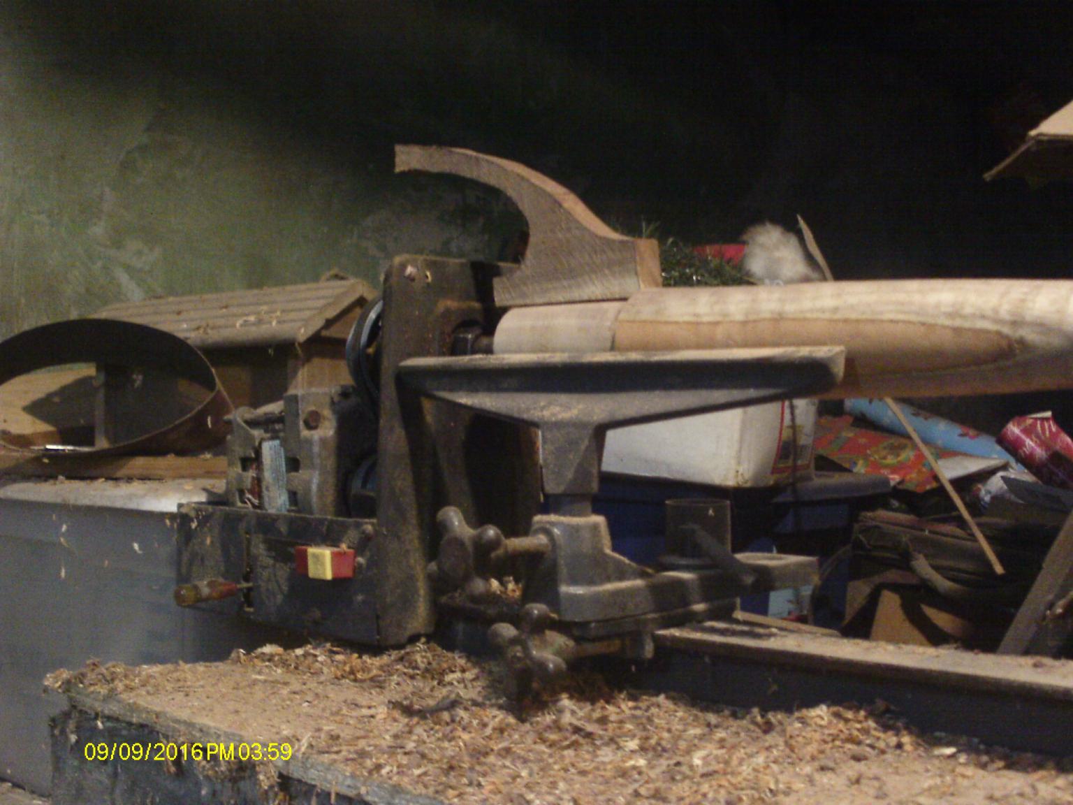

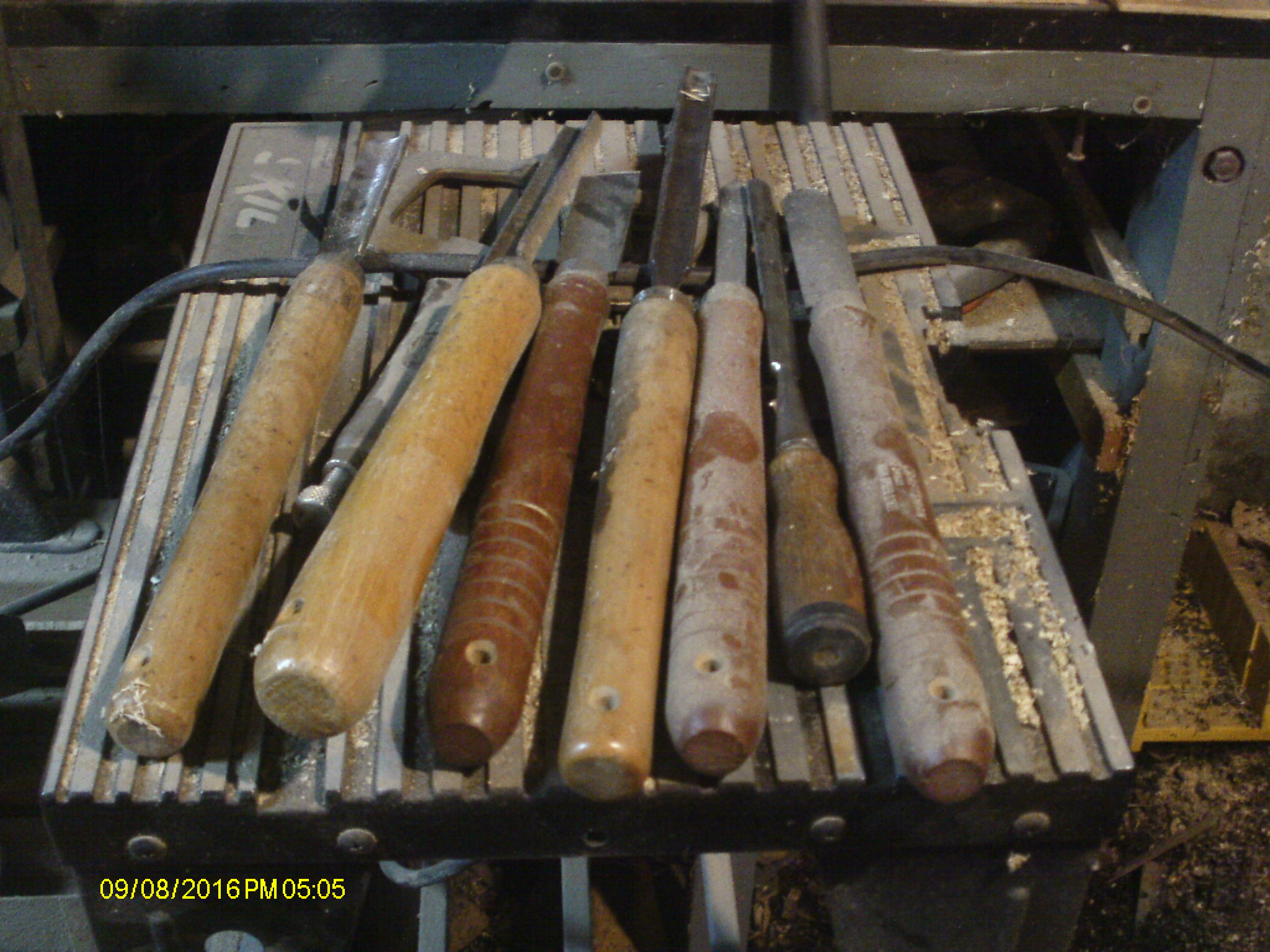

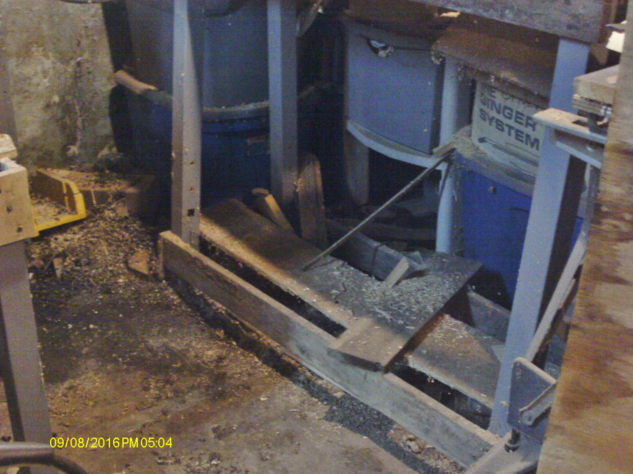

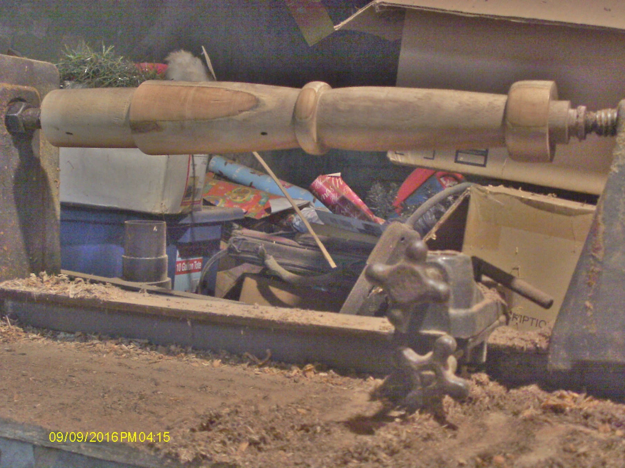

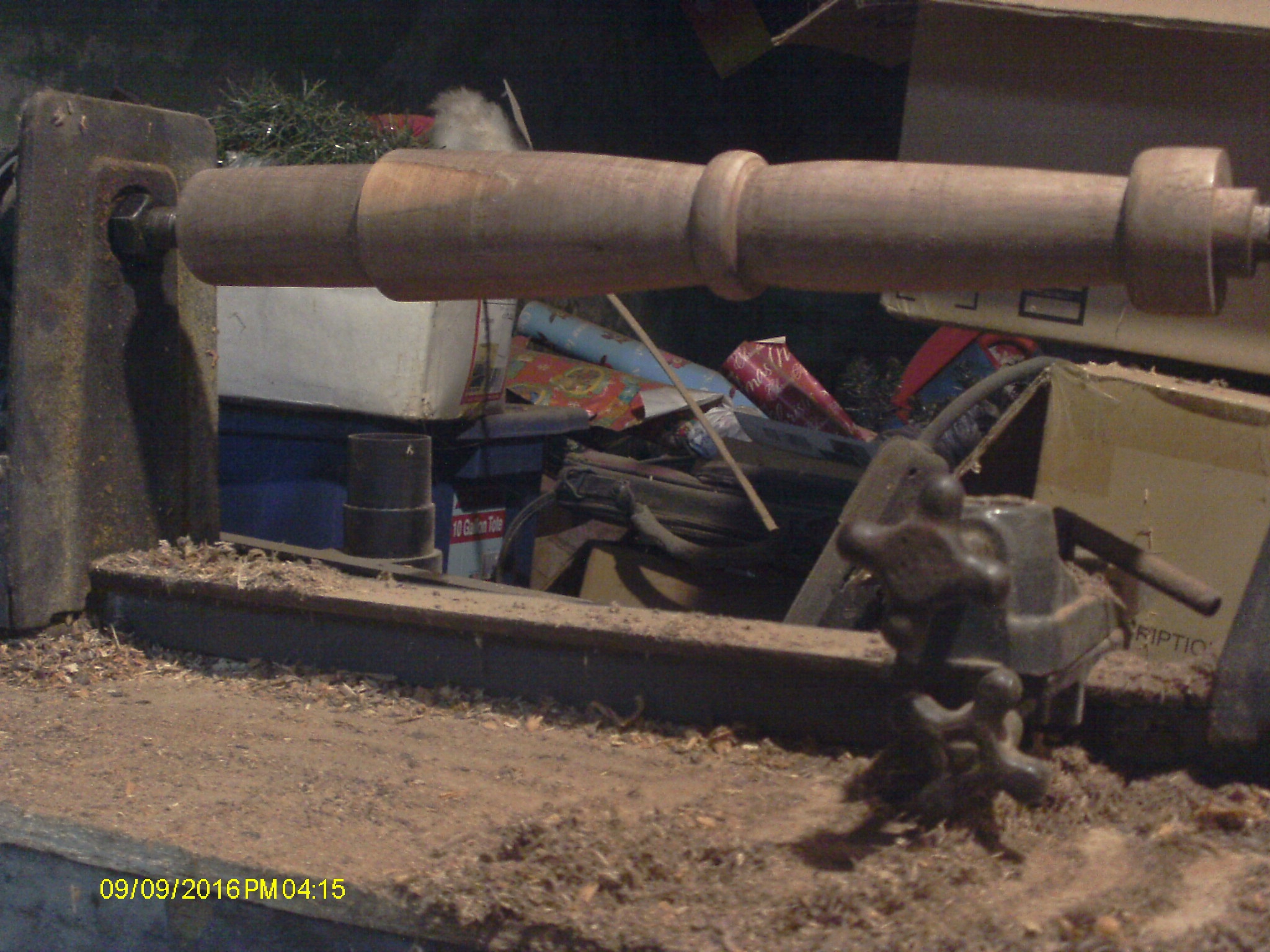

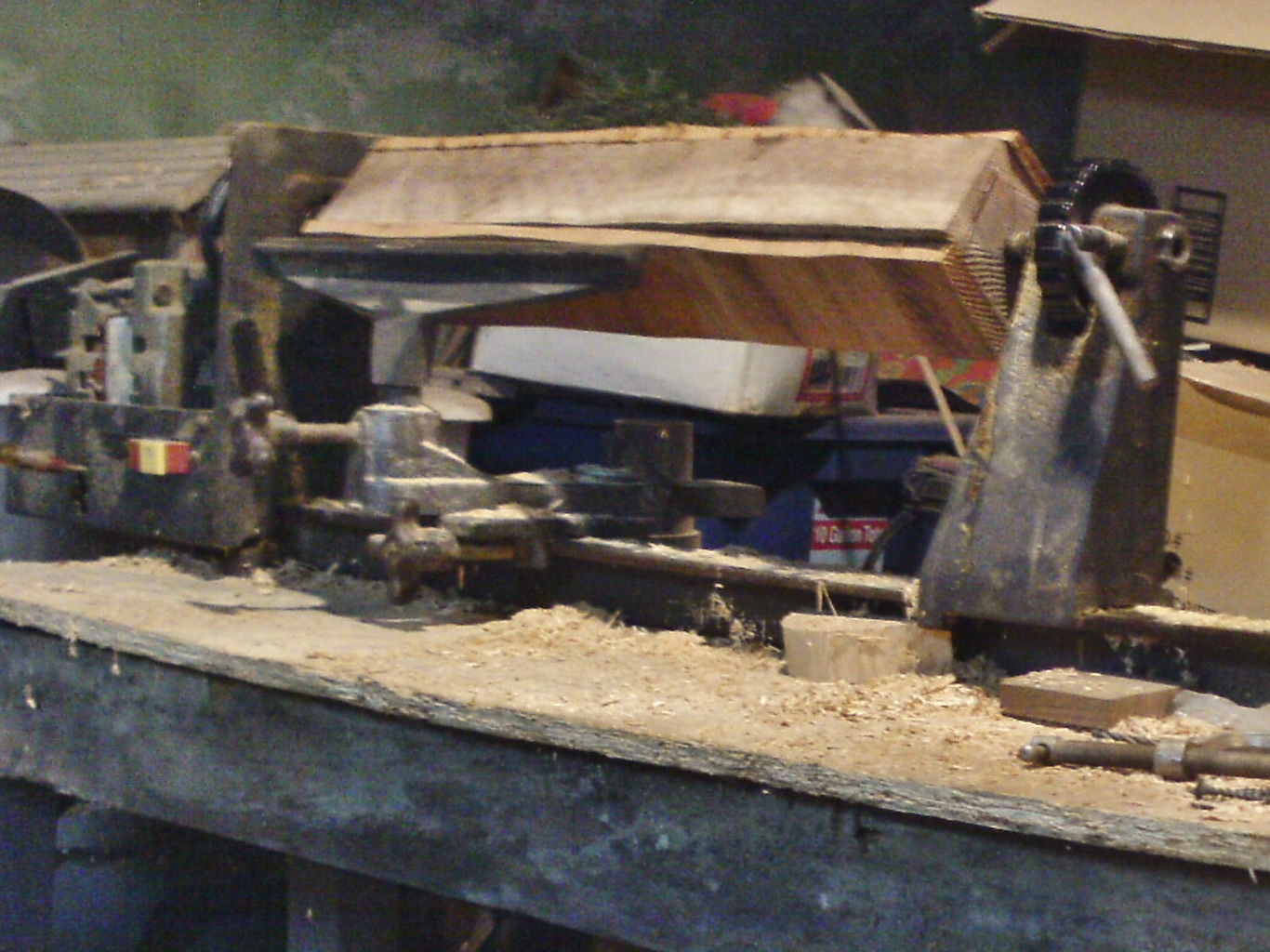

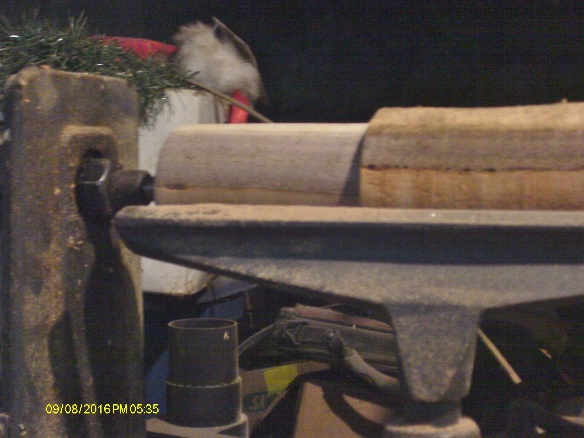

September 8, 201610 yr comment_72884 I suppose this should have gone over in the Turners section....but, had some wood working to do.. Snuck back down the stairs. Hmmm, there was a lathe sitting over there, last time I saw it.....a little moving around of other stuff... Well, well, lookee what I found...Even found some chisels that might go with it.. These were stashed under a pile of other..stuff. I even have room to work in there... Hmmm lathe isn't a pedal powered one? Guess I will just have to make do.. Got the blank out of the clamps, bandsawed the excess stuff off, set it up in the vise.. Tried to find center of mess, er..mass. Add-ons prevented the center finder from working....measure a few times....FINALLY was able to mark one end, and drive this thingy into the other end... Meh, it does work.....took this over to the lathe.. Hand spun to see how it turns....FOUND a cord that would reach to the lathe, did a bit of rounding work.. Trying to keep this area for the legs.....kept turning.....threw the belt tensioner off the lathe, then threw the belt.....getting a bit rough down here.. It will have a "collar" and a tenon at the top. Need to keep on turning.... Figures, I get these two pictures mixed up. Gave things a good rough sanding down. Will layout for sizes next time. Letting the lathe cool down. I even got the top out of the clamps... Maybe tomorrow, I can scrub this down a bit? Right now, there is an old-fashioned "Gulley washer going on outside.....mean the Dungeon Creek will be starting up. Might as well kick back for the evening... Might post parts of this over with the Wood Turners? Think they would mind? Report
September 8, 201610 yr comment_72885 Nice! I like how you kept the bark in there - makes the piece have more character. Report
September 8, 201610 yr comment_72902 Turning is about complete. Looks good. Still a nice chunk of Cherry showing. Report

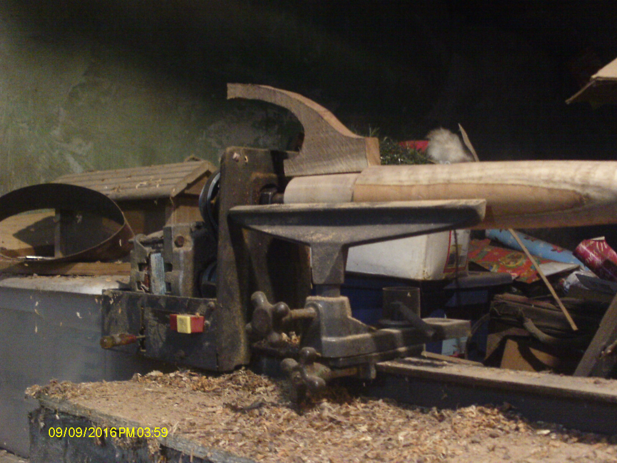

September 9, 201610 yr Author comment_73067 Well, for your viewing pleasure, a case of Plain & Fancy... Needs a final sanding. The "Plain" side of this post...and.. The "Fancy" side. There is now a ring in the middle, the collar has been resized, as well as the tenon. Had it about parted off, remembered to at least sand the thing. Even got a start on the legs... Need to shape the legs, cut a dovetail joint, and get three legs fitted. Tenon will go into a slat that will attach to the underside of the top. Tenon will get a saw kerf, then a wedge. Might take awhile.... Report
