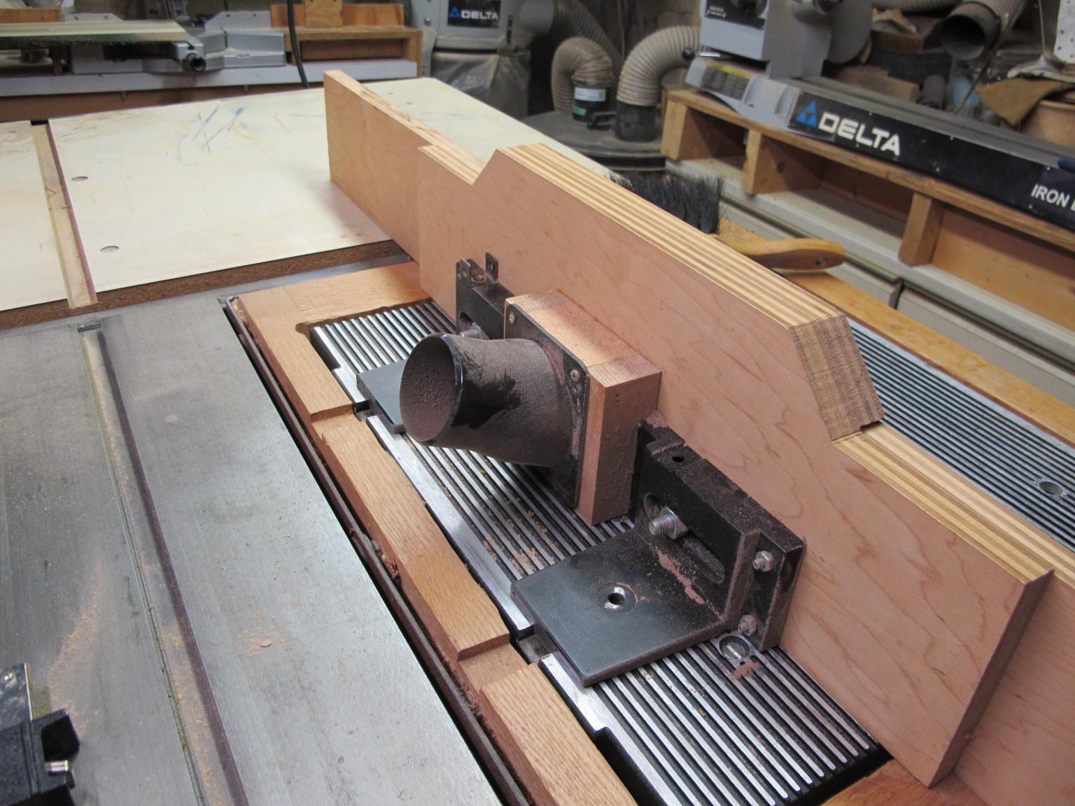

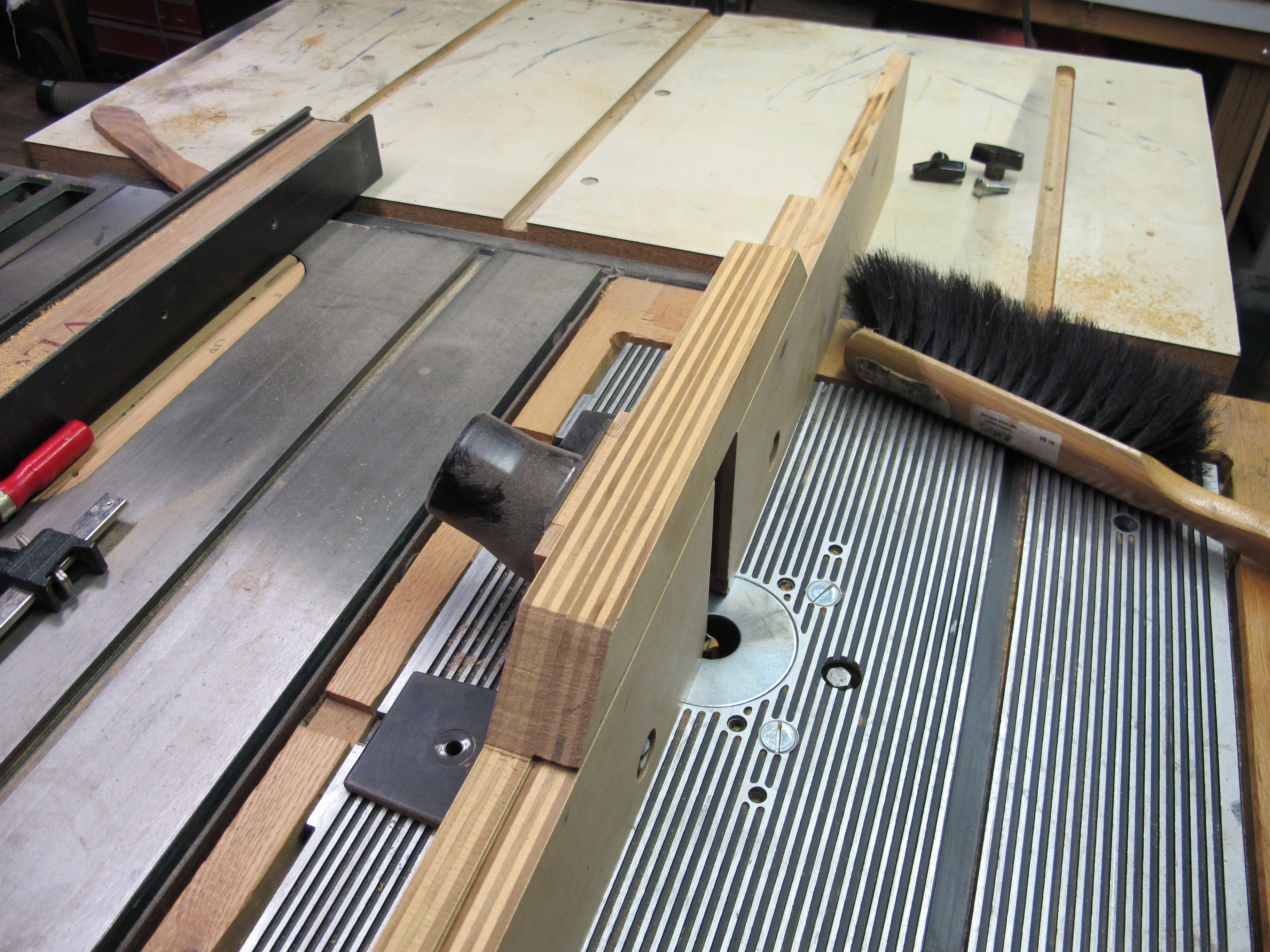

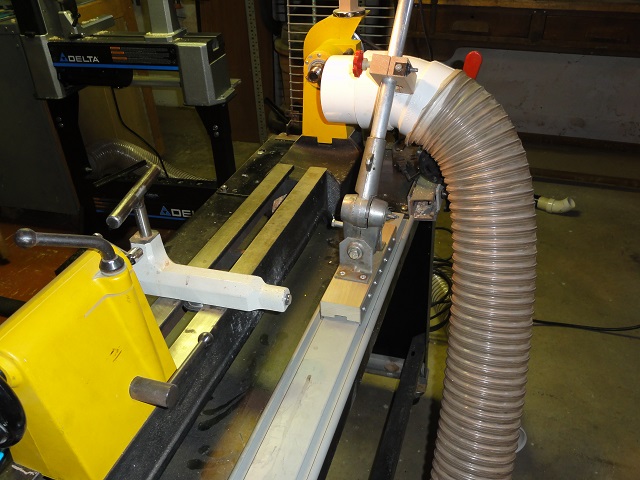

August 31, 201610 yr comment_71013 My router table is mounted in place of one of the table saw wings. I use an extension hose to connect the router fence port to the main connection. Of course this method only works when using the fence. For the lathe, I plumbed a hose directly behind the lathe. I have an extension piece to get close to small work. I really need to make some sort of "hood" to make the dust collection more efficient. Report

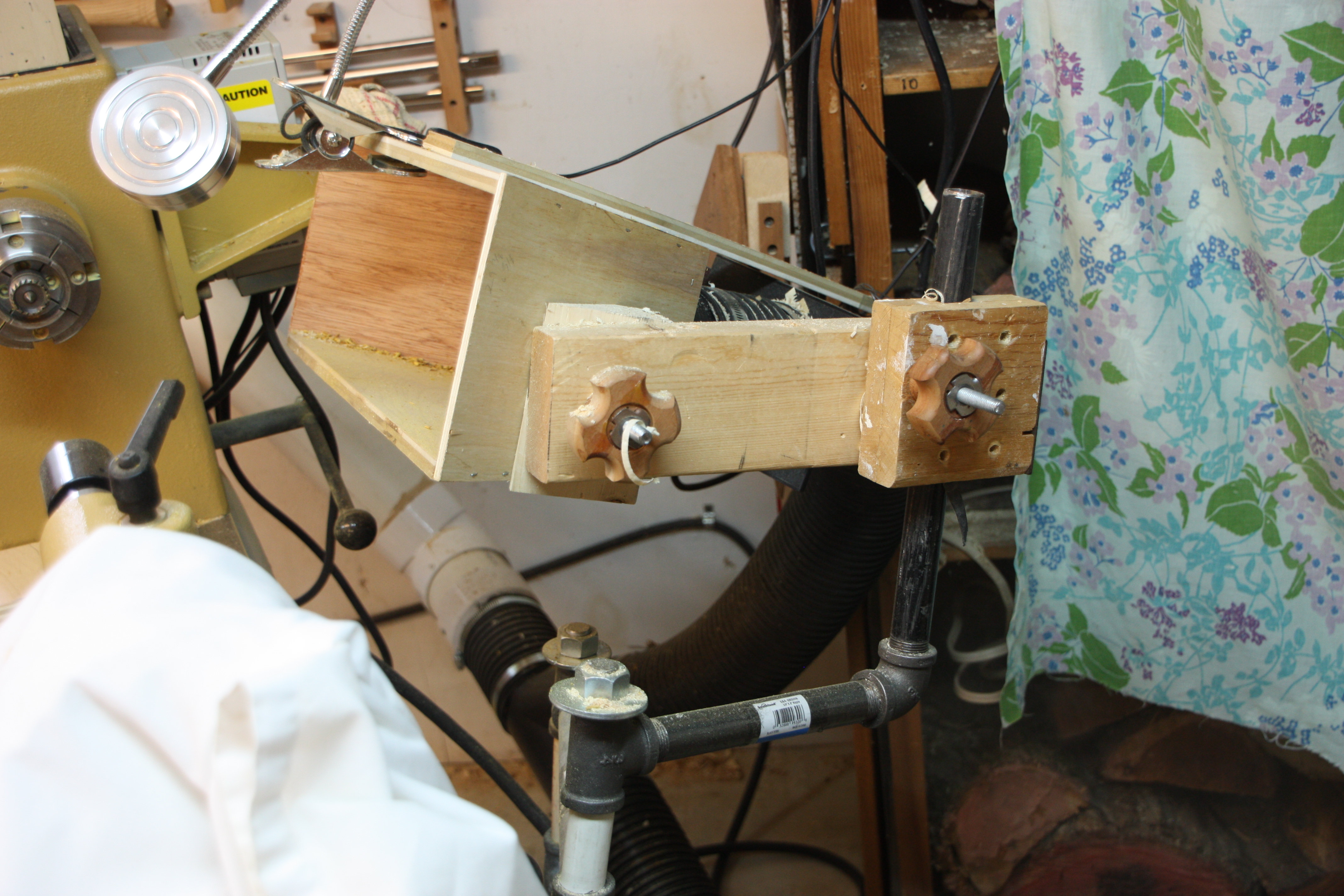

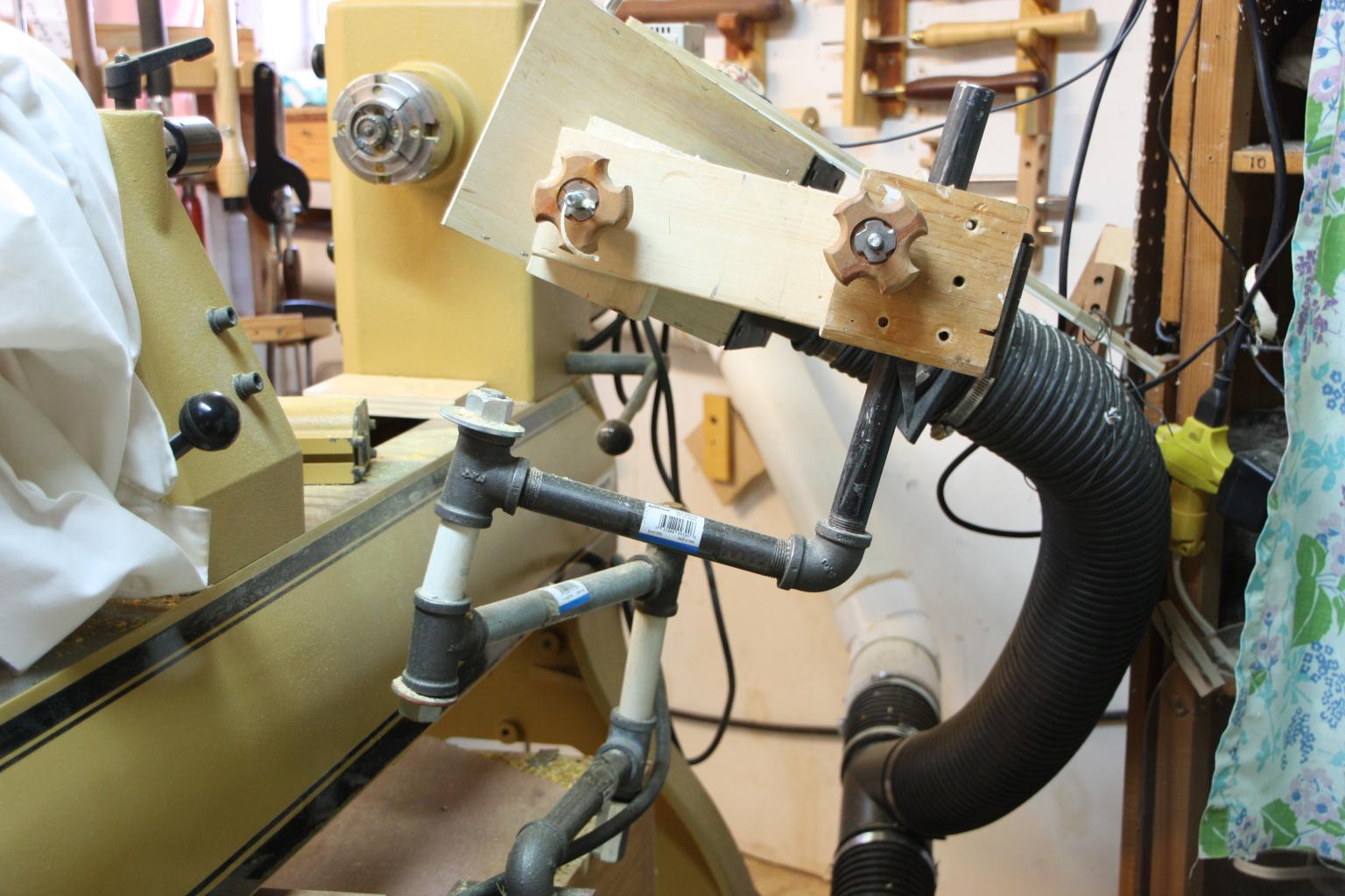

August 31, 201610 yr comment_71014 I took a golf bag cart salvaged on trash night and came up with this gizmo using the adjustable handle. It is on a track and can be moved from one lathe to another. Report

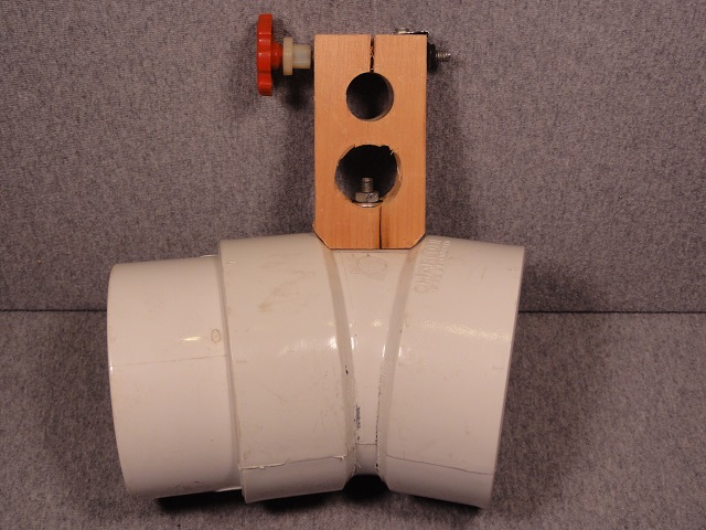

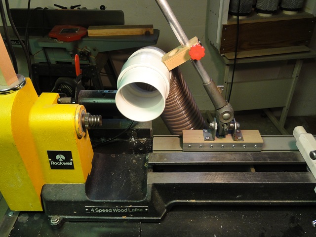

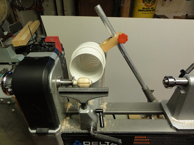

August 31, 201610 yr comment_71017 Don't have a good router table solution and as for the lathe you're never going to control shavings. You can minimize dust when sanding but shavings happen. No pictures but I do have a little video showing my setup. It's patterned after a camera boom video that Carl Jacobson did. Dust collector Steve Report

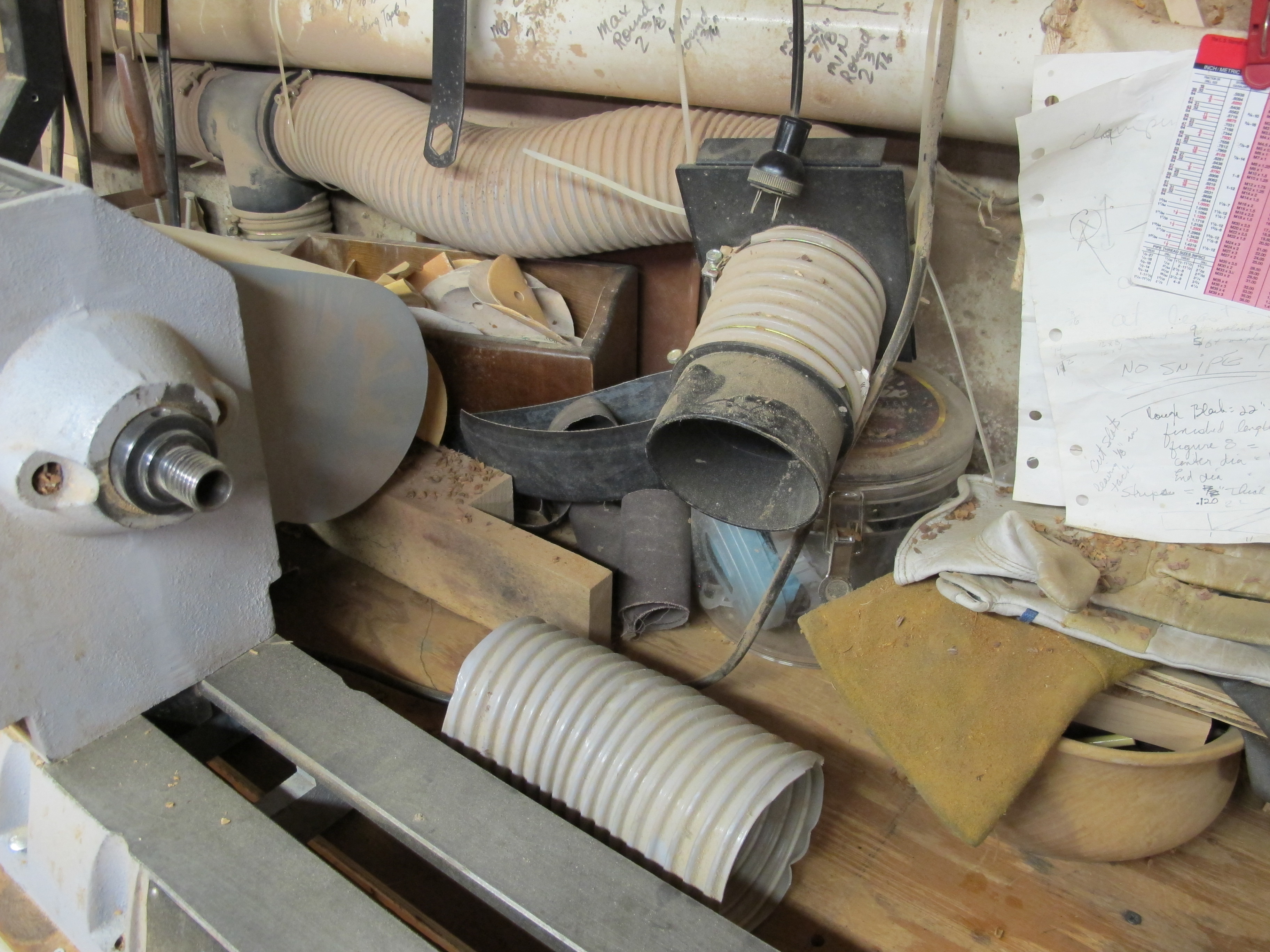

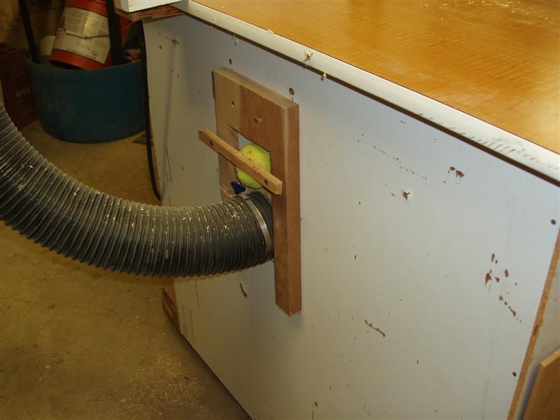

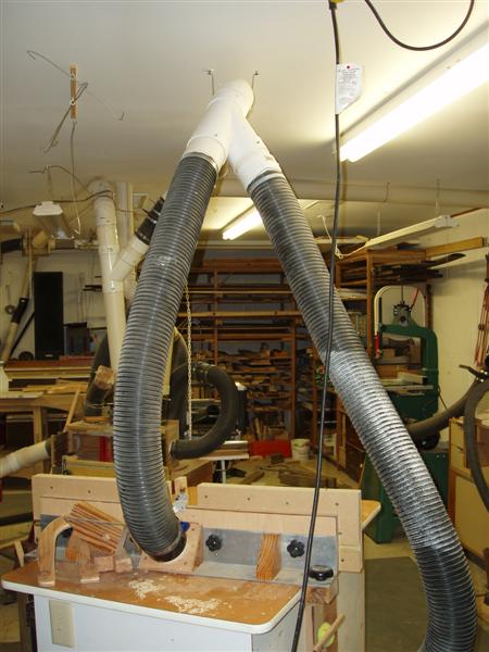

August 31, 201610 yr comment_71076 This may get complicated. for the lathe I have a home made scoop with adjustable pipe for the placement of the scoop. For the Router table is based on Norm's table.with a lower pickup for under router and a fence pickup for top of the table. Note there is a baffle inside the table so the pickup will get all the inside floor. Edited August 31, 201610 yr by Gerald Report
