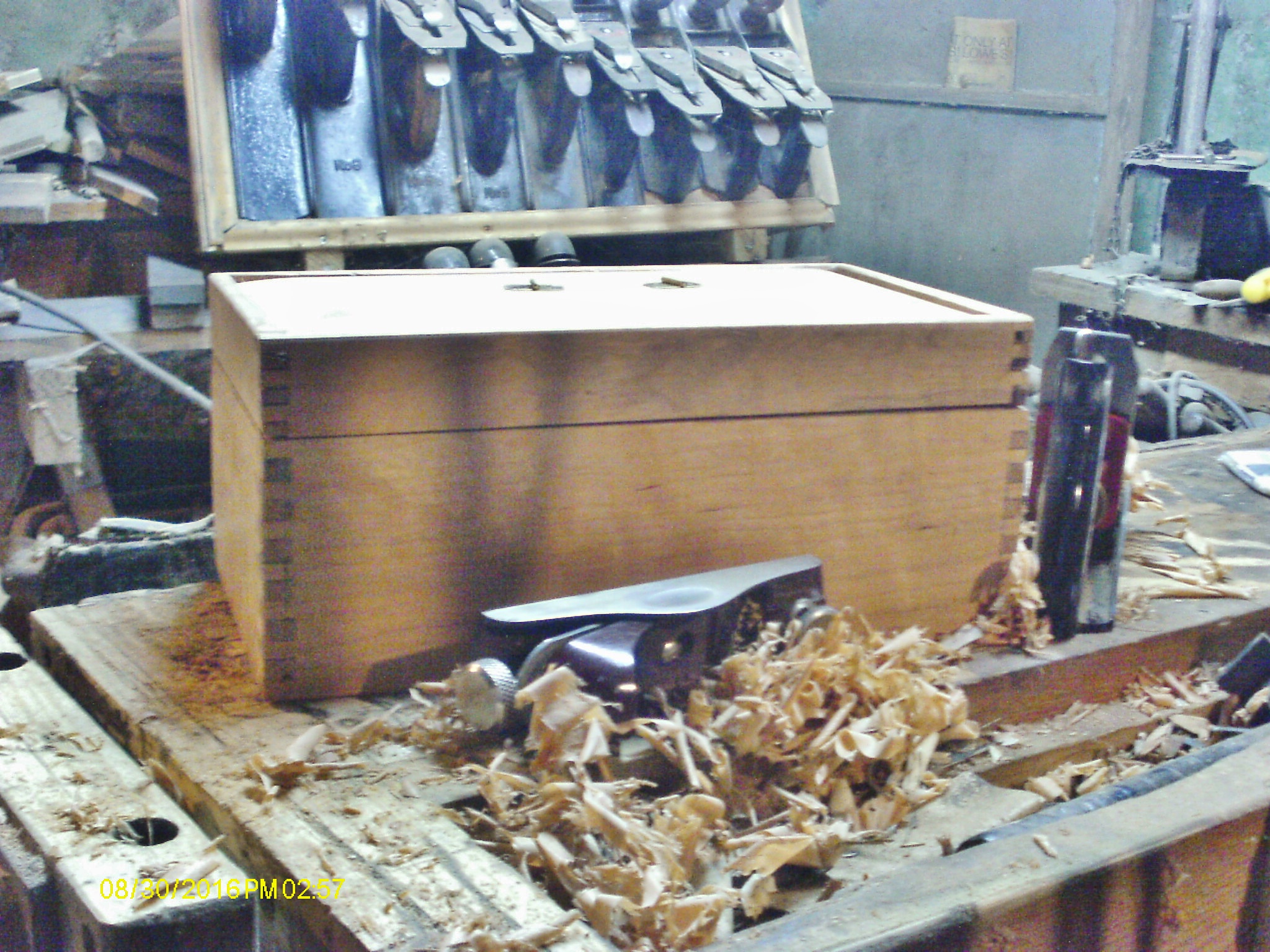

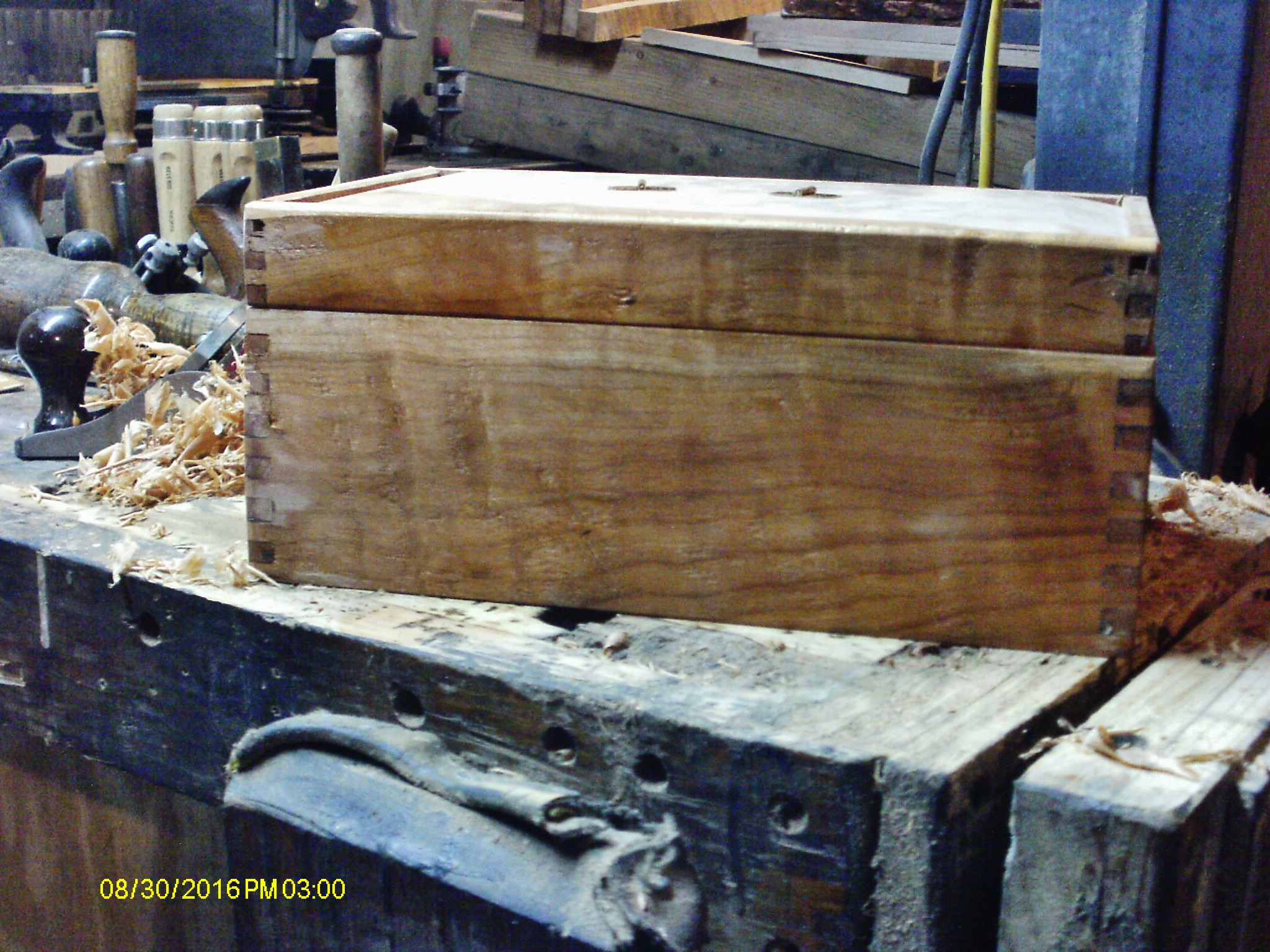

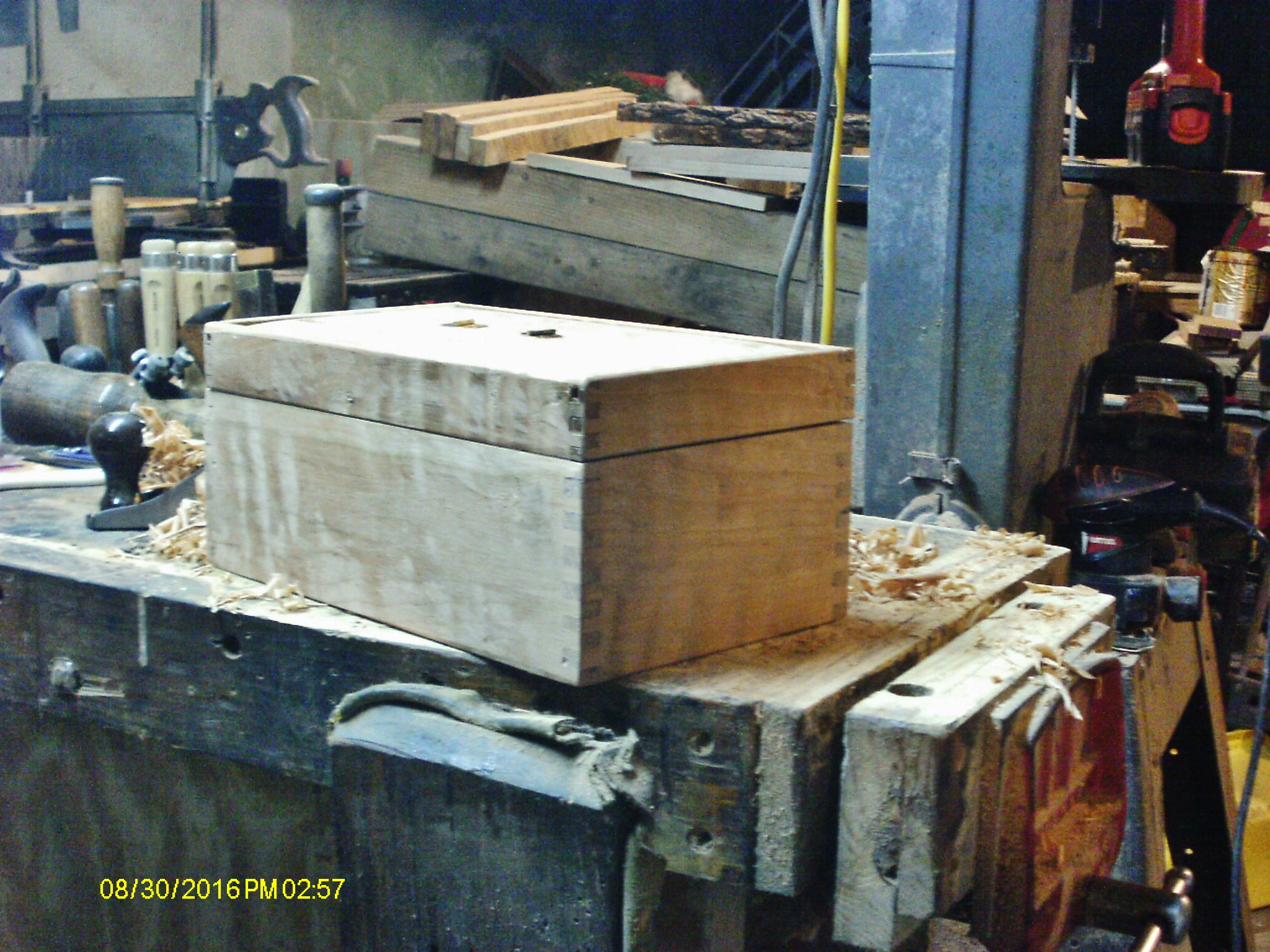

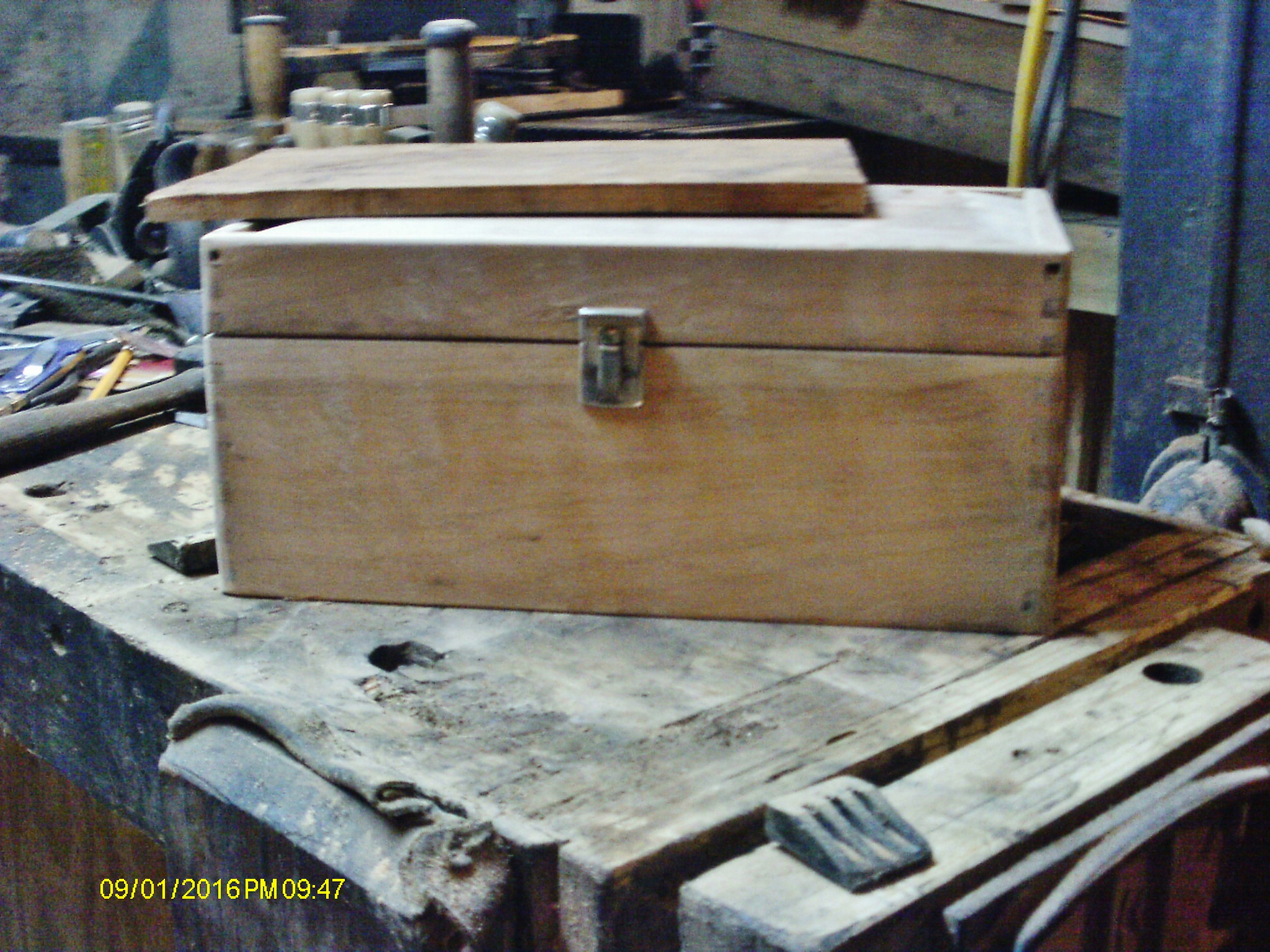

Cherry Box project, lid is fitted
Well, I released the lid from the clamps.....lid was a hair undersized compared to the box......should have measured a third time.  Grabbed a couple planes, and put the box on a diet
Those darker lines?   Shadows from the drop cords.  Planes are a #60-1/2 and a Craftsman #C3 ( Millers Falls No. 8)   There is a shadow line around where the lid meets the box.

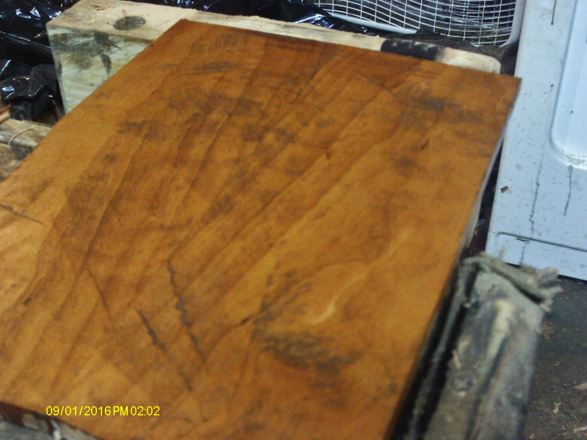

Gave the Cherry a splash of Alkee-haul to highlight the grain, if any..
I guess there is a bit of grain.  Hinges?

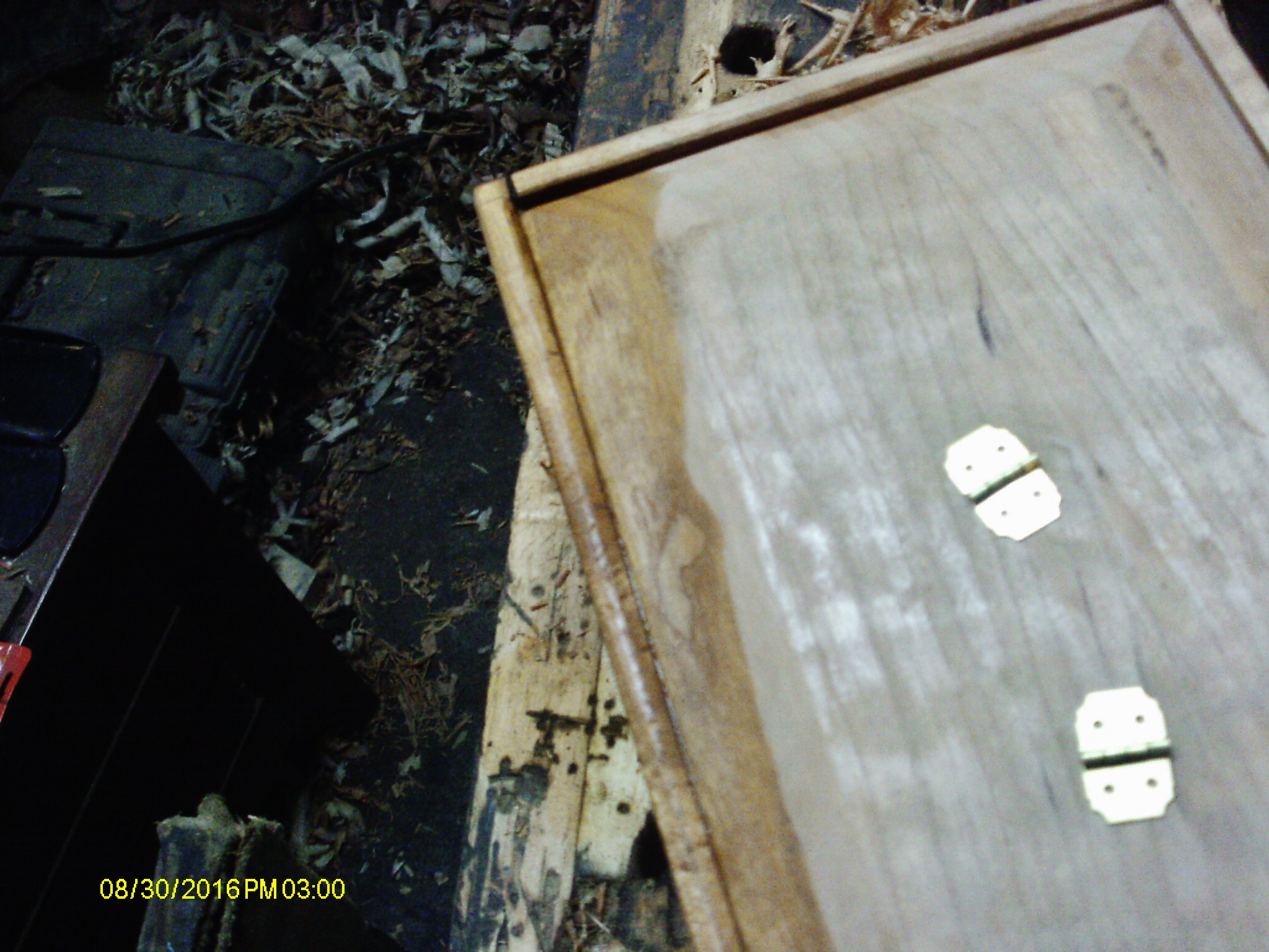

Have started installing the hinges, needed a piece on the inside of the lid, to catch the too long nails.   It was too thin back there, anyway....1/4"   Now about a strong 5/8" thick.

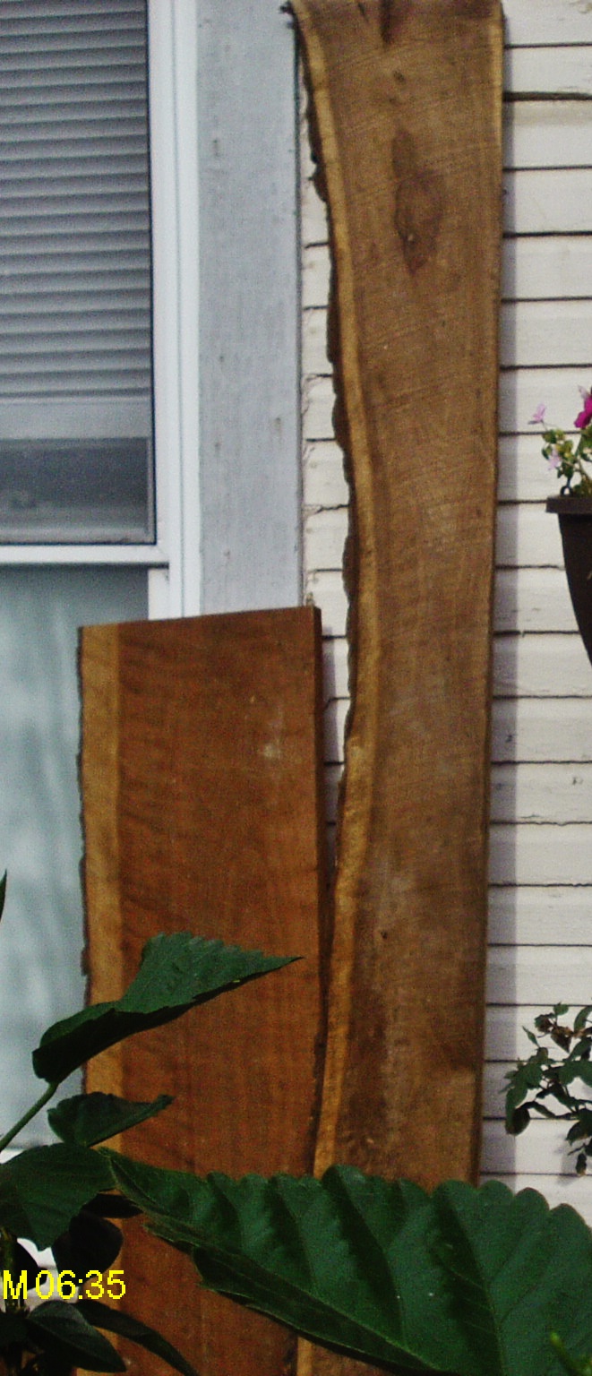

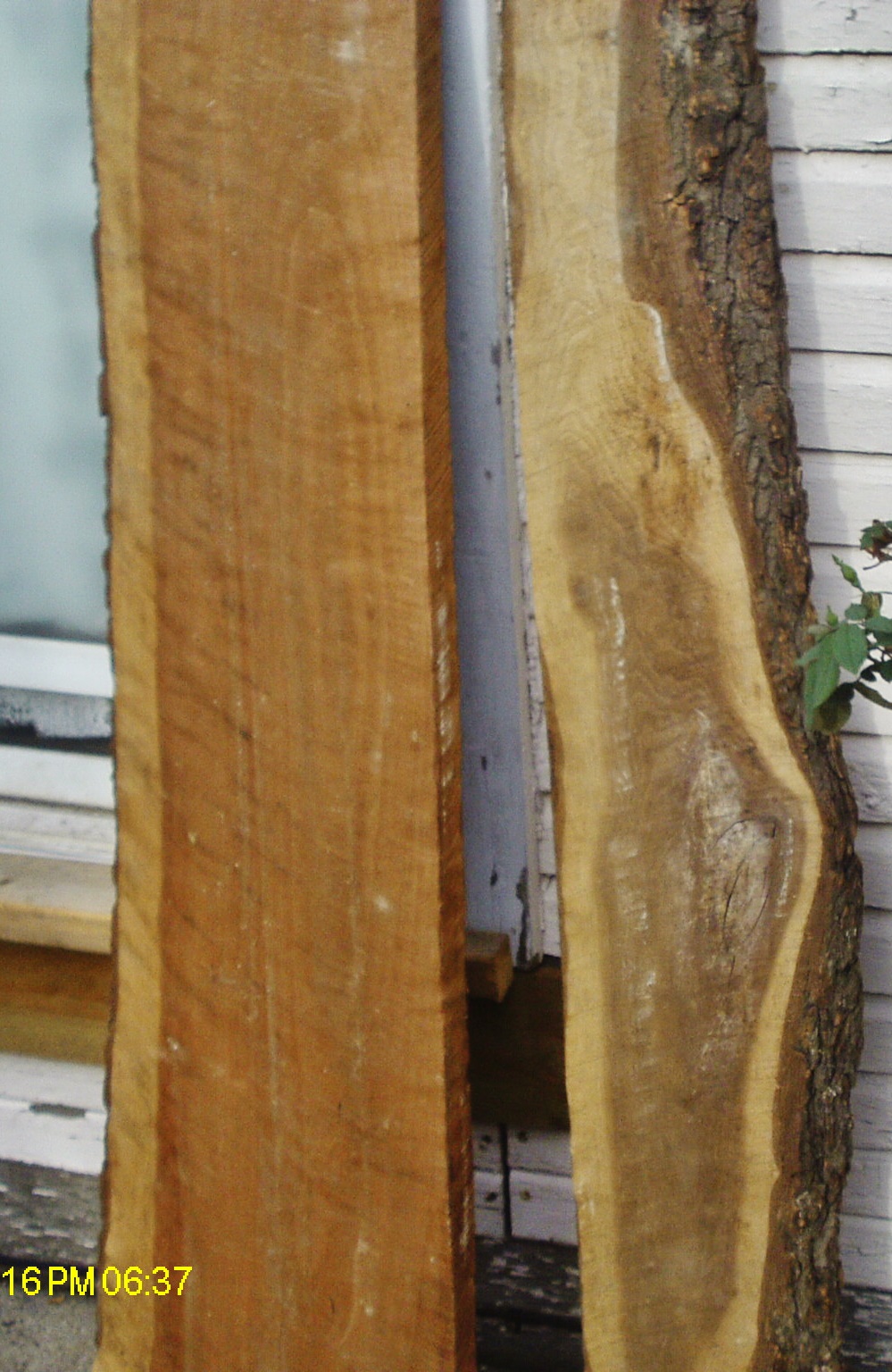

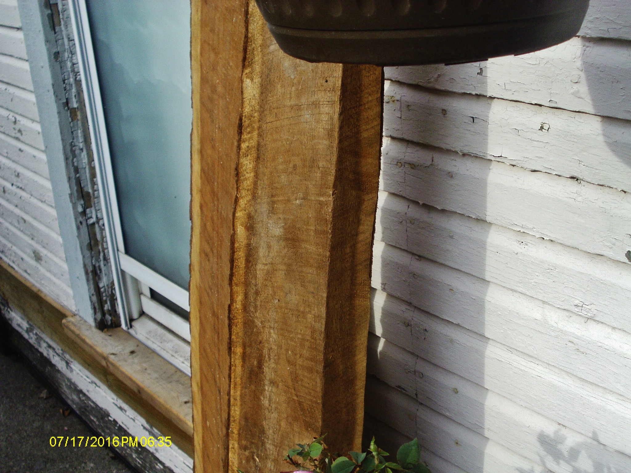

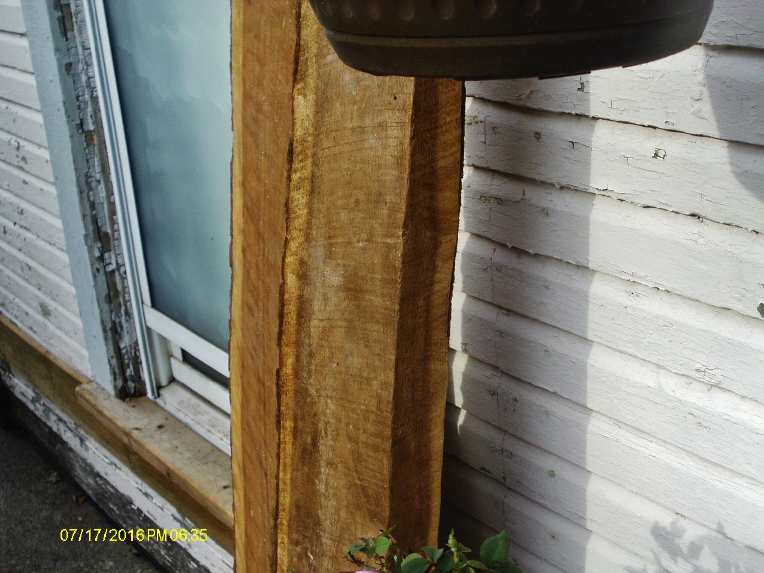

BTW....there is a 7' long slab of 8/4 Cherry still leaning up against my house...with bark along both edges..I think....
Top HALF of it....
Towards the bottom ...my mistake....bark is only on one edge...
A bit of sap wood....This 7' long slab of Cherry was also the same price as that short slab......$1 each...
May have to cut this one down a bit....too long for the shop..

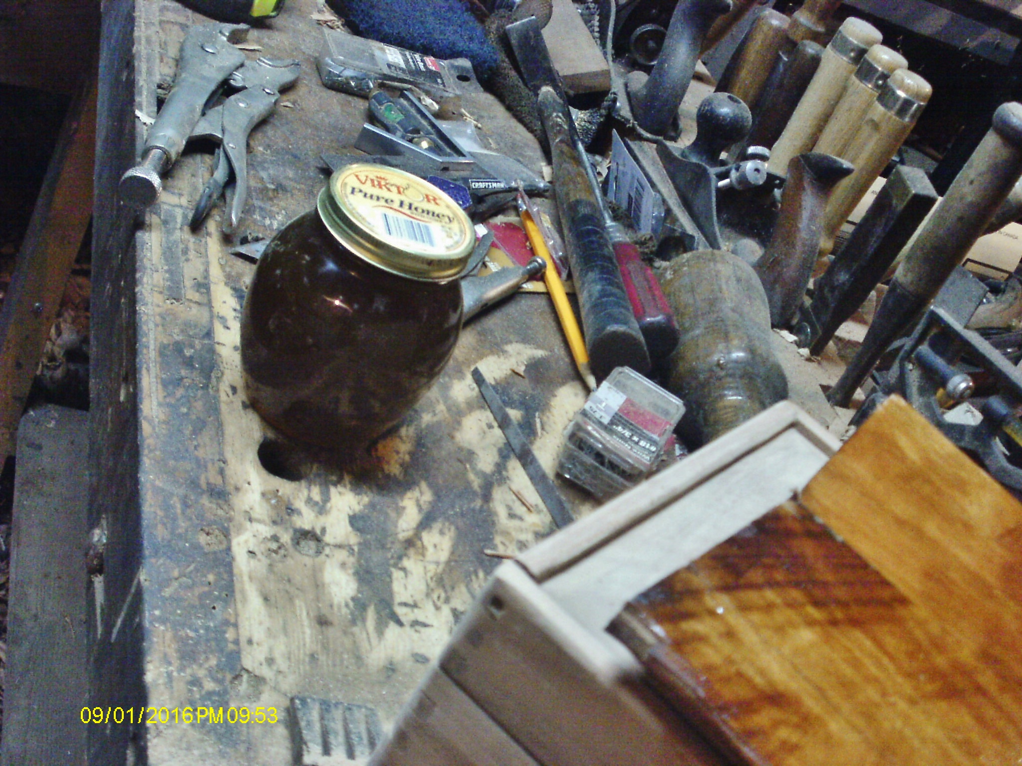

Sample ( flipped the board over) with a BLO/Varnish  mix....Hey, I did find a jar to mix it up in..
Might do for this project?   Mix wound up being 70/30..Blo to Varnish....

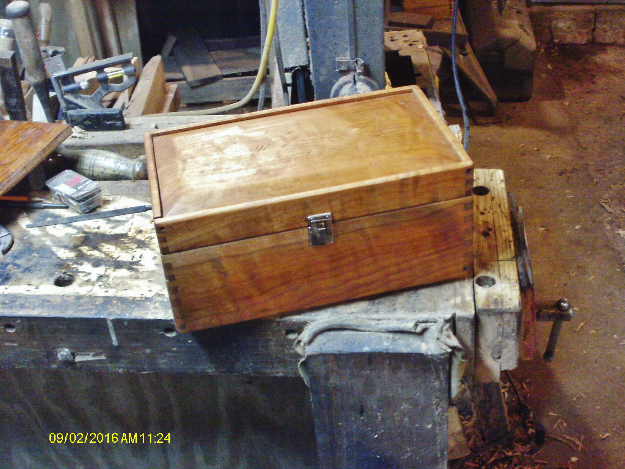

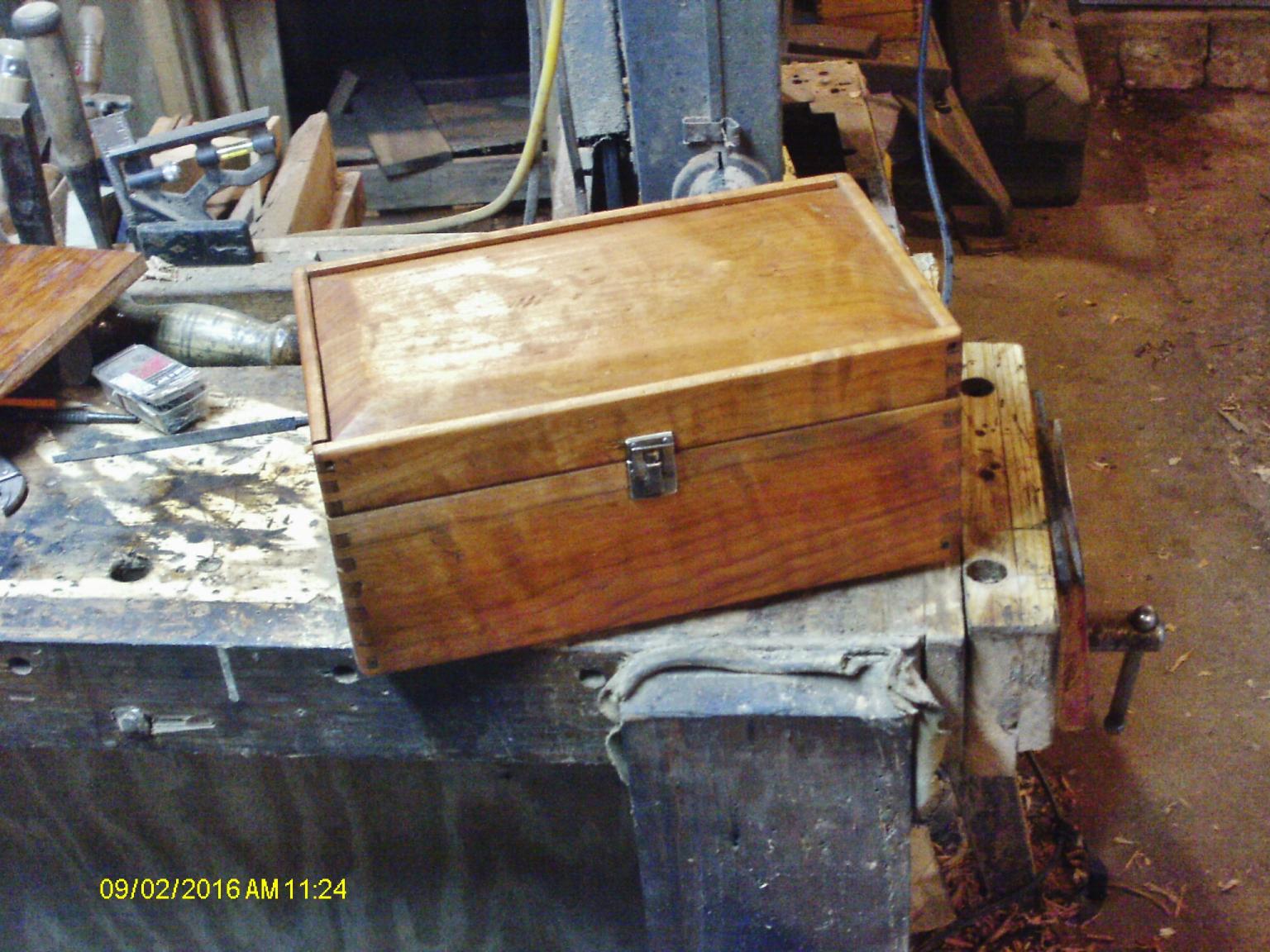

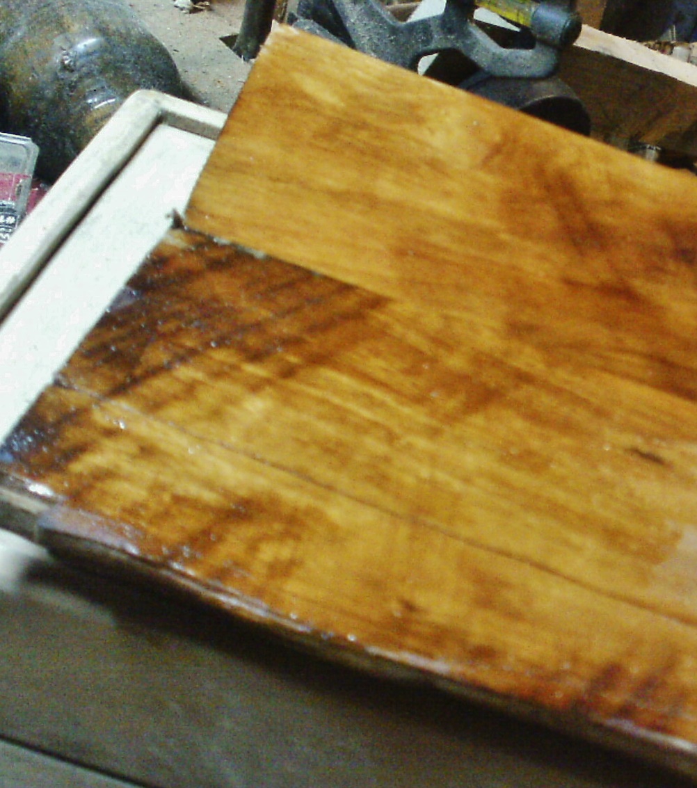

Have a "seal coat" of the BLO/ Varnish mix on the box right now, awaiting it to cure out, before I go any further.     Will need rubbed out, and then another coat or two.    Not sure IF I will do the insides, yet.  Not even sure about what will go in the box....depends on what this "Bandit"  picks over the weekend....Just missed out on a Stanley 71 last year at the Tractor Fest.....may try again this weekend.
Just gave the finish a scrub down...
Have it sitting up on a benchdog, and a scrap block... Might need a couple more coats....

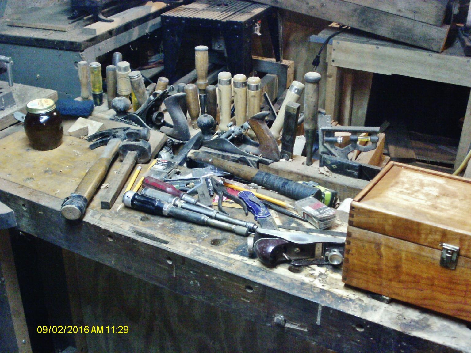

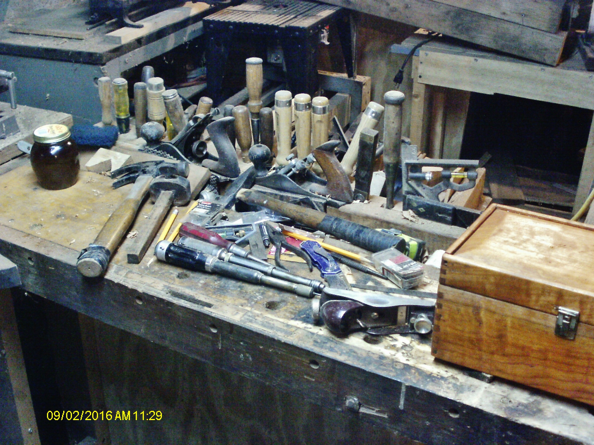

Pile of toys sitting on the bench?
Might need to clean the bench off...again...
