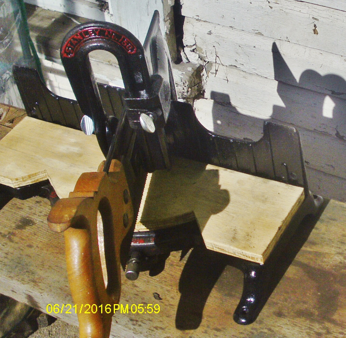

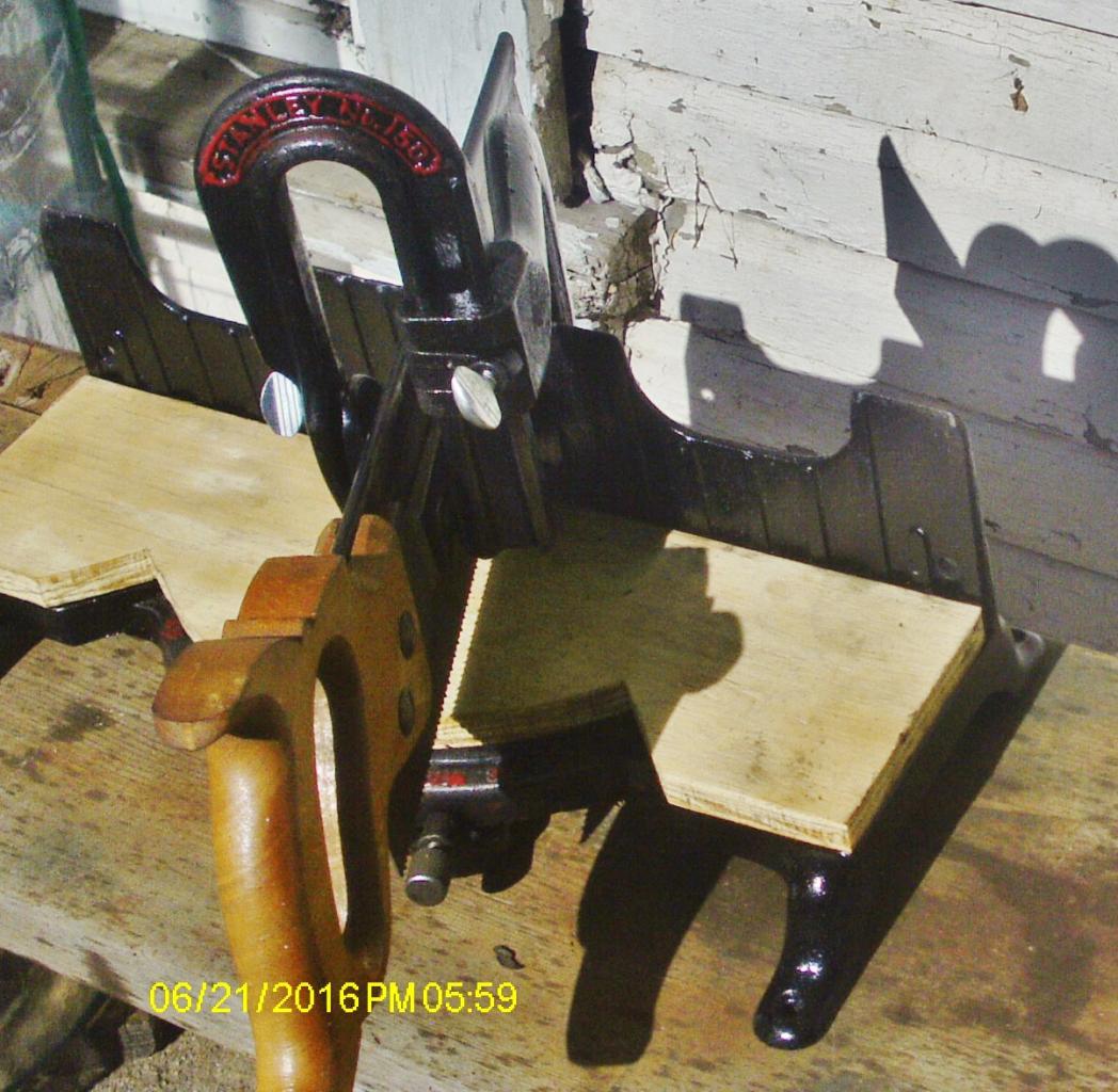

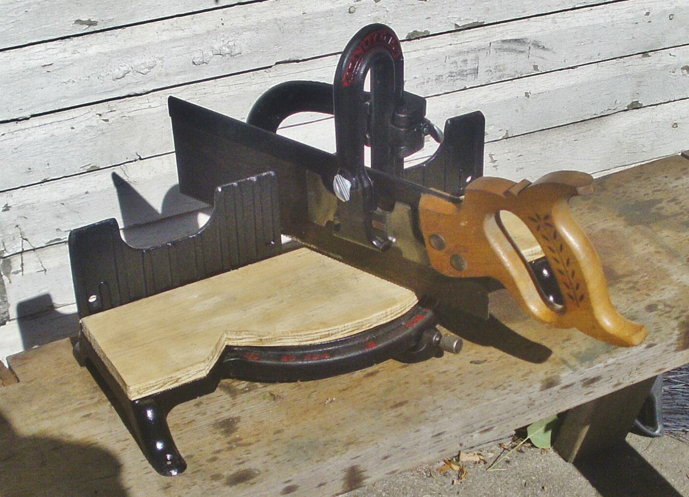

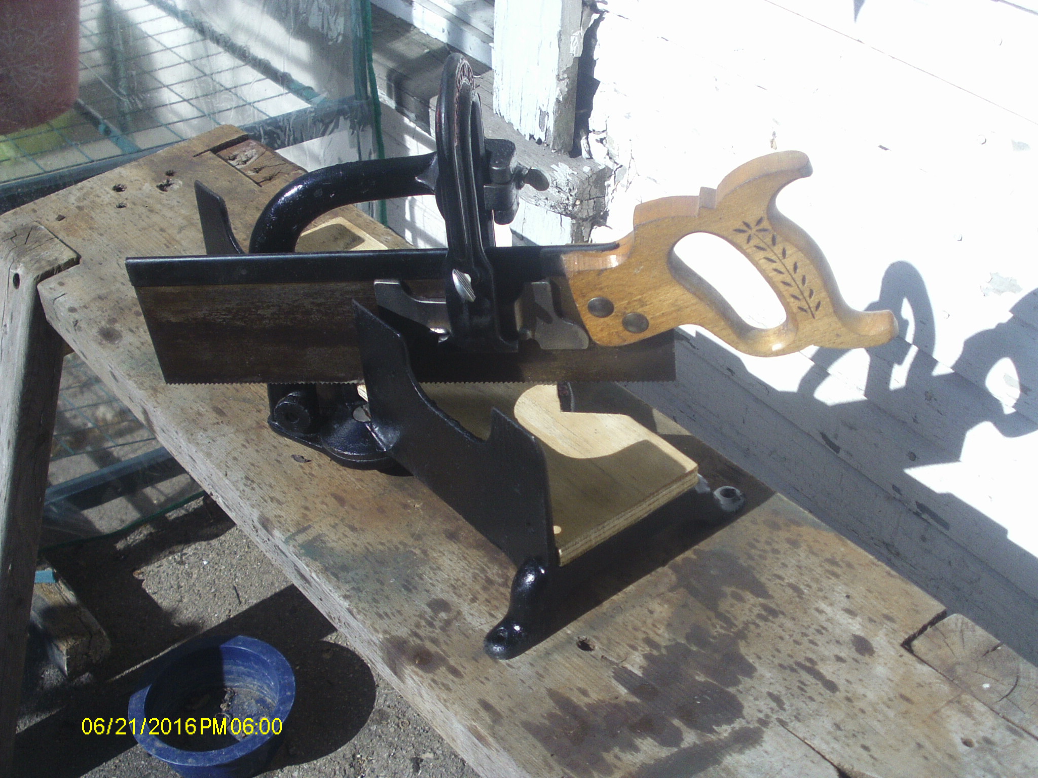

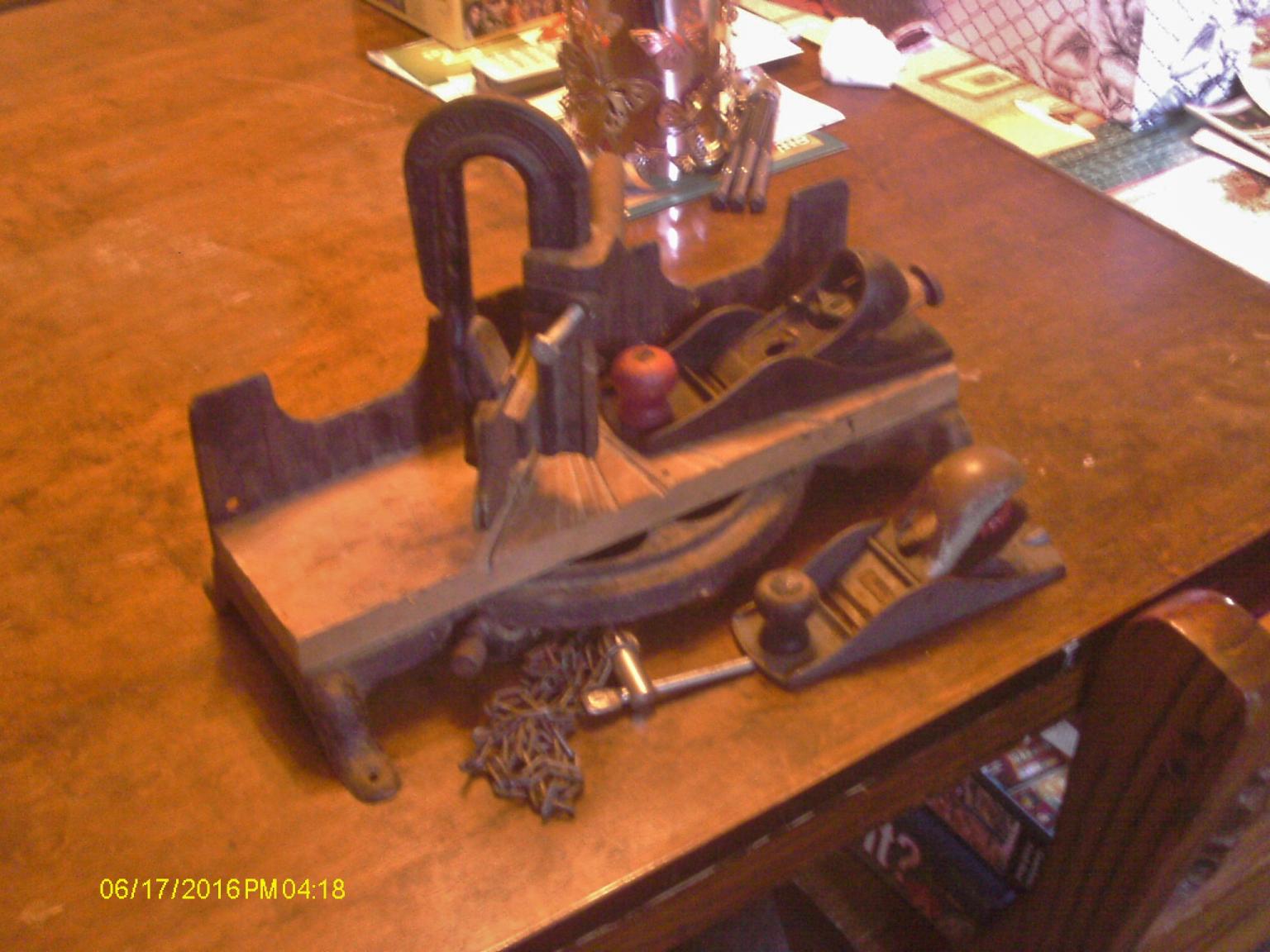

June 21, 201610 yr comment_66947 Well, had that $1 mitrebox, very rusty and neglected That big old bolt had to go. Found a couple thumbscrews. Tossed the old pine deck. Strip off all the rustiness. Wire wheeled things clean and shiny. Added a few layers of Rustoleum Black from a rattle can. After that had dried, added some red paint. Came from a Duplicolour Red used for scratch repairs....took the assembled thing outside, to bask in the sun for awhile... The backsaw I already had on hand, just needed a home for it, right? Note the red numbers? Well, there are a few more.. While cleaning this thing up, noted that this area was also red. Merely restored the letters. Plywood deck will just have to do.... Even shined up the saw guides. And, since all the rust had been cleaned off, the swivel is even wobble free. Not too bad...for a dollar bill? Stanley No.150 mitrebox, with saw. Report
