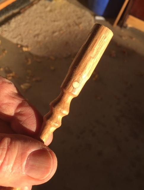

November 3, 201511 yr Author comment_63156 This is my effort. I drilled a hole on each side and filled with soda and super glue. It wasn't bad, but I'd like to make it better Report

November 4, 201511 yr comment_63170 what's the effect you are going for here.Try mixing an alcohol soluable dye with the soda to color it let dry overnight and try that with the glue?Baking soda acts as an accelerator by virtue of all the surface area. Sawdust does the same thing just not always as aggressively. Most of the commercial accelerators have some combination of the followingAliphatic Petroleum Alkyl Toluidines Xylene EthylbenzeneAcetoneNaptha Toluidine Quinone I don't know what the chemistry is going on with them. I know water also acts as an accelerator and so was a warm moist breath. Report
