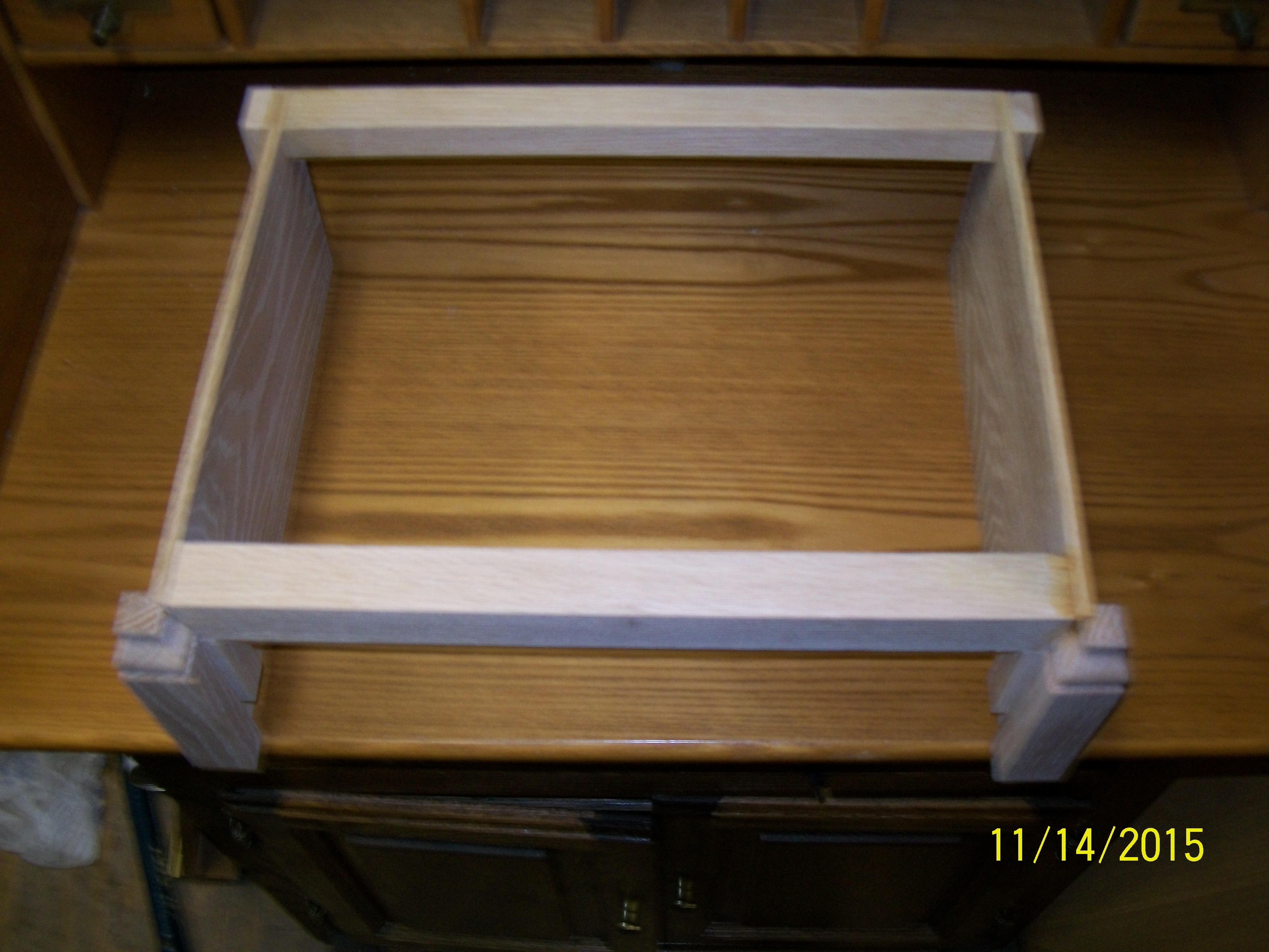

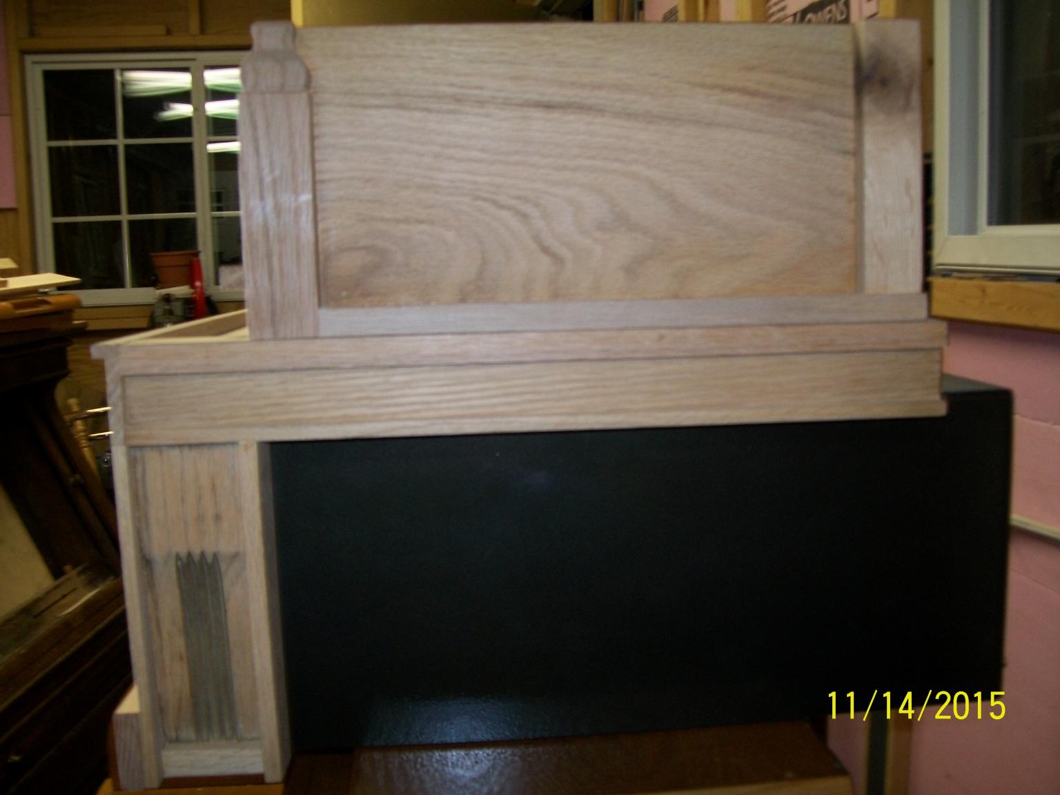

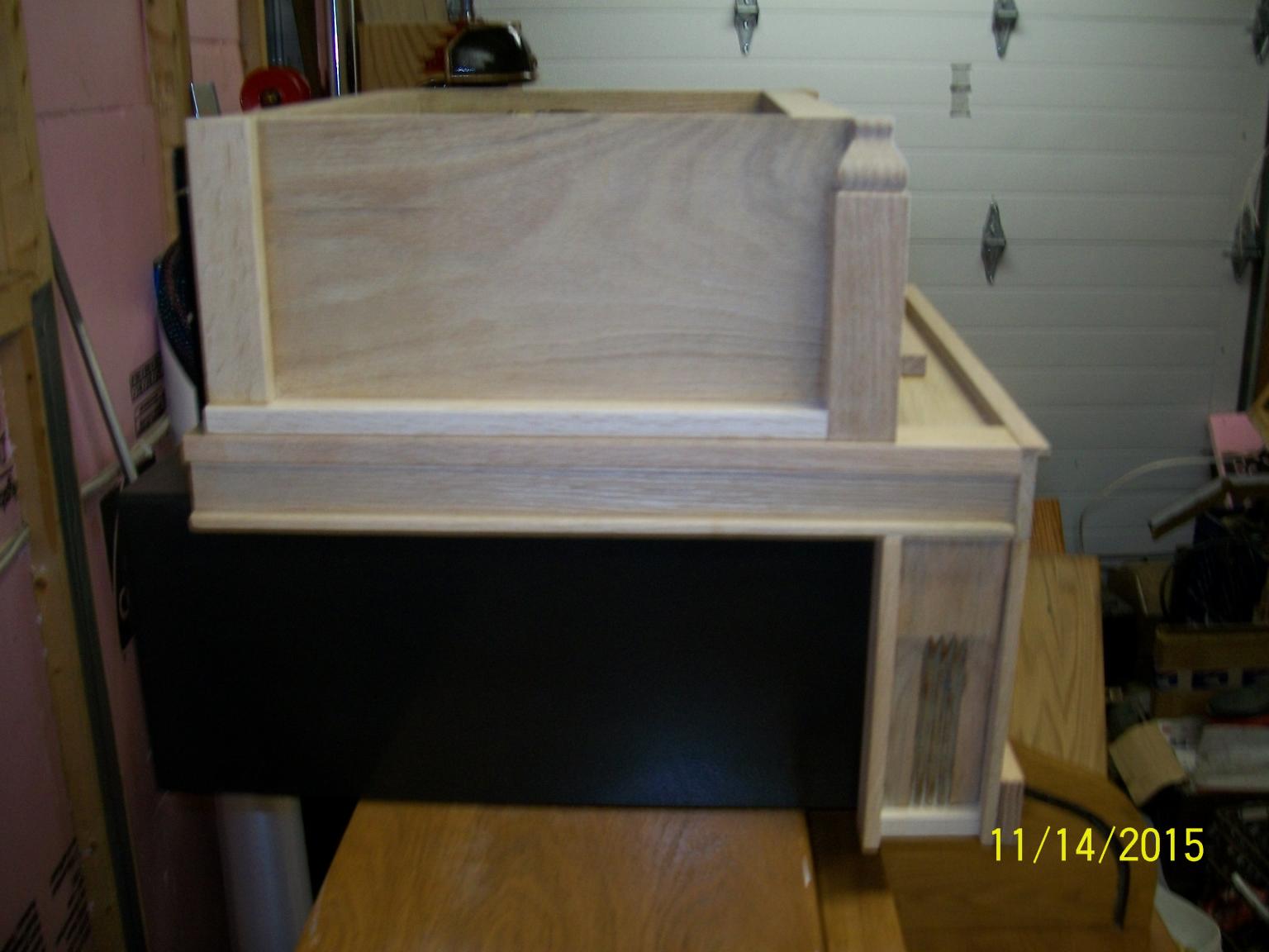

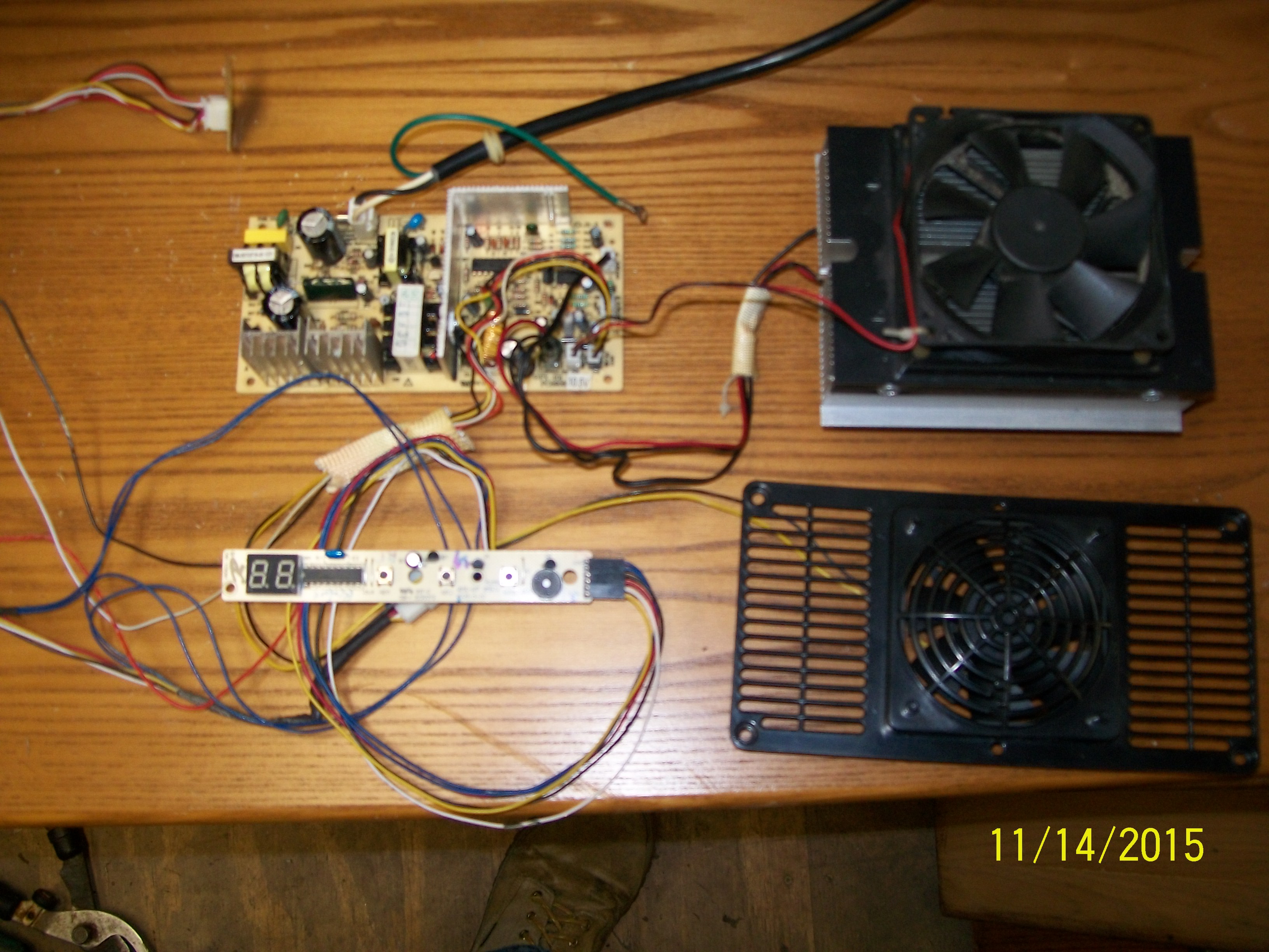

November 15, 201511 yr Author comment_63336 Well, I finally got a bit more done on the "Komputator" First off I got the Thermaltake RamOrb finned copper coolers installed on the memory sticks. I've got similar coolers for the video cards, but they will require the fabrication of different mounting brackets to fit my video cards. It's not a big deal, but I'll have to get some 1/16" x 1/2" brass, and a 2mm tap for the mounting studs. I also got the motherboard upper case area framed out. Here's a few views of the upper case set into place on the lower case. Front view. Left side view. Right side view. I also took apart one of those small Thermal Electric Cooler (TEC)(Peltier) wine refrigerators apart for cooling the upper half of the case. This was a freebie roadside find. Can't resist a freebie. This is a 172 watt unit, so should have no problem keeping the upper case section cool. I was going to replace the aluminum heat sinks with copper finned units, but decided not to due to the fact of how well the unit is sealed. This unit is adjustable from roughly 46°F to 72°F. I'll be building this into the top of the case. That's about it for today. Report
