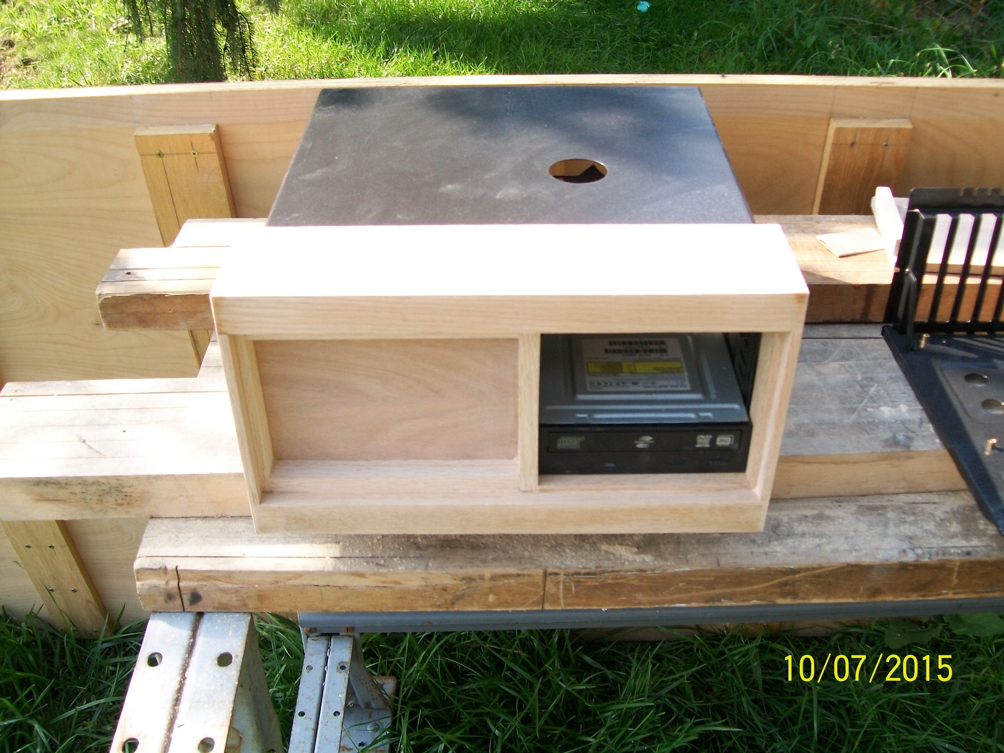

October 7, 201511 yr comment_62757 Here's the start of a little project made from some scrap pieces of Oak I got from my friend Ron who passed away the 23rd of September. I'm sure Ron would have got a kick out of this project. It will end up being a test bed style computer case. The lower section is an old AT style case from the old 486, Pentium 1 days. I'll be using it for mounting my power supply, drives, etc.. Here's the Oak frame that will be replacing the old beige plastic front. It's not quite finished, but will give a hint of where this is headed. Front of frame. Rear of frame. Sliding door set in place. Report

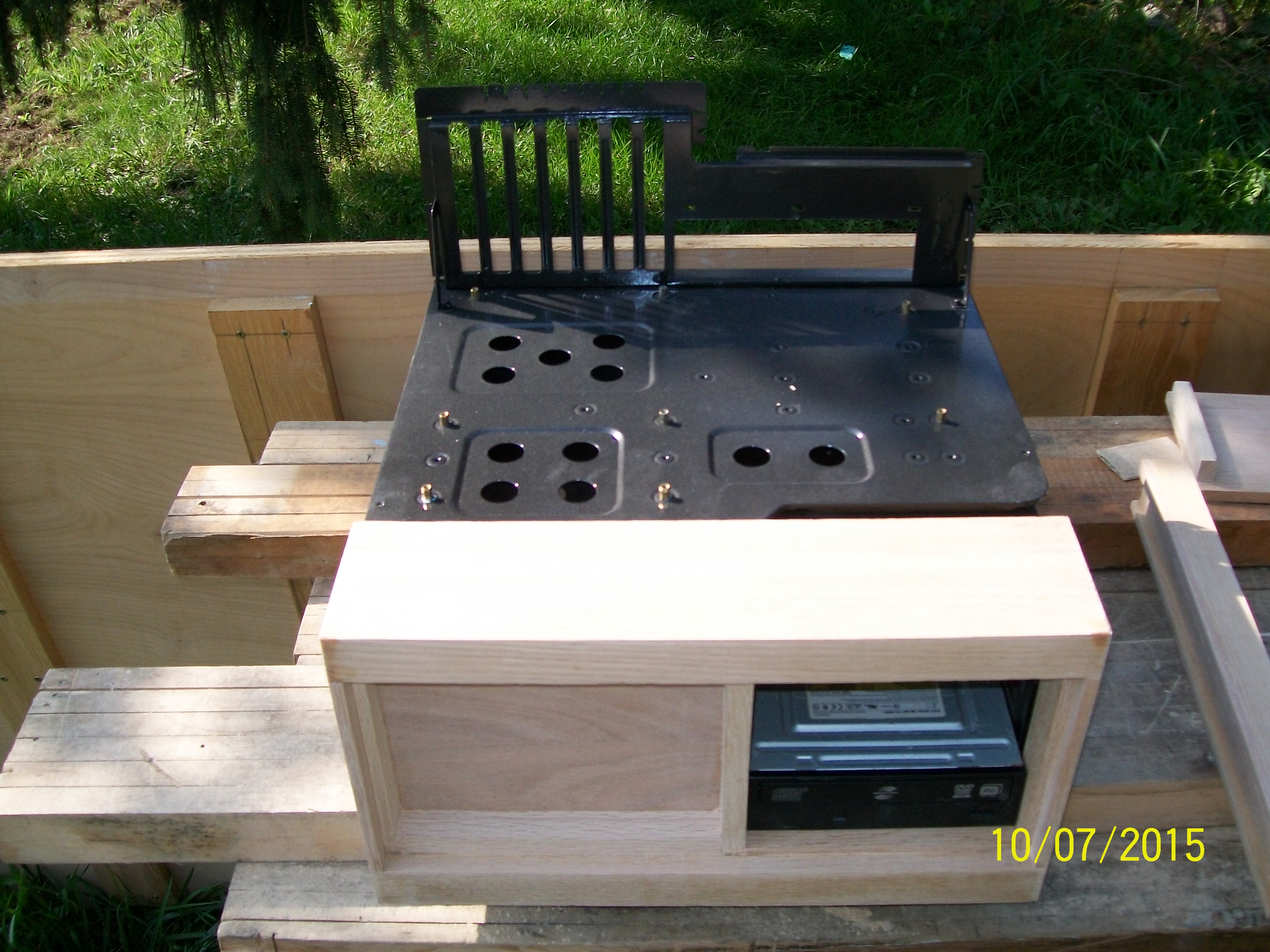

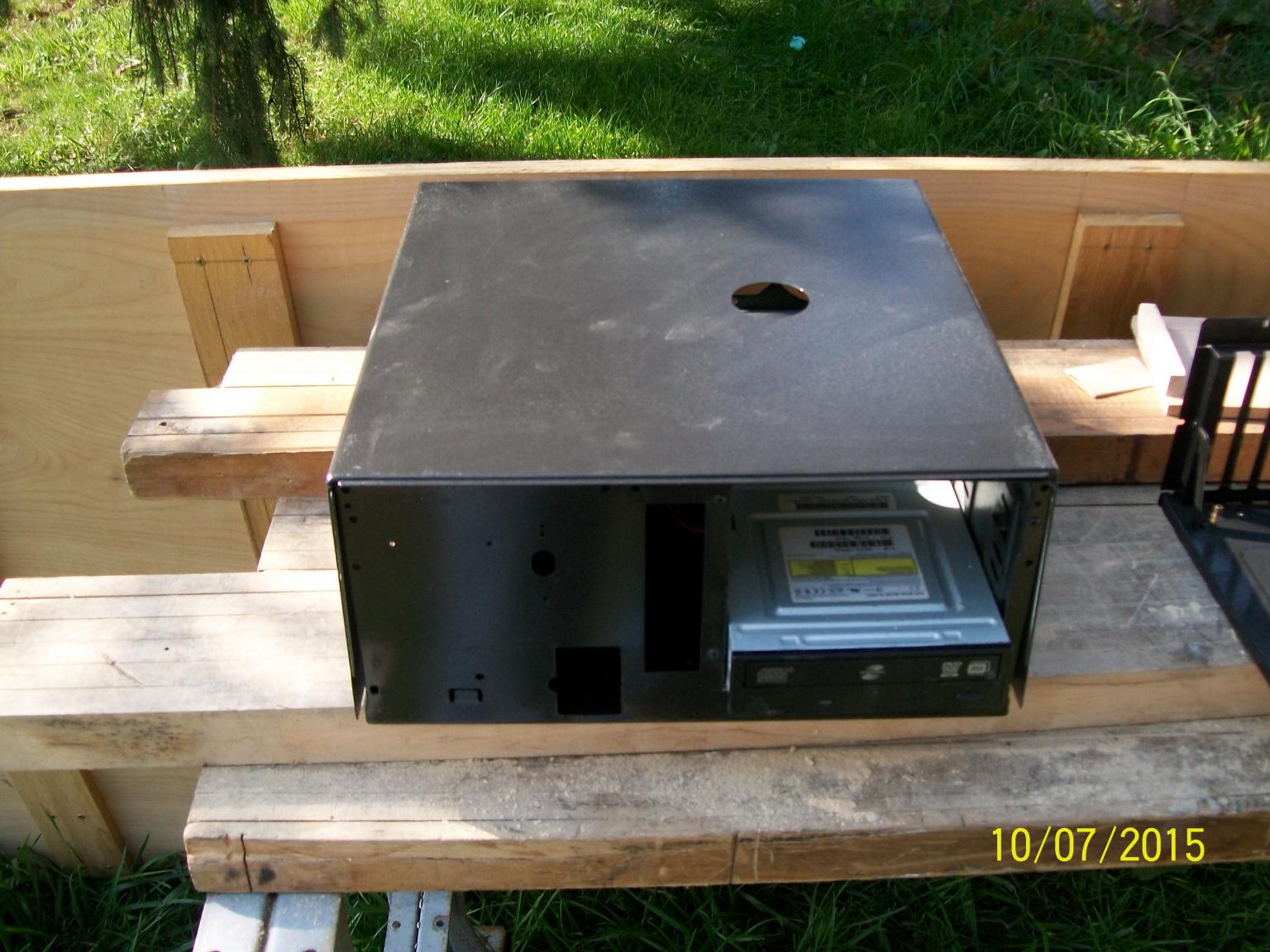

October 7, 201511 yr Author comment_62773 Here's the old AT case I'll be using for the lower half of the case. The hole in the top is for routing wires to the motherboard. The lower AT chassis that will house the power supply, and drives. Here's the ATX motherboard tray I'll be using. A test fit of the Oak frame to the AT case. The ATX motherboard tray in the position it will be mounted. I'm making Oak slides for it to fit into that will be tied into the front frame. Report

October 9, 201511 yr Author comment_62805 I managed to get the motherboard tray side frames assembled, and test fit. Here's a few photos of the progress. This view shows the tracks and mounting tabs for the motherboard tray. This view shows the side that will show on the outside of the case. This view shows a test fit with the motherboard tray, and front frame on the AT case. This is a top view of the test fit up. Still a long way to go! Report

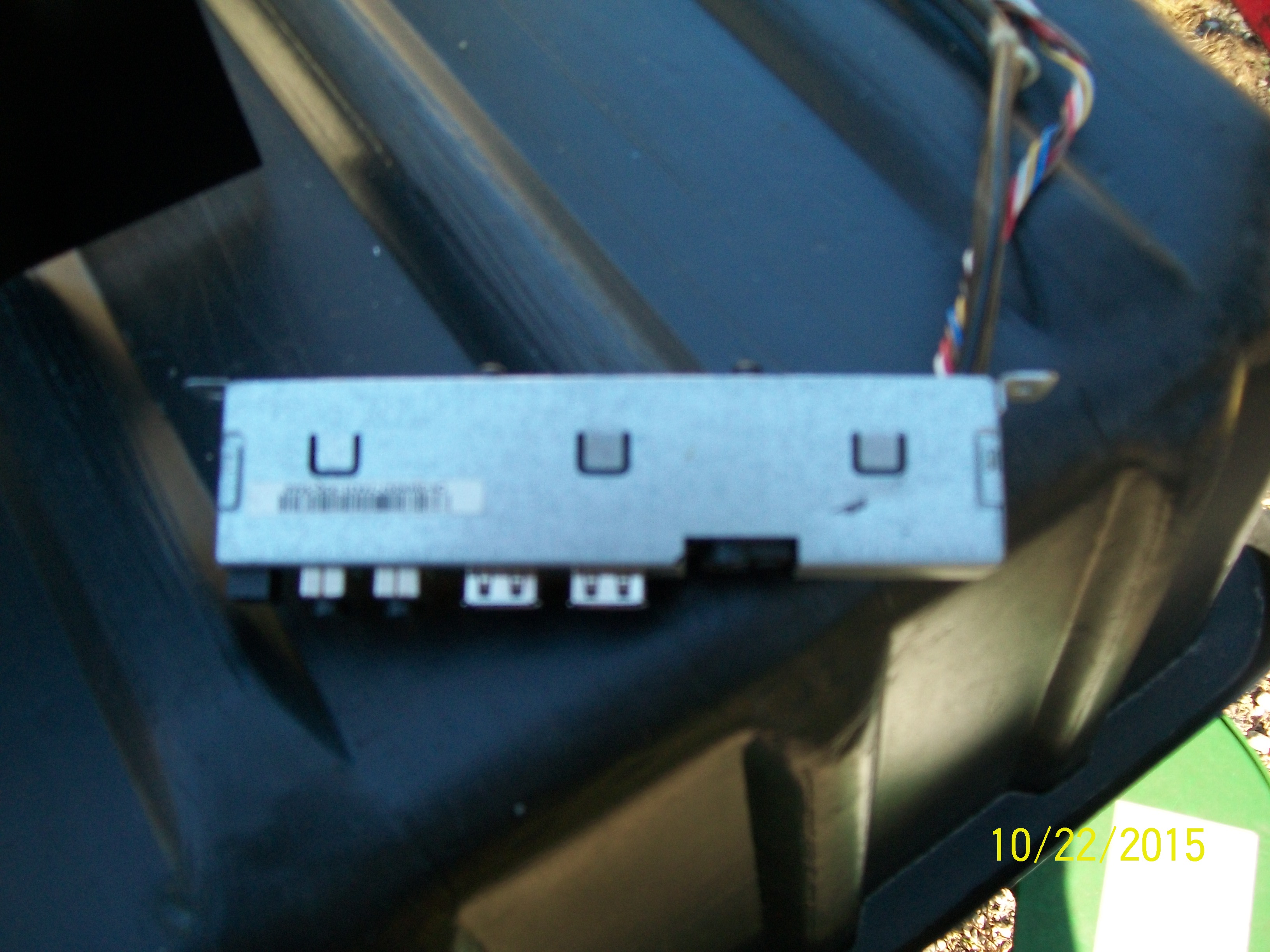

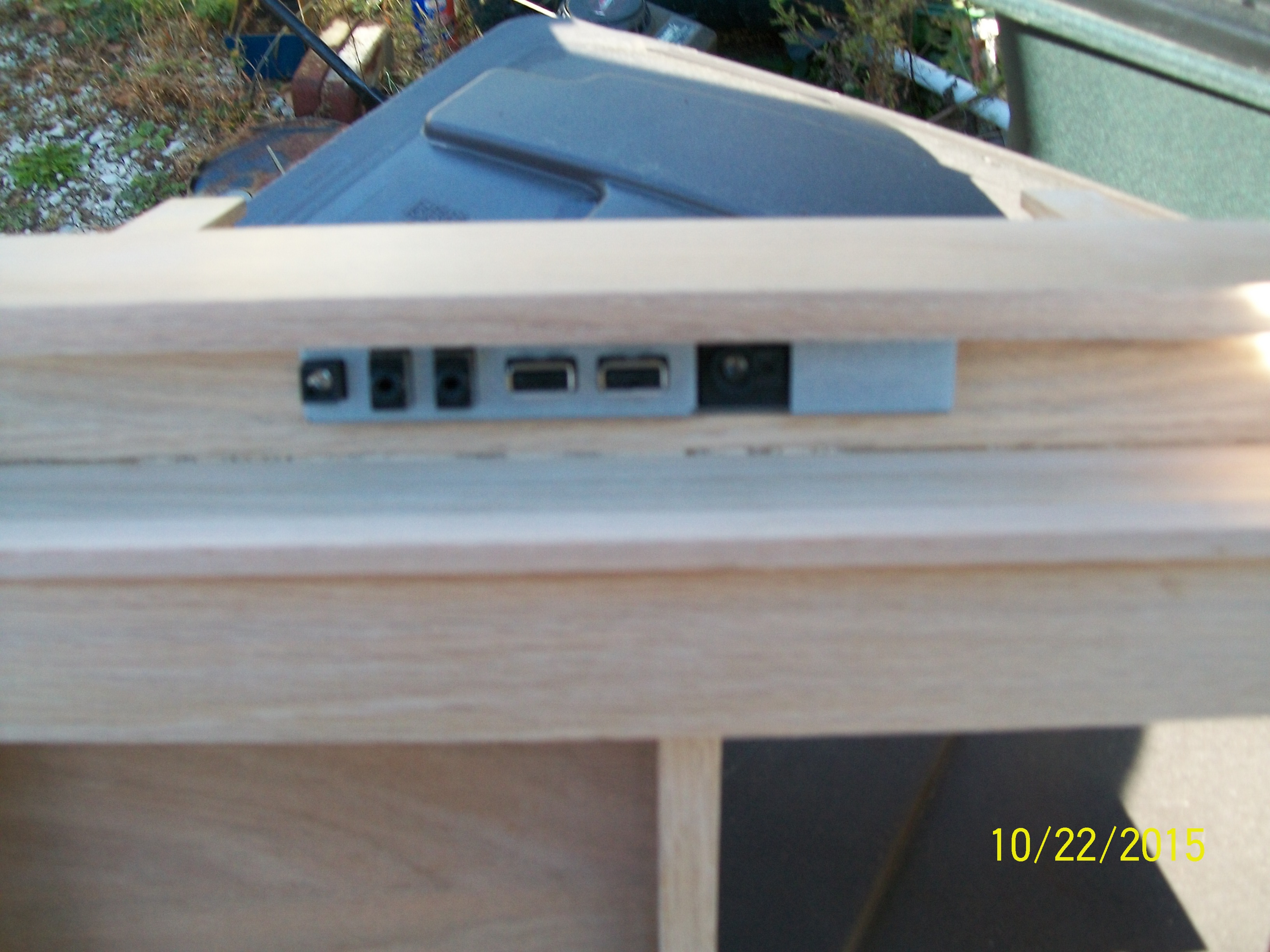

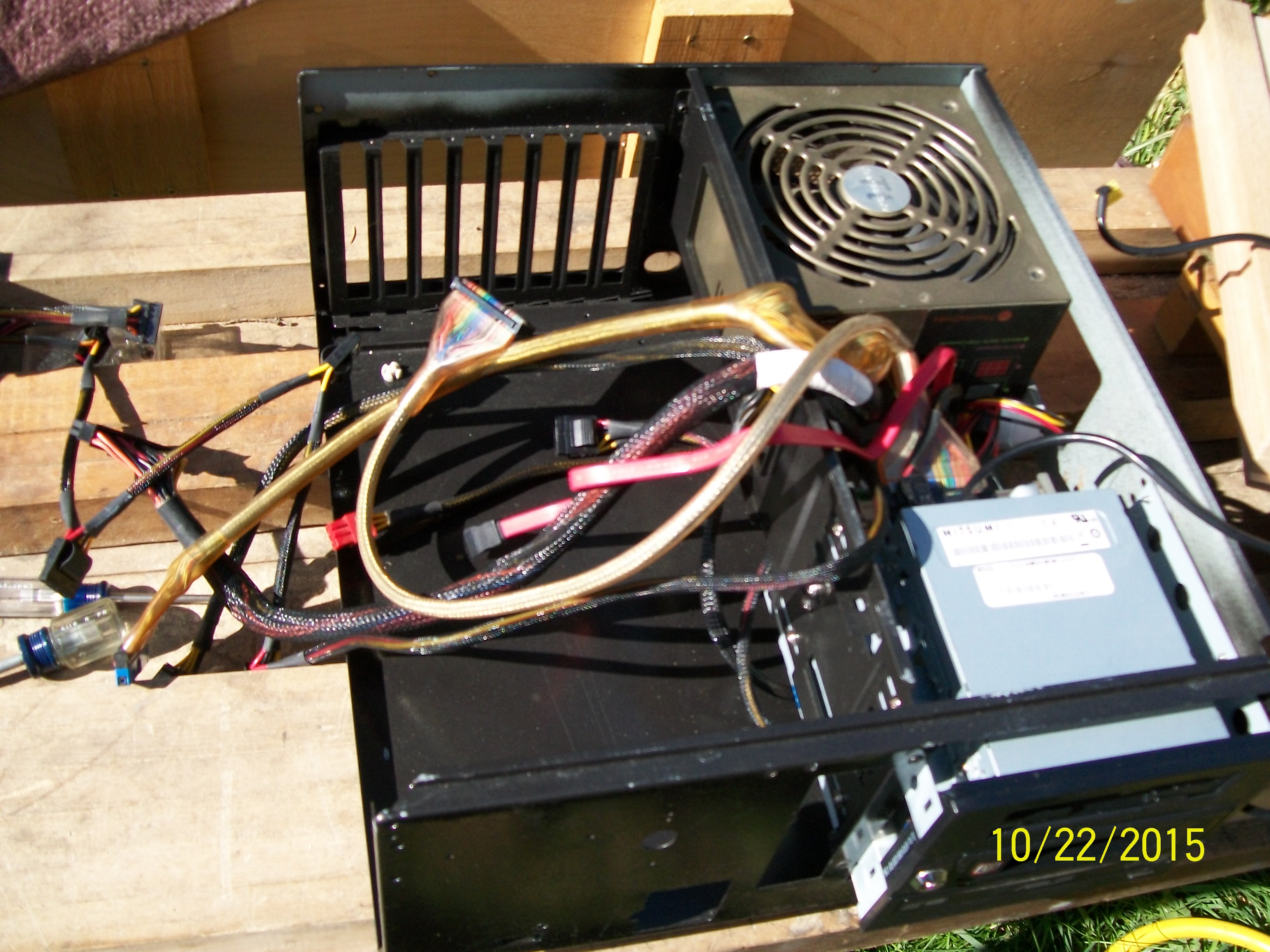

October 22, 201511 yr Author comment_62967 Ok, after my recovery from a 3 day knockout punch from "Vinnie the Virus" I've managed to get a bit more done on the old Komputator. Before "Vinnie" put me down for the count I scored a few parts for this from my local metal recycle yard. First was this power switch, dual usb, audio, and led panel from a Dell Vostro PC. It required a little modification work for easier installation into my homemade case. As you can see I removed the top set of original mounting tangs, and added another 90° tab for mounting purposes. I simply soldered the tab to the metal housing. The following 2 photos show the assembly installed in the wood case. There will be mounting screws in the two tabs. I also installed the power supply and drives in the old AT lower part of the case. That mess of wires comes out here. And then gets covered with the ATX motherboard tray, and Asus M3N72-D motherboard. The next 3 photos show the case with the drives, motherboard, and 1 video card installed installed. There will be 2 video cards to support 3 monitors when this is done I'll be making a copper faceplate for the switch, usb, audio, led panel. I'll also be making an upper case with beveled glass front, and mirrored sides but I'm now at the point of loading an OS and doing a burn in run before I do. After the burn in run I'll be adding the copper finned Thermaltake orb coolers to the memory sticks, and video cards. So, I''m off to load a couple OS's to bring this old beast back to life. Report
