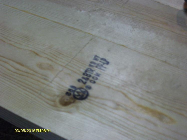

Ok, time's up, time to surface the top.  Found a couple marks that just had to go, though
this and a neon green crayon mark.  Hmm, sand them off?  Nah, we have ways of dealing with this..
A Stanley #70 Label scrapper plane. Notice that the black brand is gone?

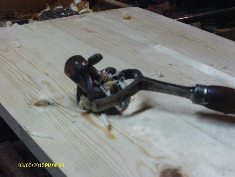

Got after the surface with a few other planes. From the 22" long Try plane down to the #3 sized #122.

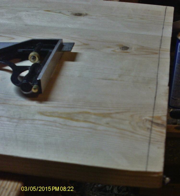

Marked out for a bread board edge's tongue

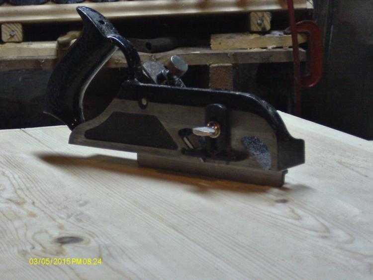

Set up the Wards #78
To cut each section of the tongue.   About...1/2" wide, maybe 1/4" deep.    More of them dang knots, too.   Anyway, here is what it looked like when done

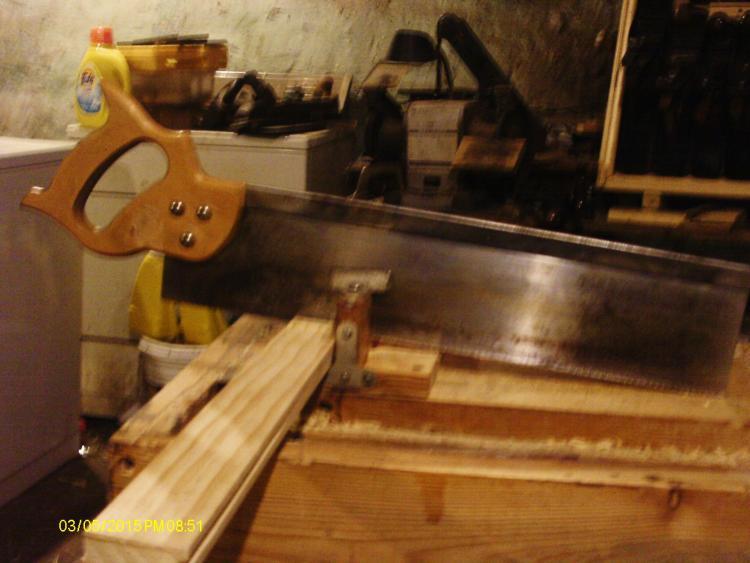

Next, found some 1x3 that needed planed down a bit and cut to length.   Cut two sections with a high tech mitre saw
GEM mitre saw.  18" backsaw did not take very long to make the cuts.  And this is where I should have stopped for the night....but

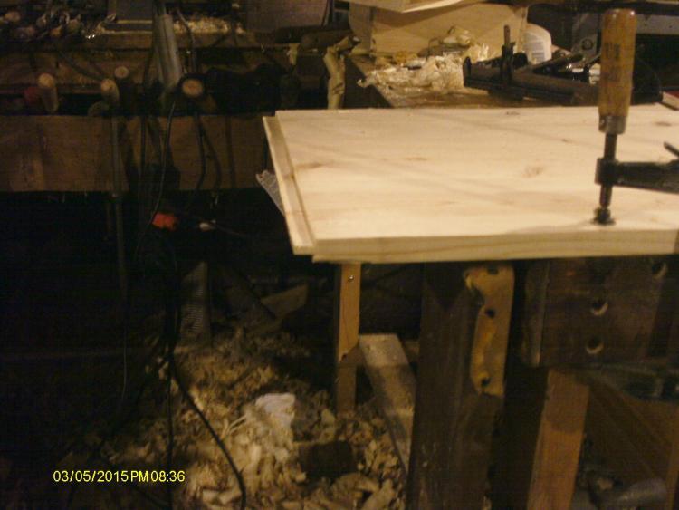

Those two 1x3s needed a groove to match the tongue. I thought to use the old Plough Plane to cut the 1/4" wide grooves.   Set things up, tried different ways to hold things in planes.  Plane was not helping matters.  Setting won't hold, iron won't cut, stuff getting knocked around.....#@#$#@@#!! Plane went flying to parts unknown, never to return.   Dragged out the Craftsman router, dug up the edge guide, and even found the 1/4" bit!  First jig....still hitting the guide fence.   That part of the jig joined the plough plane in exile...

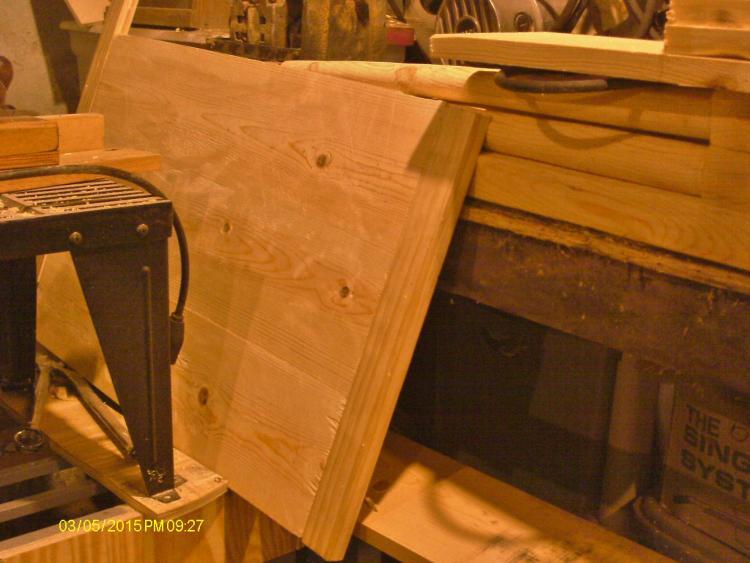

Finally, a bench dog along one side, a drywall screw head at the end of the board, with a second one along the guide side cutting barely into the part.   Three passes to get the right depth AND a centered groove.  After a few test fits..
post-3502-0-05230400-1425612730.jpgI'll fit the second one tomorrow, I am dry as a .... and plain tuckered out.  Maybe tomorrow I can try to get the aprons and the legs to go together?
