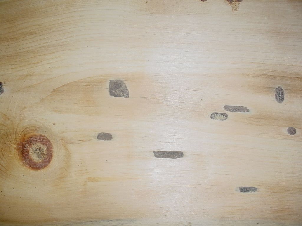

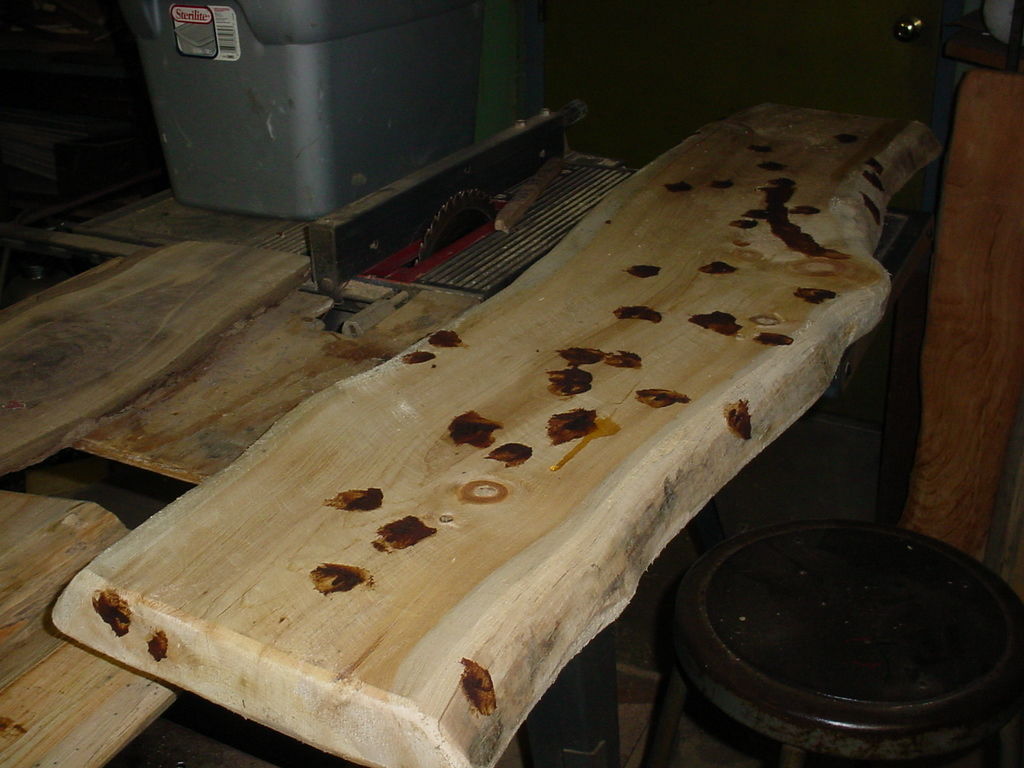

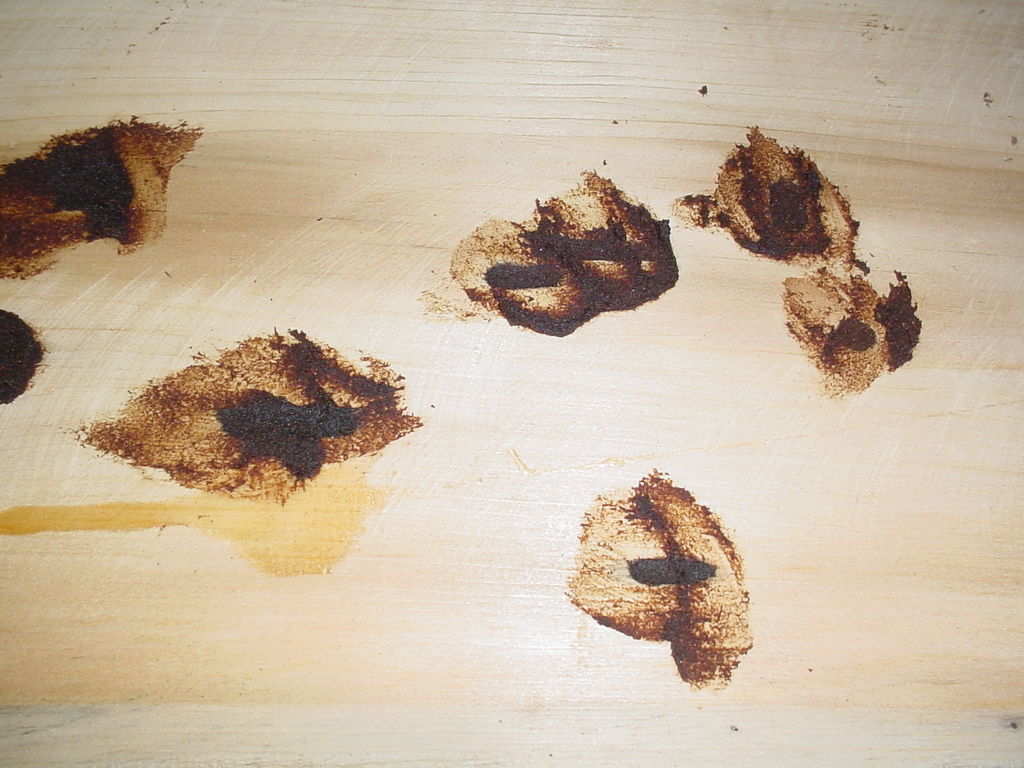

I make slab benches and tables mostly from white pine.
The pine Beatles makes lots of tunnels in my wood.
I like using red wood sanding dust to fill my holes.
It makes them stand out. I give up trying to hide them.
