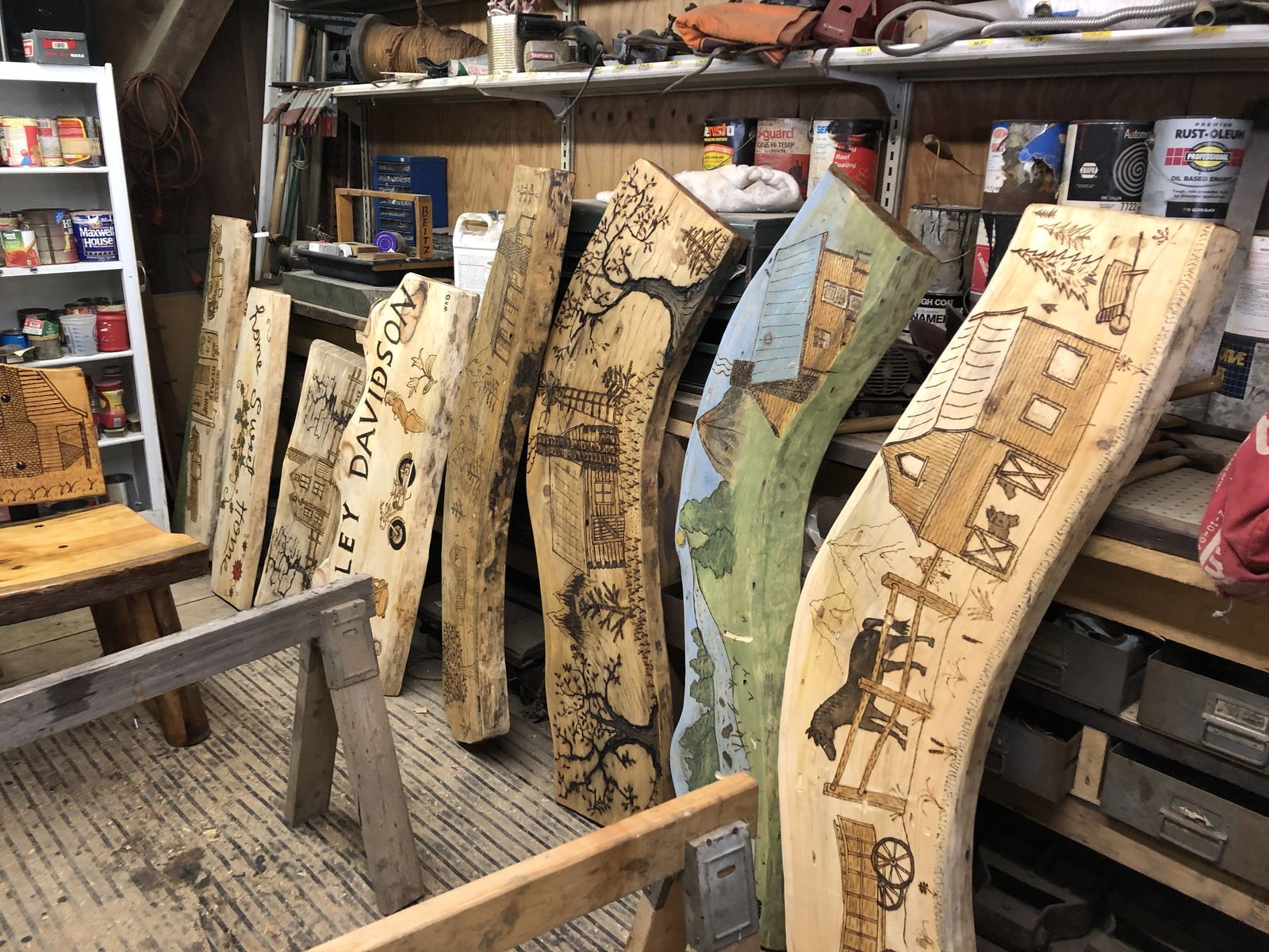

Wow... Thanks for all the info... My main wood working projects is live
edge benches. I need to clean up old rotten holes and chain saw marks.
sometimes I make a fake live edge when I need to split a log that's to
big for my mill. Here is a few of the backs of benches almost ready for
assemble.
And that's some fantastic work your doing smallpatch....

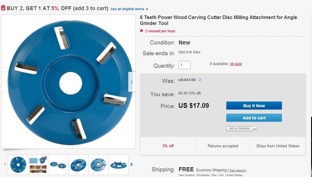

Ouch... I just bought this off E-bay... Looks almost the same...
Same as what ?  Arbortec has 4 round carbide teeth and will leave a sand free surface. This looks like the teeth are brazed on like router bits. Let us know what the surface finish looks like.
You probable right. What I got might be good for roughing something out.
Here is a close up of both sides...
