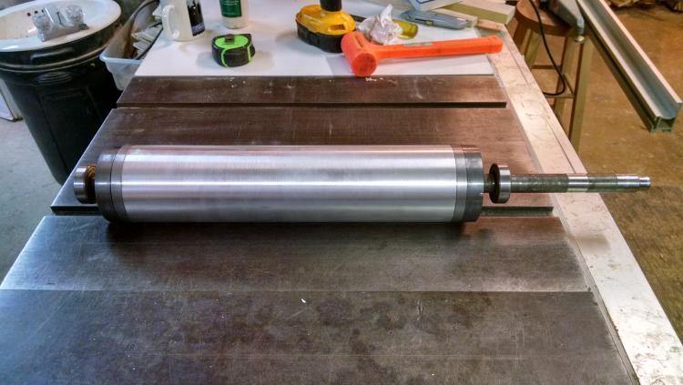

Before Christmas when I was using my drum sander for making gifts I decided to take it apart after Christmas for a little tweaking.  When I got it the table needed to be made parrellel to the drum (fixed), I found out that it works better with a dust collector attached (so far), but the biggest problem is that the drum is about 10 thousandths out of round on the outside end.  This makes a vibration when used on that end, and it doesn't allow the full use of the sandpaper around the drum.  This is what it looks like right now.
My plan is to take the drum to my cousin and have him remachine it, reinstall it and tune everything up.

Hey ron, yes it vibrated on the one side since it was new.  It doesn't have very many hours on it.  I put a dial indicator on it when it was in one piece and there was 10 thousands difference in the diameter on the outer side.  Before we turn it we'll chuck it in the lathe between centers and double check with another dial indicator to see, but I feel confident that thats what the problem is.  I don't think its sawdust in the drum John, my drum is sealed on both ends with a steel plate that holds the aluminum drum to the shaft.  John there is too much material to take off with just sandpaper.  The best way to fix it is to turn it on a metal lathe. The table is adjustable itself to be able to make it parrellel to the drum.  Thanks for the thoughts, will keep you posted what happens.
Sounds like you may have a bent shaft Paul.  I agree with indicating it between centers to figure out what the root cause is.

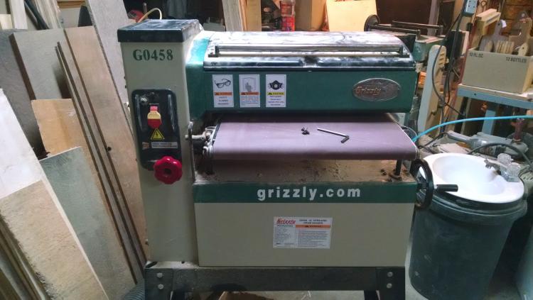

I got my sander drum back from the shop this afternoon.
When we chucked it between centers, the shaft was good and you could see definate runnout on the open end of the drum.  So we machined it true, the bearings were good also.
Sander completly reassembled and tuned up.
The test runs that i did showed a huge difference in the sanding on the open end.  Also it appears that the sandpaper is being used all the way around the drum.  My test runs consisted of a 6" wide piece of hard maple, 6 fpm, and about 1/128 of an inch cut.  I'm also going to continue using a bigger dust collector on this sander it see if that takes care of the burning.  I am also open to any feedback anyone else has using a drum sander.  Thanks, Paul
Paul, glad you got it working but I have a couple of questions.  How many thousandths did you have to turn off to get it true and how thick is the wall on the drum now?
Hey Ron, I think we took off about 20 thousandths.  I believe there also was a taper to the drum from side to side.  Not really sure how thick the wall is now but I believe that there is plenty of meat there.

.020 is just a skin cut Paul.  Y'all did good and it clearly was the right thing to do.
