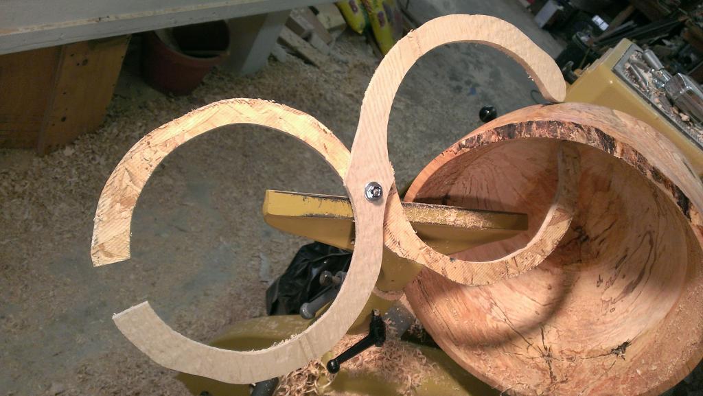

October 25, 201412 yr Author comment_55735 Hmmmm How to know what my wall thickness is? There's gotta be a way: Oh Lookit~!! there's some of that exterior sheathing left over from my shed build. It's like OSB but oodles stronger & pressed under enormous pressure and glued together better. It's really strong in all directions. That'll do All the stuff I have read tells me that this is a little thick. But I think I like it because of all the fracture points in the wood on this piece. Thicker will be stronger assuming I don't split the piece. Or maybe it's an excuse to try out my new carbide insert negative rake scraper tool. It's also an excuse to order a 36" length of 1" bar and bend it to make a deep, deep bowl turning rest. Yah I got a plan on how to bend a 1" bar into a 4" radius.. I ordered some pentacryl so maybe ~ ~ ~ ~ ~~ ~ Meanwhile in between turning it looks like this after I wet the whole thing down Report
October 25, 201412 yr comment_55736 I made a similar caliper from Masonite. I Think Craft Supplies USA has a similar version but not as large. When I was still working at the school, I had the welding kids make me two "S" tool rests similar to http://www.kmstools.com/maxwood-9-s-shaped-mini-lathe-tool-rest-9239 . My Delta lathe uses a 1" post. I had the "S"s made as mirror images. One for the inside of the bowl, one for the outside. Mine are only 6" or 7" end to end and made from 1/2" diameter stock. I really like the Saran Wrap idea. My only concern for what you have setup is that the moisture from the wood might rust your faceplate/chuck mounting. I left a piece of split walnut in my chuck while I completed another project. When I returned to the walnut, the chuck had rusted so badly that it would barely operate. Had to completely disassemble it, wire brush and emory cloth it. The surface is still pitted but it functions OK. Report
