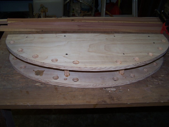

I got the carcass cut out and put together this week along with the top.
ning-100-3442-53815-73.jpg?width=721
The holes give me a place to clamp the Baltic Birch that I will kerf cut and attach to the front.

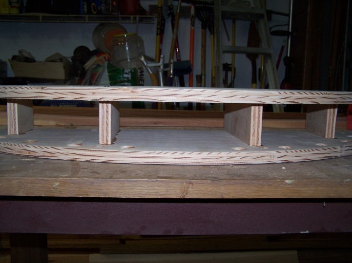

ning-100-3443-53815-17.jpg?width=721
Front view

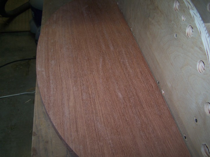

Started smoothing the top out with my scrapers.
ning-100-3445-53815-33.jpg?width=721
I got some tear out when it was run through the planner. I had to take it to a friends house to plane since mine is only 12" and this is almost 13" wide.
It is looking good and will get it smoothed out this weekend.

Looks really good John, let me get this clear, what we are looking at is the actual top you are building? Only you built in the clamp holding holes to make the install of the bow front easier? That is really cool man. I never though of building clamping fixtures into a project like that.
