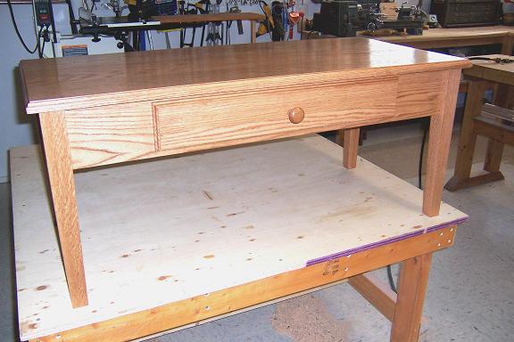

Larry, what color is the stain on this table?
Larry Jenkins said:
John2..
We talked earlier about pre-finishing.  Here's an image of a coffee table I designed and built for a customer.
All parts were pre-finished before final assembly.
I'm looking for an older article I wrote about how to do this.  If I can't find it, I'll re-write it and post it here.
Larry
None.
They wanted a very simple coffee table without any top edge molding; no tapered legs and no stain.  Wipe on poly, rubbed out as previously described.
Larry
Well it looks great. I thought it might have some stain added but I really like it. I know what you mean about plain I have a few of those request also.

I actually made two of  these for different customers.  The one in the image above has tapered legs, an Ogee molding on the top and drawer and has a Cherry stain.  Wiped-on Satin poly, rubbed out.
Great eyes, Sir..
Larry
