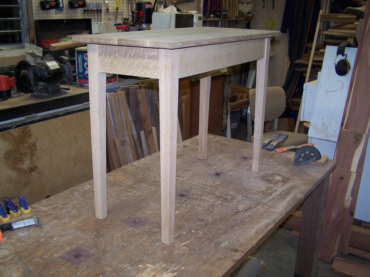

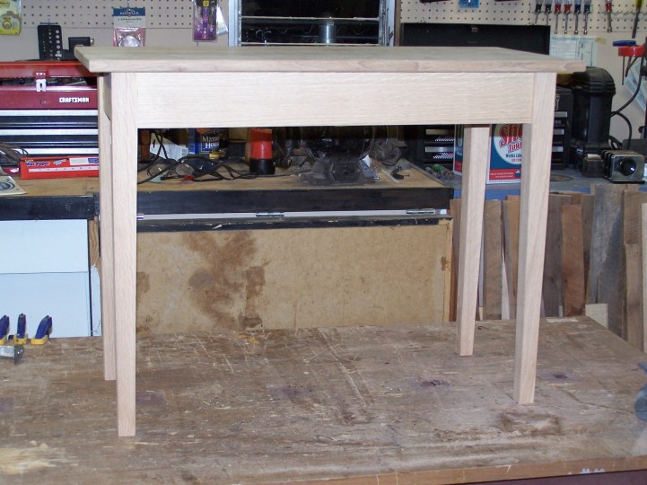

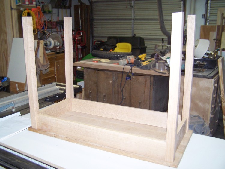

Just a little update, I got the table sanded and glued up last night. Hopefully I will get some stain on this coming weekend.
This time it is right side up.
ning-100-3875-46727-65.jpg?width=721ning-100-3877-46727-17.jpg?width=721ning-100-3876-46727-74.jpg?width=721
Thanks for looking. I am getting it to the finish, just slow.

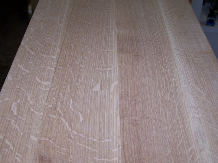

Good questions Dan.
QSWO is quarter sawn white oak. If you look closely at the top picture, the growth rings on the end of the boards are running almost vertical.
