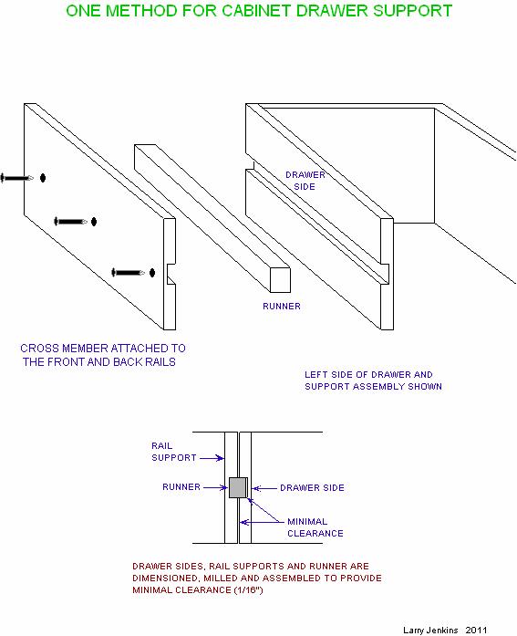

Dan..  When I design drawers, I like to cut grooves in the side panels that ride on their male counterparts that are attached to a drawer frame.  That way, you can design in some latitude so the drawers will float without binding.
If this is not clear, I will draw up an isometric view and post it here.

You lost me there. A simple drawing might help.
Thanks
Larry
Dan Shuflin said:
So, I have seen drawers made of solid wood. What keeps them from splitting?
Here it is Dan..  Just got it done.
This is my favorite way to suspend drawers in a cabinet to prevent binding as the wood "moves."
Larry

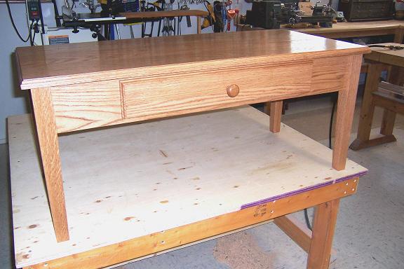

John2..
We talked earlier about pre-finishing.  Here's an image of a coffee table I designed and built for a customer.
All parts were pre-finished before final assembly.
I'm looking for an older article I wrote about how to do this.  If I can't find it, I'll re-write it and post it here.
Larry
Thanks Larry, makes sense now.
Dan
