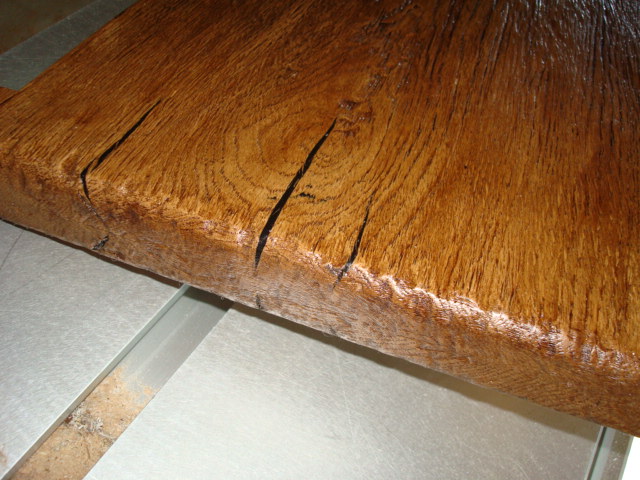

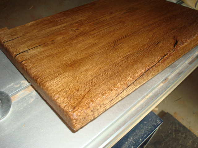

these are stair tred samples I did today with EnduroVar over shellac. Works well and is fast. On my doors I normally use tung oil as the tie base .ning-stairtredsample1-45258-35.jpgning-stairtredsample2-45258-32.jpg

Ace , No adhesion problems to date on epoxy or shellac . I usually abrade , use a glaze to achieve the effect I'm looking for and seal with EnduroVar. Later if wanted ,  I dye subsequent EnduroVar coatings to the tone  required. This has worked pretty well for me. By the way the treds pictured have built up edges and are not thick at all on the tops they just look "solid ".
