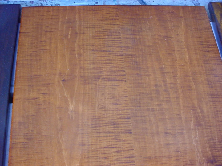

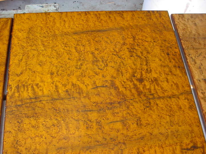

ning-tops-45273-13.jpg?width=721ning-tops3-45273-89.jpg?width=721These are some tops I am doing in water base dye, General finishes clear seal a cell and then general finishes flat enduro var. Sprayed with a 35$ woodcraft sprayer. There are more finishes then just poly guys. Water base is what we will all be using soon. These tops have just 1 coat of finish on. They will be sanded wiped and resprayed 1 more time. The depth and clarity of dyes and finishes do a lot for your project. They dry fast and the smell is nice, not solvent.
