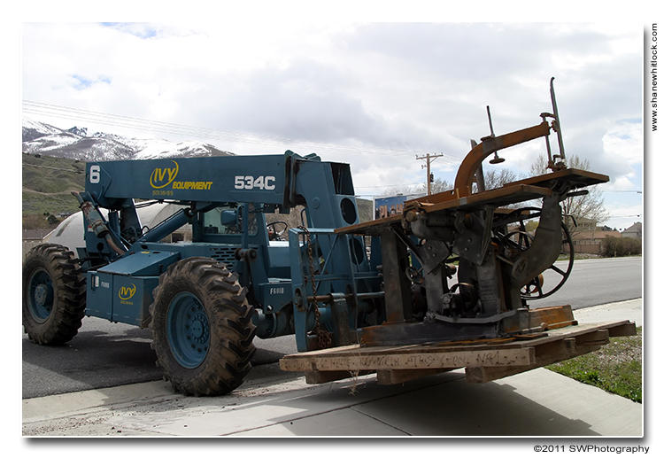

Here's a pic of it before I started. It's been sitting outside for decades rusting away.
Things got off to a rocky start ... The owner had it sandblasted before I picked it up. I told him to not let the sandblasters sandblast any machined surfaces and to call me as immediately after it was done. Well he didn't listen. Every surface was hit, the table tops felt like sandpaper, and he let it sit outside for two days after they were done and you guessed it ... it rained both of those days turning everything back to rust again.
A pic of me unloading it ... look at all that new rust.

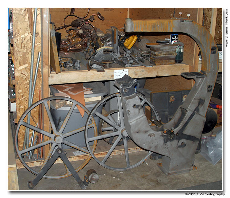

Every part was stripped from the machine, rust removed and then painted or polished.
I began by tearing down the jointer first (using my own jointer to store the parts) …
and finished with the band saw.

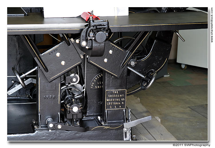

New rubbers for the tires and some gold pinstriping and the machine is finally done, well almost done ... I still need to make some flat belts to run it. Right now I just have some mule tape on it so I can get some measurements.
Nothing looks better than satin black paint with gold pinstripes and polished hardware.

Ron I thought about having the tables ground but even though the sandblaster hit them with some pretty course media you could still see the old planing marks in the metal and they still had a lot of character, so I spent about 4 hours on each table and worked them with some fine grit sandpaper, which I don't recommend doing, followed by scotchbrite pads and steel wool and then topped off with some paste wax. I am happy with the way they turned out.
