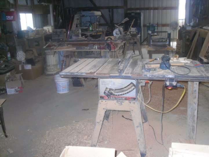

November 5, 201115 yr comment_39558 A Frankensaw.  Was an Emerson/sears number back in the 80s(new), when the trunion went bad (split) I got a second-hand one from a construction company I was working for.  $20 for a whole saw, vs $80 for one part.  Used parts from both saws to make a better, larger saw.   'and may the road raise up to meet ye' Report
