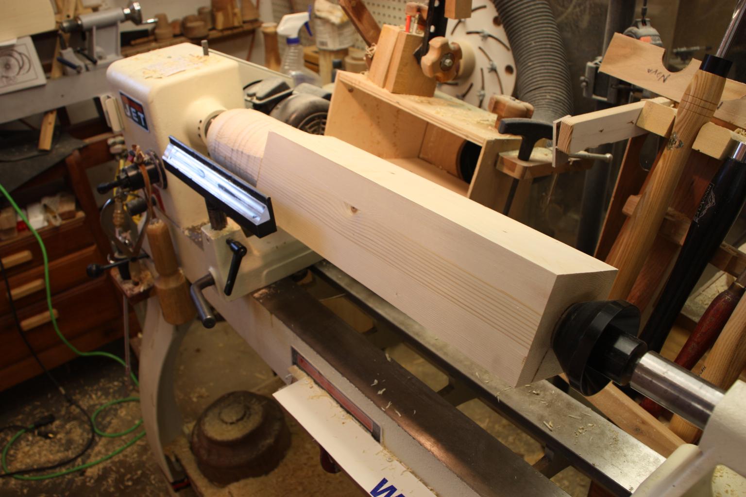

Have to start with a glue up . Did not think I could find 6 x 6 dry pine so here we go with 3 pieces of 2 x 6. Tried to get the knots toward the surface outer edges as these would be turned off. Remember you can never have too many clamps

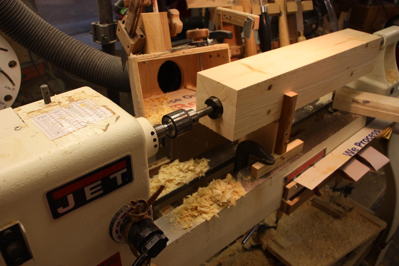

After squaring the blanks on table saw we will need a centered hole to assemble the two parts of the post as this lathe is not long enough to turn as one piece.
Having that hole creates a stabilization problem for turning which is solved by using a cone center in the tailstock.

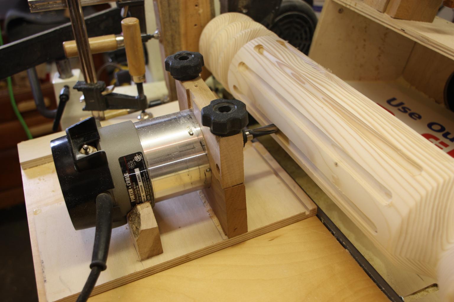

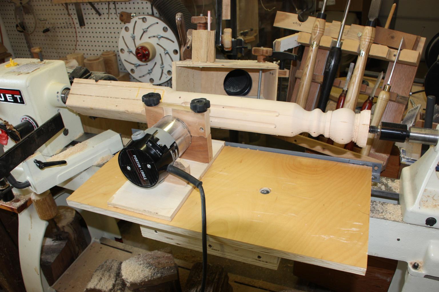

The left picture is the fluting jig cutting the upper post . The right picture shows a closer look at the the jig cutting the post.

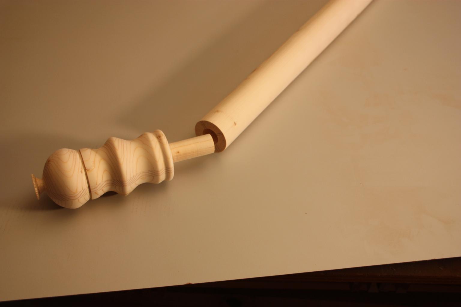

These are the finished post parts with fluting done on one. Right picture shows the connection for the parts of the post.

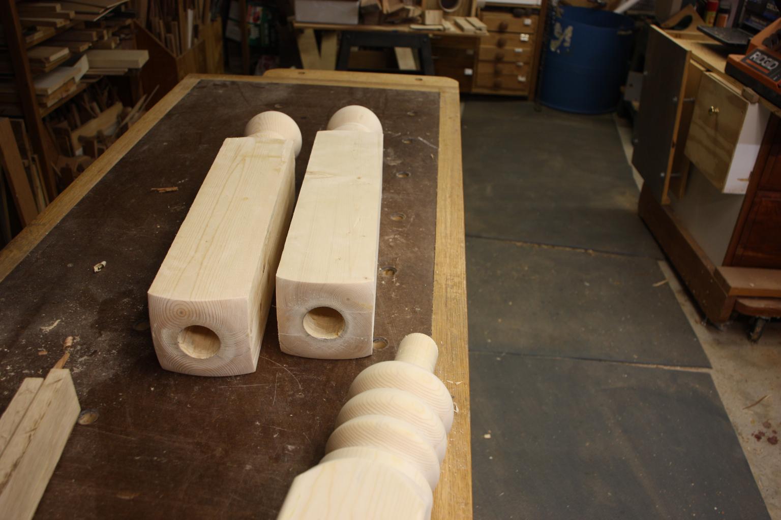

This round turning and finial go on top of the headboard and footboard.

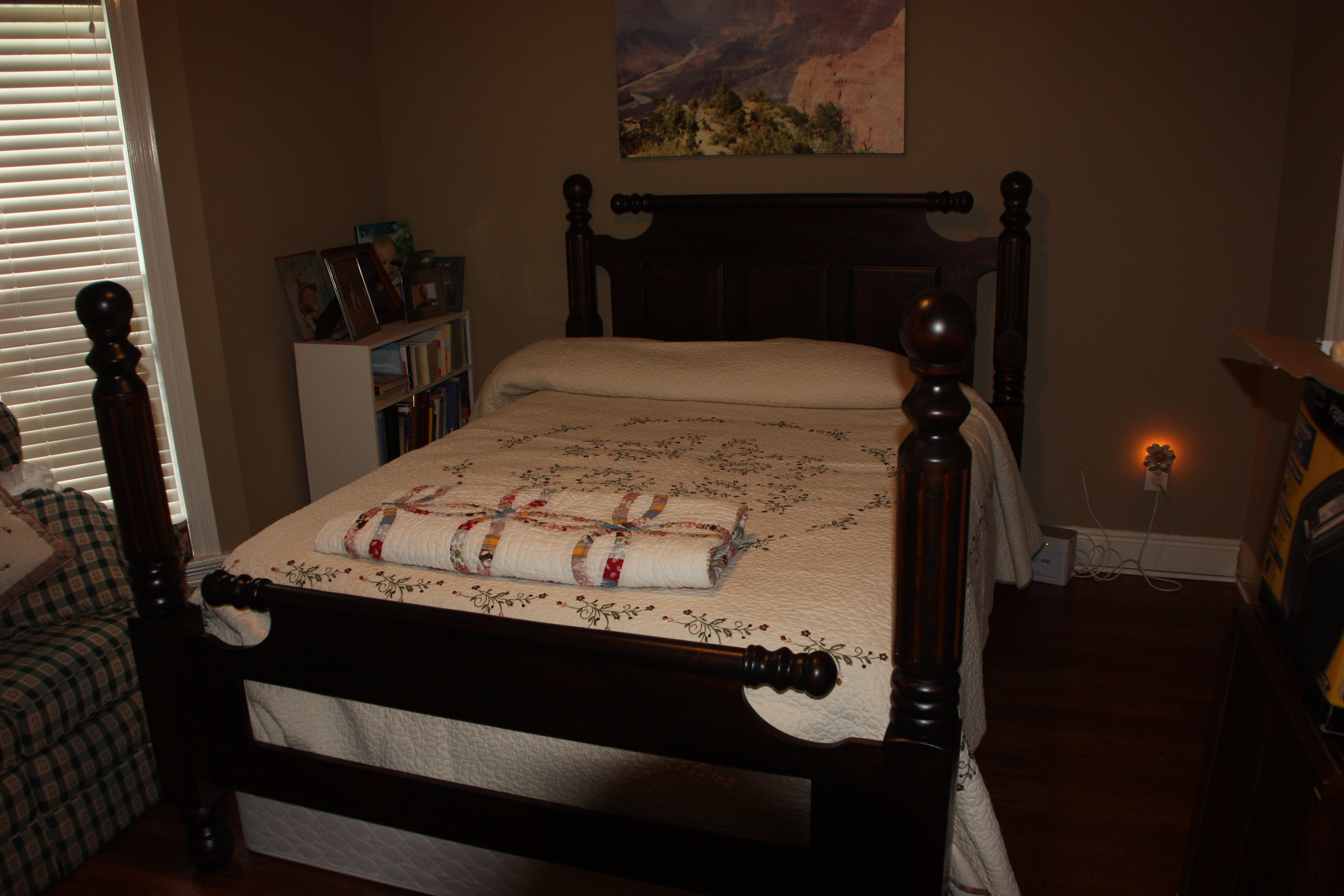

The complete project. Not exact but a close similarity to a bed we lost when our house was flooded over 30 years ago.
