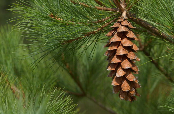

Eastern White Pine cone
Eastern White Pine Cone

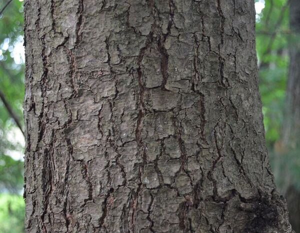

Eastern White Pine tree bark
Eastern White Pine Bark

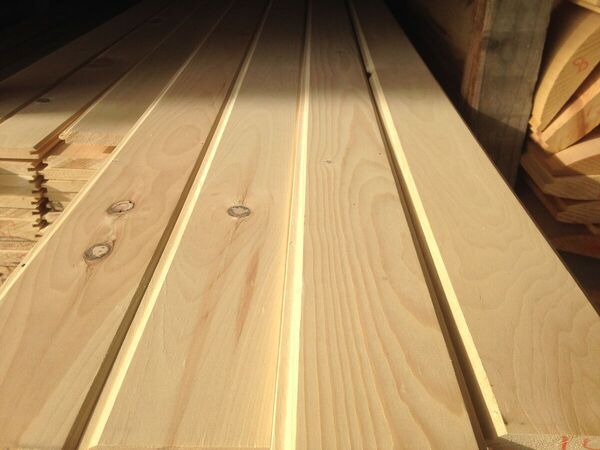

Tongue and Groove pine flooring
Eastern White Pine lumber, used for flooring, sub-flooring or decking, tongue and grooved.
