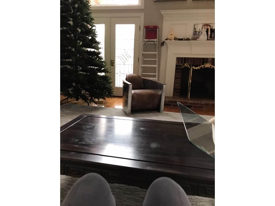

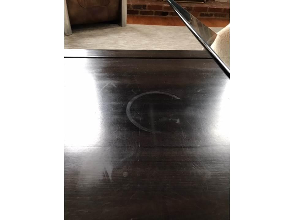

  2. Danl
    Water stain removal
    I friend sent me these pics and asked for help. What does she need to do to remove the water stains from her table top? Danl
