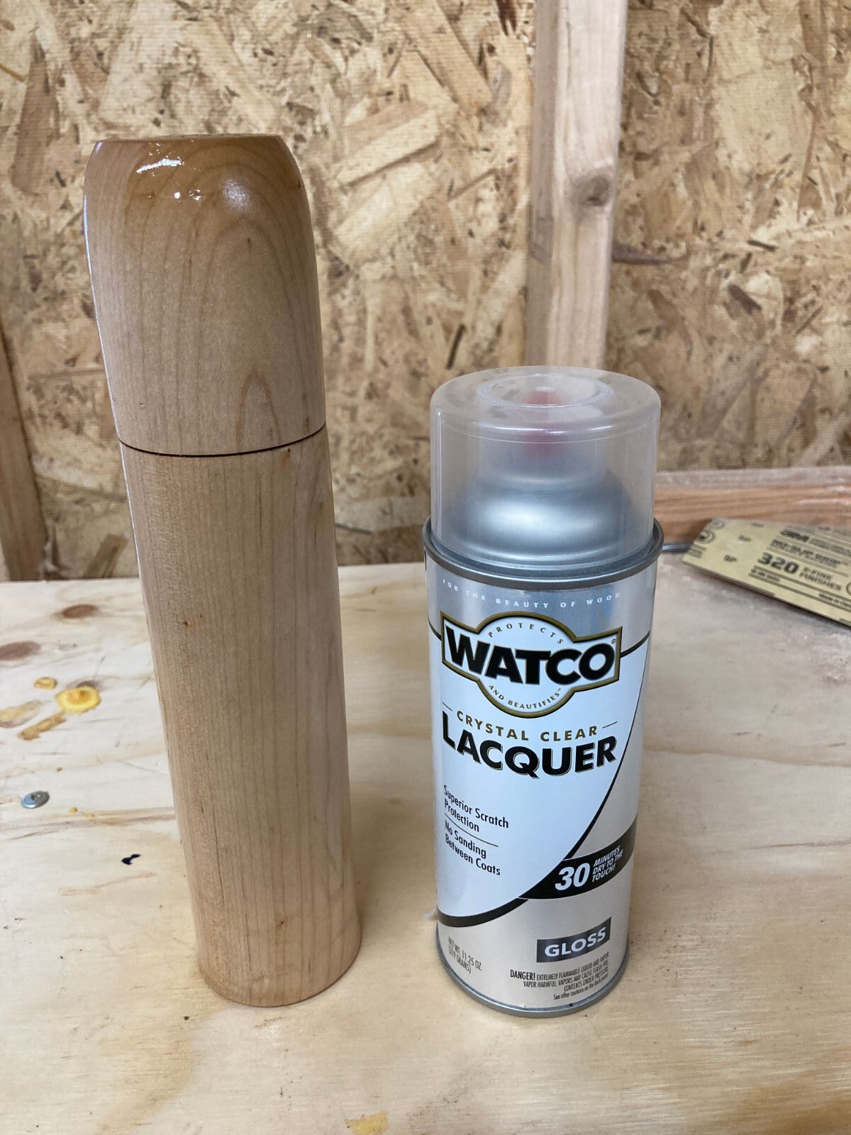

  3. I started this a while back this one is just about finished and getting ready to be put together. I've been putting the coats of lacquer on and there is a huge difference with the sanding sealer staining and then finally coats of lacquer. It has a more sharp looking shine to the wood. Either way this project is a birthday gift for next month so I hope this final product turns out decently. (Yes FYI I'm also considering buying a beading tool).
