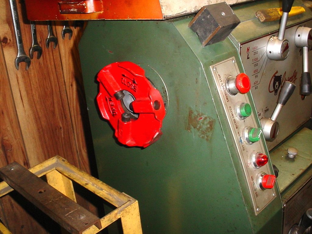

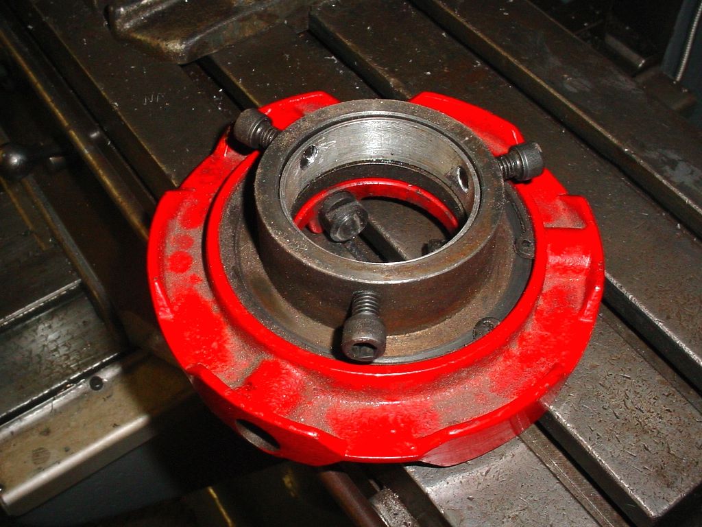

    I was at the junkyard again and I found a newish pipe threading machine. I have no idea what was wrong with it but I striped it for parts. Wondering what to do with the new found parts I came up with this idea. Working with long parts in my lathe things can get flopping around. I made an adapter and put this on the back end of my spindle. It hold the long rods and keeps them from flopping around. I tried it out... Works great.
