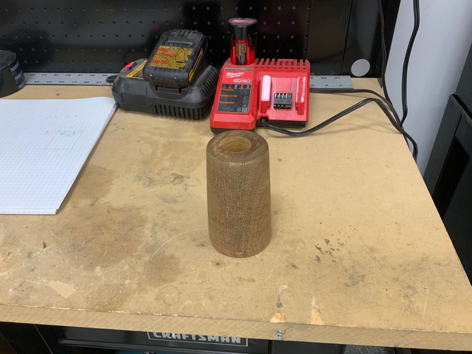

  1. Ron Altier
    IPE
    I'm not familiar with This wood type. I'll bet I've seen it and just thought it was artificial, as most outdoor projects seem to be. I am also interested it playing around with some of it. My neighbor put in a new floor. A beautiful highly grained wood. I collected some of his scraps, thinking I could make some knitting needles on my mini lathe. Everything I did with it was a disaster. It was so darn hard and it splintered easy. I asked what it was and someone said Bamboo. If it was, it sure fooled me. Anyone know what bamboo wood or IPE is like to work with using shop machinery?

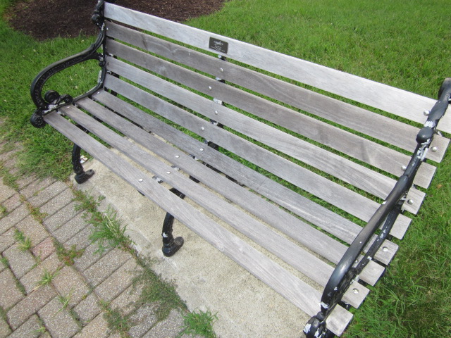

  2. kmealy
    Woods for outdoors
    Good article on outdoor woods: https://www.woodmagazine.com/materials-guide/lumber/outdoor-lumber?cid=369791&did=369791-20190425&mid=20453126205&utm_campaign=wood-online_newsletter&utm_content=042519&utm_medium=email&utm_source=woodmagazine.com I probably have mentioned this before: In the town I moved from 3 years ago, they were looking to replace the wood in the park benches (cast frames). They went to the store that Steve Mickley (prior host of finishing at Wood Forums) and asked for some red oak. He told them, once he found out what they wanted it for, was that he'd put them on a two-year re-order schedule because it wouldn't last outside. He recommended Ipe. They sprung for it. One of the benches was in front of the park that was 100 yards away from my house there and I walked past it 4 or 5 times a week. It was a busy street and I'm sure it got regular sprays of salt-treated slush (the city used to send past all their plows, 5 of them, in a convoy during snowfalls). It aged to a beautiful gray, no great cracking,and no mossy residue that I've often seen on teak. It looked great after about 15 years of nothing. I also had a job once to replace a back support on an Adirondack chair. I had a piece of white oak that I graciously volunteered to do it in. The lady sort of stuck her nose in the air and said, "Oh, this is for a house in Indian Hill*, and the original is teak." "OK," I said. I went to see Steve and he graciously cut off a 2' section that was the right width for me and charged me the $20 for the piece. There were probably six cuts I had to make, all at some angle or bevel and the right dimension that I had to replicate. I think I charged a total of $40 for the material, the trip to the store and the half-hour of shop time. The lady was shocked that it was "so expensive." (sigh) Rich but cheap snob. * Indian Hill is the most affluent part of town where most of the C-level execs at the big companies live, most in 5000+ sq.ft. mansions and 10+ acre estates. I've since worked in a number of them that were some of the most expensive homes in the county.
