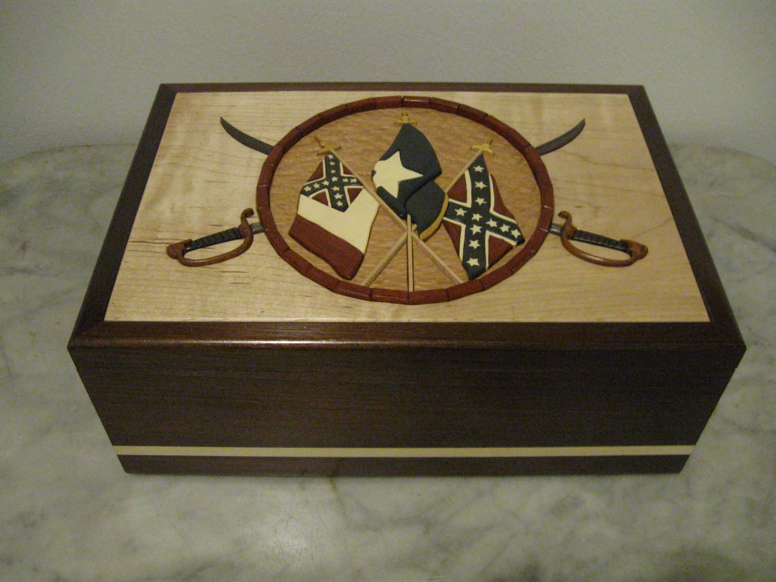

Confederate Flag Intarsia Box
This Custom Box is made from Peruvian Walnut and measures 13" x 9" x 5".
The Custom Intarsia consists of 104 pieces from 9 different naturally colored woods

Beautiful!
I cannot imagine how you made those stars!!

That was exactly what I was thinking when I looked at this.  Amazing!

Thanks guys
The stars were a little tricky to do.I began by drilling a 3/64th hole in the center of each star in the background wood then threading a 3/0 blade through the hole. I then cut out the recess for each star. I then use the hole to do a rubbing of the outline of the star and transfer this to a piece of sticky back label paper to do the cutting of each star. Getting the outline of the star right is the tricky part. Patience is the key to this work.
