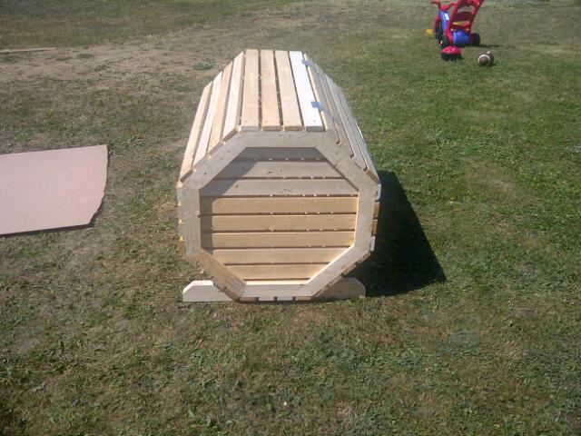

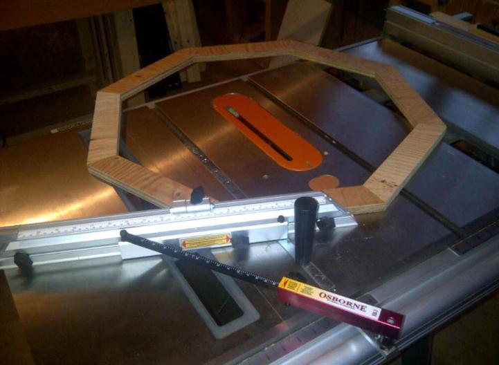

March 28, 201313 yr comment_15153 Whenever possible, we use the EB3 exclusively. Below is Matthew's attempt on the EB3. The second pic which shows an outdoor garbage container, was built 90% by our 15 year old son Tim. I only gave 10% guidance, he did the rest. P.S. Great video John! Michael and Matthew Agate (Newfoundland Canada)Proud Supporter of The Patriot Woodworker and what this great site stands for! Report

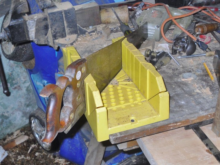

March 29, 201313 yr comment_15139 For thin trim pieces on say a picture frame or other small project I've been known to use my trusty Stanley plastic miter box too. In a lot of cases it works out quicker and easier for me. On frames I cut to the long side too. GregSite hosthttp://www.thesawdustfactoryga.com/ Report

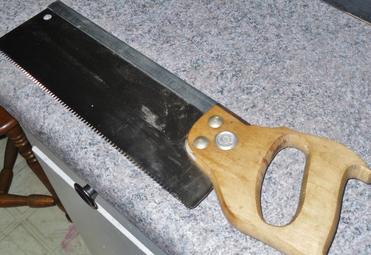

March 29, 201313 yr comment_15137  When I was out at the Pole Barn Woodshop, it was a Delta 10" Compound Miter saw.    I can borrow it, IF I feel the need. However, that hasn't happened for a while, soFor a simple miter cut.   I have since upgraded a saw for the jig50s handle, meet 2013 blade.     All other miter cuts?     lay out a line, and i will cut to that line, with a handsaw. Olde School??? Planer? I'm the 'planer', and these are what I use... Planer? I'm the 'planer', and these are what I use... Report

March 30, 201313 yr comment_15135 you oughtta try a japanese pull saw steve. It'll leave that backsaw in the dust. Report
