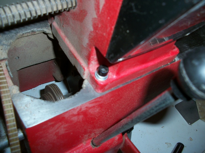

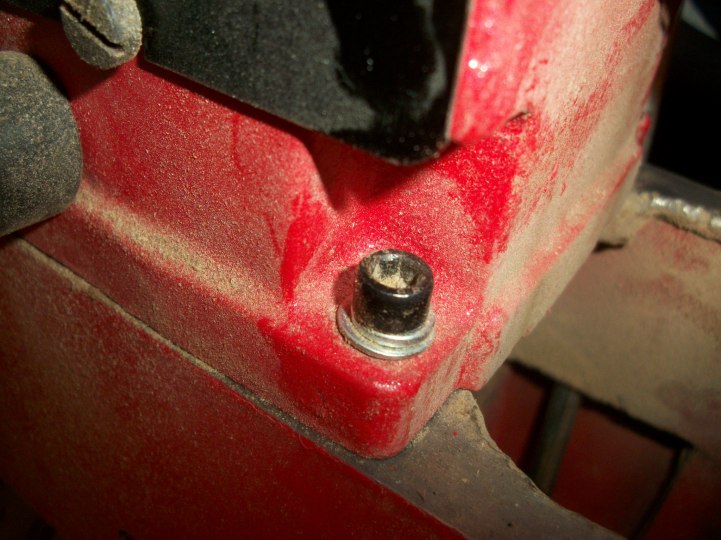

April 12, 201313 yr comment_14711 OK, I was hoping I would not have any issues with removing the headstock, but as usual my life wouldnt be normal without having some sort of issue on everything I do. I am trying to get the headstock removed so that it can be sent in for repair. Problem, They dont make an allen wrench short enough on the common market to get to the screws that need to be removed!  It sort of looks like maybe one can be removed by removing the speed indicator plate but the red painted metal actually comes up over the screws on both sides. I tried a conventional L shaped allen wrench and I also tried the detachable type that can be used with a removeable head driver, neither would allow access. I will try removing the speed indicator plate tomorrow after I get up and see if it makes a difference. If it somehow actually works though, tyhat still leaves the screw on the back side to be removed which has nothing but pure metal blocking access to the screw. Any ideas????  Thanks! Charles NichollsSite Hostnicholls61@att.netProud supporter of The Wounded Warrior Project, Homes For Our Troops and the NRAhttp://www.etsy.com/shop/nichollswoodworks Report

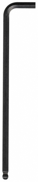

April 12, 201313 yr comment_14710 I've used the "ball" end type of allen wrench to get in tight spots. They are made as both socket and allen wrenches.Harry BrinkBulldog WoodworkingMontana Report
April 12, 201313 yr comment_14709 Grind down the allen wrench until you can get it in the bolt.EAGLES MAY SOAR BUT WEASELS DON'T GET SUCKED INTO JET ENGINES! Report
April 12, 201313 yr comment_14708  Reply by Harry Brink 2 hours ago I've used the "ball" end type of allen wrench to get in tight spots. They are made as both socket and allen wrenches. Harry Brink Bulldog Woodworking Montana  Hi Harry I have heard of that type of wrench but have never actually seen one.     Mike Dillen said: Report
April 12, 201313 yr comment_14707 Charles, You need a Stubby hex key. It has a short leg to get in to tight areas like on your lathe. The one pictured also has a ball end. You can also modify the hex key you have. Cut off enough to fit in the space and use an open end wrench of the correct size to turn it. Cut the short end of the hex key make your own stubby. Report
April 12, 201313 yr Author comment_14706 Charles, it isn't an ideal solution but if you have to use a pair of vise grips or channel lock pliers to break the screw loose. Then you can take it out with you fingers.Ron DudelstonSite AdministratorAbove and Beyond WoodWorks Report
April 12, 201313 yr comment_14705 Like Ron said, the vise grips would be the quickest route, and if you are able to clamp them down hard enough, you'll barely make a mark while turning.John MorrisThe Patriot WoodworkerProud Supporter of Homes For Our Troops and Wounded Warriors Project Report

April 12, 201313 yr comment_14703 Thanks guys that indeed was the solution so now I need to get a box and get it out of here, that will happen Monday. It doesn't fit the large flat rate boxes that I have. So I have to order another style if there is one, which I am doing as I write this.Charles NichollsSite Hostnicholls61@att.netProud supporter of The Wounded Warrior Project, Homes For Our Troops and the NRAhttp://www.etsy.com/shop/nichollswoodworks Report
