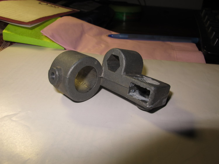

May 27, 201313 yr comment_13041 Anyone know where I might get a replacement part for a Bridgewood bandsaw? I broke the "support" that holds the upper guide blocks and thrust bearing. I could replace it with a Carter product but they cost about half as much as the bandsaw did originally. Thanks Lew Lew Kauffman-Wood Turners Forum HostTime traveler. Purveyor of the world's finest custom rolling pins! Report

May 27, 201313 yr comment_13065 Lew, From what I could find you have an orphan, Wilke no longer manufactures machines. The "support" bracket in your photo looks like quite a few of the Delta clones. JET, Shop Fox,etc.. There is a product called Muggy Weld for repairing cast pot metal parts. It's similar to silver solder in it's use. A good tig welder may also be able to repair the one you have.  Larry Old Woodworking Machinery Forum Host Report
May 27, 201313 yr Author comment_13064 Thanks, Larry. Before Wilke got out of the Bridgewood business, I was on a first name basis with all of the folks there. Not that does any good now. I know I have gotten my money's worth from the band saw and should replace it. It just seems a waste to have to do it for such a small part. Of course I broke it at the thinnest location so that really complicated the welding procedure. As for the clones, I looked at the Carter site and realized there are dozens of varieties of sizes within each of the clone group but unfortunately they don't give actual specification for their units. The same with the Grizzly site. No dimensions/specs on the parts. Hate to order something and not be able to use it. Carter has the upgrade kit for the Bridgewood but it costs half as much as I paid for the saw when I bought it new!Larry Buskirk said: Lew, From what I could find you have an orphan, Wilke no longer manufactures machines. The "support" bracket in your photo looks like quite a few of the Delta clones. JET, Shop Fox,etc.. There is a product called Muggy Weld for repairing cast pot metal parts. It's similar to silver solder in it's use. A good tig welder may also be able to repair the one you have.  Larry Old Woodworking Machinery Forum Host Report

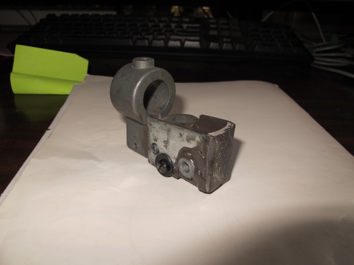

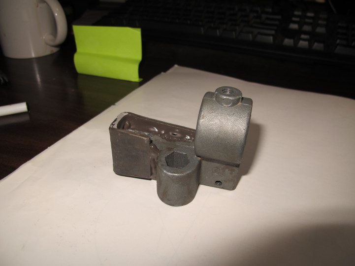

May 27, 201313 yr Author comment_13057 Well, in an effort to get the bandsaw working, at least temporarily, I made a "U" shaped piece out of some steel strapping. It was a little thinner than 1/8" and 1 1/4" wide. Created access holes for the adjustment/mounting hardware and then JB Welded it in place. I'll post a picture of the Rube Goldberg contraption when the Weld sets up. Needed to heat the steel in order to bend it and it bent a little crooked but I think it will be OK.Lew Kauffman-Wood Turners Forum HostTime traveler. Purveyor of the world's finest custom rolling pins! Report

May 28, 201313 yr Author comment_13055 Got a response back from both Wilke and Grizzly. Sent them more specific info including pix and waiting to see what transpires. In the meantime, the JB Weld has hardened but I will wait another 10-12 hours before putting the piece into service. It ain't pretty but it may hold until I can get the replacement. Thanks for all the ideas, suggestions and links! Lew Lew Kauffman-Wood Turners Forum HostTime traveler. Purveyor of the world's finest custom rolling pins! Report
