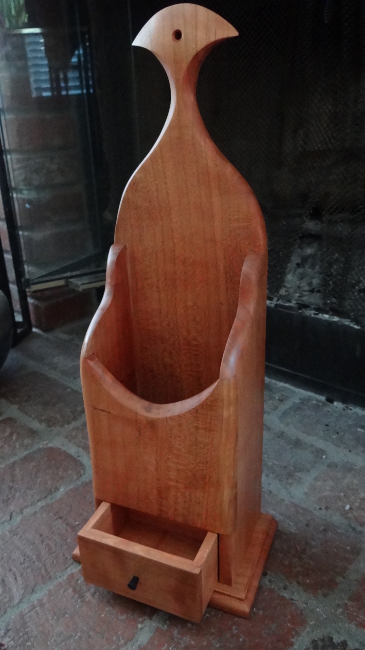

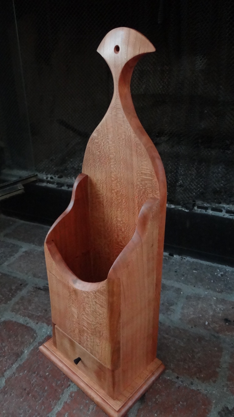

After the getting the parts cut out in the Part 1 post, I sanded the pieces that were going to be on the inside portion of the box area to 400. I like to sand before assembly anything that may be hard to sand after assembly. Once I got the parts sanded, I glued them up and let sit over night.
Once it was all set up, I went ahead and constructed the base and routed a recessed 1/4 round profile around the front and sides, and glued and screwed the base to the box. I used dark colored straight slot number 6 screws. countersunk flush so in case the recipient wants to set the box on a table instead of hanging it on a wall, the screws wouldn't hit the surface. I like using straight slot screws in woodworking, it just seems correct to me, and classy.
Before I assembled the base on the box, I took to sculpting the edges and the upper neck. The upper neck was done with a round file and cleaned up with a half round and then sanded. If I had a cigar shave I would have used it, someday I want to get one, Veritas has some wonderful cigar shaves.
I love the way the lines turned out on the neck,

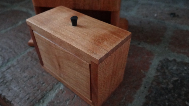

The black knob I sawed off a tiny piece of ebony, and I took a chisel and rounded the portion that was inserted into a hole in the drawer face. The knob is far from being round, but I love it because it's faceted by my chisel and has flats all over it showing that it was truly done by hand.
I wish I had a nice close up of the knob. The tiny drawer bottom is even raised a bit.
