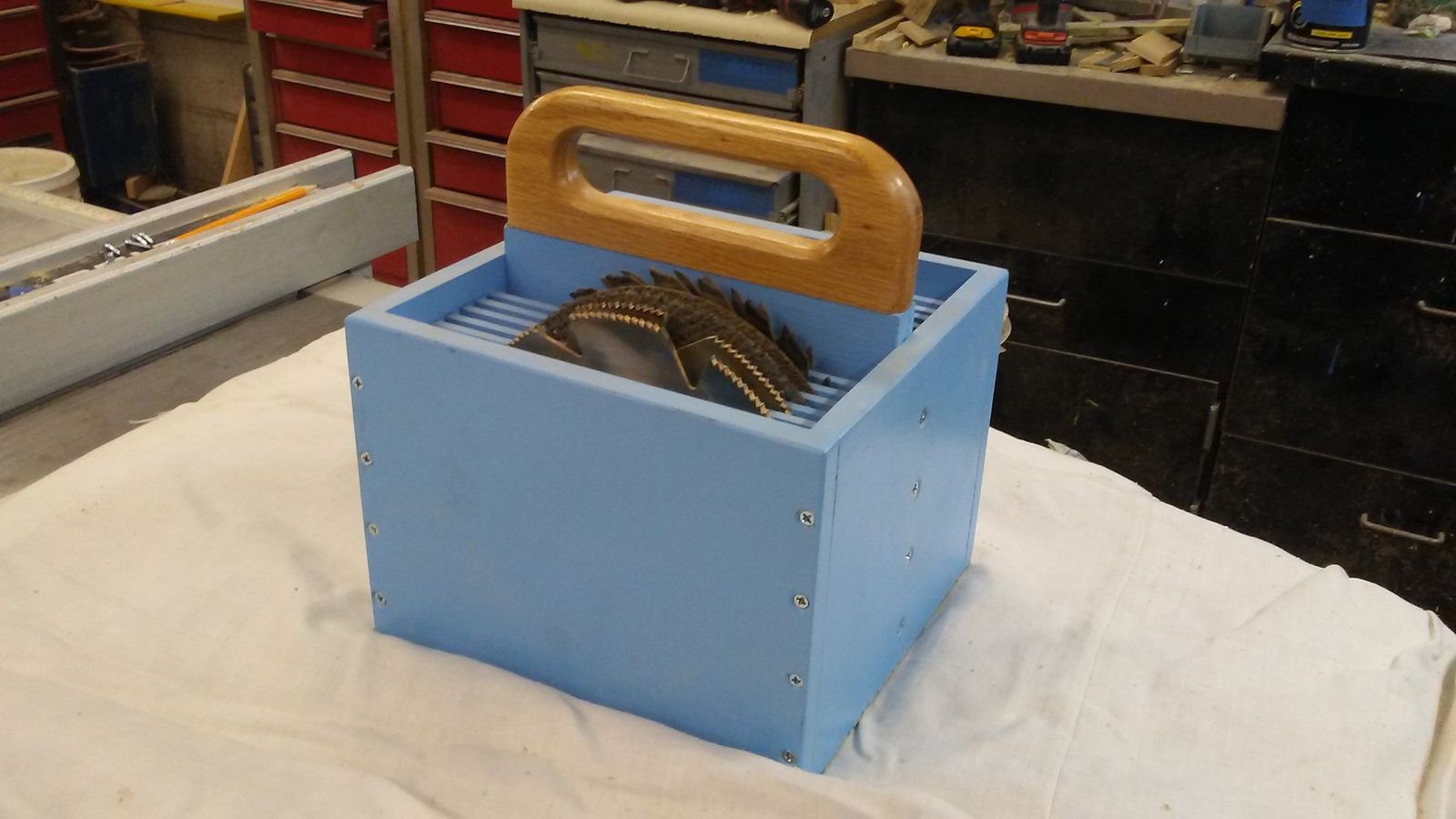

December 1, 20196 yr comment_210878 22 hours ago, FlGatorwood said: It it something like this. Of course, I can't find it as I can't remember the name, but it is easy to slip on and easy to remove. And, it protects the tips when you are retrieving or storing the blade. I use a 16 pack myself. Report
