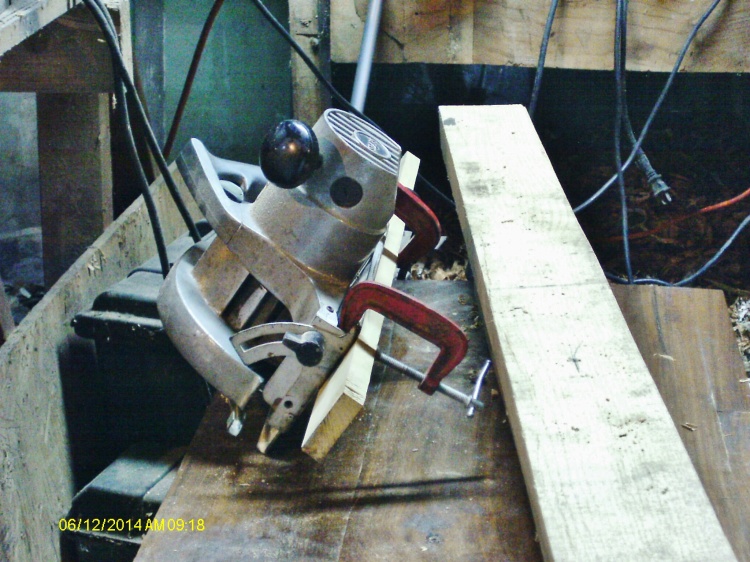

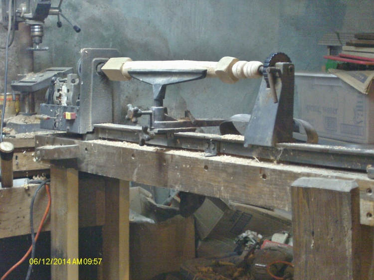

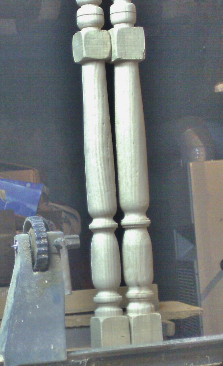

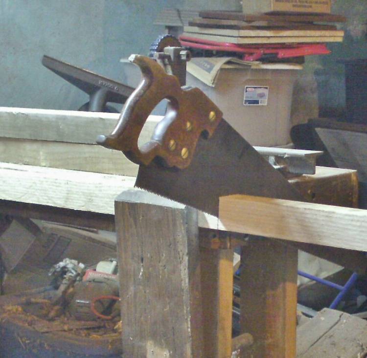

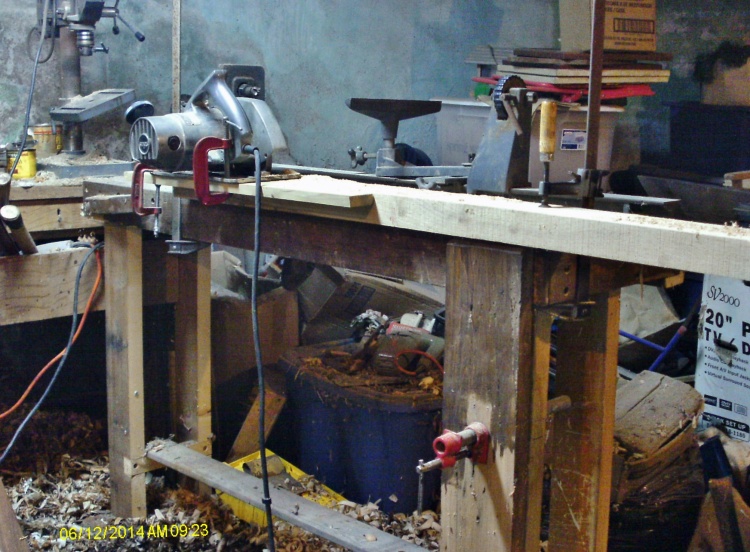

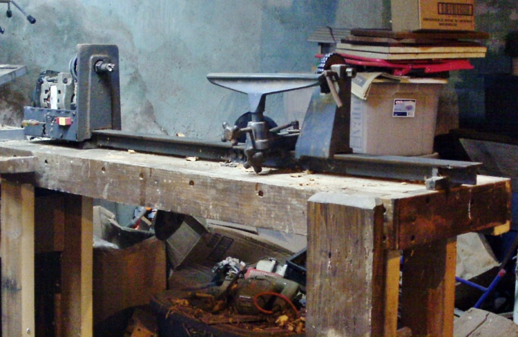

June 12, 201412 yr comment_1749 Needed some legs, and a little treasure, to boot. First off, needed a way to safely rip down a 2x4 of red oak. Table saw is locked up in a barn 20+ miles away. Too far( and I don't have the key) to drive to rip one board. Set up the old circular saw with a guide fence. It will do. Set the fence so the blade was in the center of that board laying there. Couple of clamps to hold the blank on the bench, and make the cut Had to move the clamp on the end, then finish the cut. Now I had two LONG blanks, but needed them to be cut in half at the 23-3/8" mark. Clamped a blank into the leg vise, and, oops, saw still set up for a rip. Well, since I have a decent crosscut handsaw Cuts like butter, now. Ok, now a treasure hunt. Somewhere under a few boxes was a lathe-like contraption Couple of boxes thrown aside, and fight with a plastic bag, but it landed on the bench, anyway. Looking a bit worse for wear. A sander cleaned off the rail. Wire brushed the drive spur. Chucked up a blank to turn And we having turnings going on in the Dungeon Shop! In fact, I was able to turn two legs, then the back started to stiffen up. Lunch time anyway. Nothing real fancy, though. I'll leave one of these on the bench as a pattern,I even had the OEM lathe chisels for this lathe. I also used a Harbor Freight 3/8" gouge to do the coves better. I might be a bit out of practice doing these kind of things... Might, if the back loosens back up, remove the top from the clamps today Been in there a day, might be long enough? Report
June 12, 201412 yr Author comment_1756 Stiffen up on me, sat on the heating pad while "Doing Lunch" I actually bought that lathe at Sears, brand new......in the mid 80s. Cost a whopping $90 at the time, without chisels mind you. Report

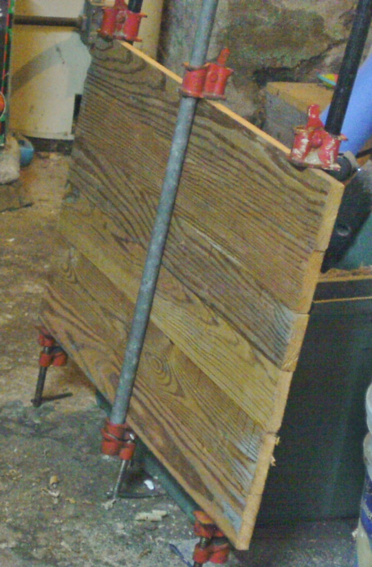

June 12, 201412 yr comment_1754 A day in the clamps for glue to dry? Yea that should be plenty of time Report

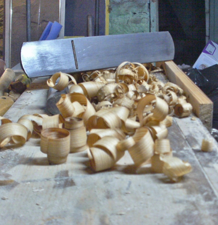

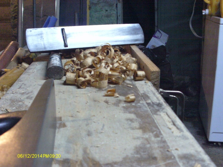

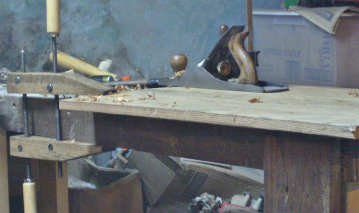

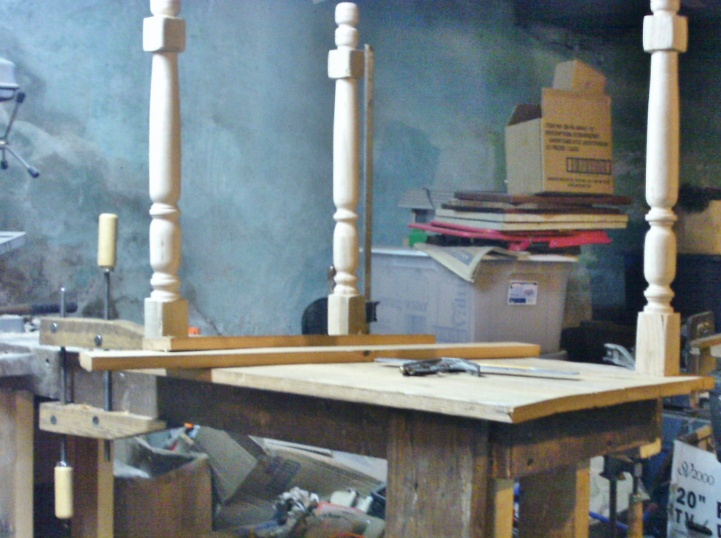

June 13, 201412 yr Author comment_1753 Have all four legs done, now. Took the top out of the clamps, and did a little bit of plane work Between that Jumbo Jack and a belt sander, top is almost flat. Worked on some aprons, getting them close to the right size. two were a little too wide, and one still ahd a groove on it. Clamped it up, and sent the Scrub Jack to take things down There is nothing Dainty about that plane. It will take things down FAST. Got close to the layout line, and switched to a more "refined" plane Once the aprons were all the same width, I set up a few legs, and laid out for lengths on the aprons, Might be a 3/4" tenon on the ends.... Eh, we're getting there, sore back and all... Report
