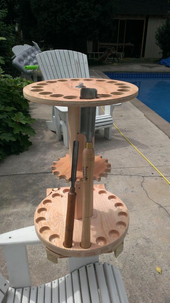

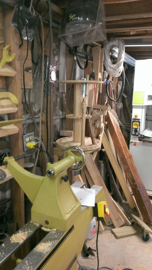

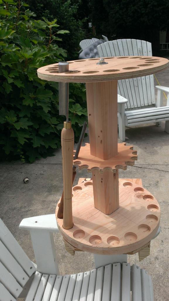

September 3, 201412 yr comment_160 See the tilt differences? IT's supposed to keep the littler tools from spinning out What lathe tool carousel picture would be without a Where's Waldo picture with the wood carousel lost in wood clutter? If you can find it in the first thirty seconds of looking you win a prize. It's an a ll expenses paid dream vacation to the mists of Avalon long ago and far away. You even get to have dinner they Mordred and Morganna Report
September 4, 201412 yr comment_164 I get it now! I was having trouble visualizing the center ring. Much nice than the one I built. The tools are easier to identify and remove from their holder. But I still hate you because of that lathe ;^) Report

September 4, 201412 yr comment_161 Cliff that is a really nice Carrousel for the tools. Now here is just a thought to help keep them steady, Put you a small round rare earth magnet in the top and the metal of the tool will attach and hold it in place so they down bounce around. A small magnet and a little glue and they will stay put. Report
