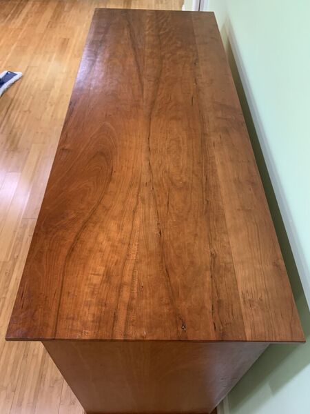

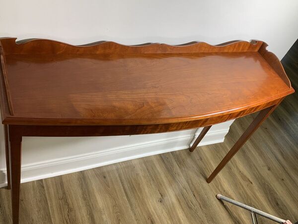

You know, I've heard of this, but have never experienced glue creep in any of the several tops I've built over the years. If glue has expanded and is extruding out of the joint, then wouldn't inadequate clamping pressure be the cause? Would wood stability/movement be factor, specifically expansion? Anyway I don't fully understand it, so I'm going to do some research, but right now I'm having trouble seeing how it could be the glue, It would seem to be more related to the tightness of the joint, amount of glue and clamp pressure.
But, Fred, you made me look. 🙂 I checked a dresser and two night stands and a hall table, a dining table all built 2-6 years ago. I don't see any glue creep. Maybe I need to look closer....
To answer your question, though, I'm not aware of the glue creep issue, but in order of frequency, I use 3 glues: TB Original, 2) Elmer's Glue All, 3) Old Brown Glue. Could that have something to do with why I don't see it?
