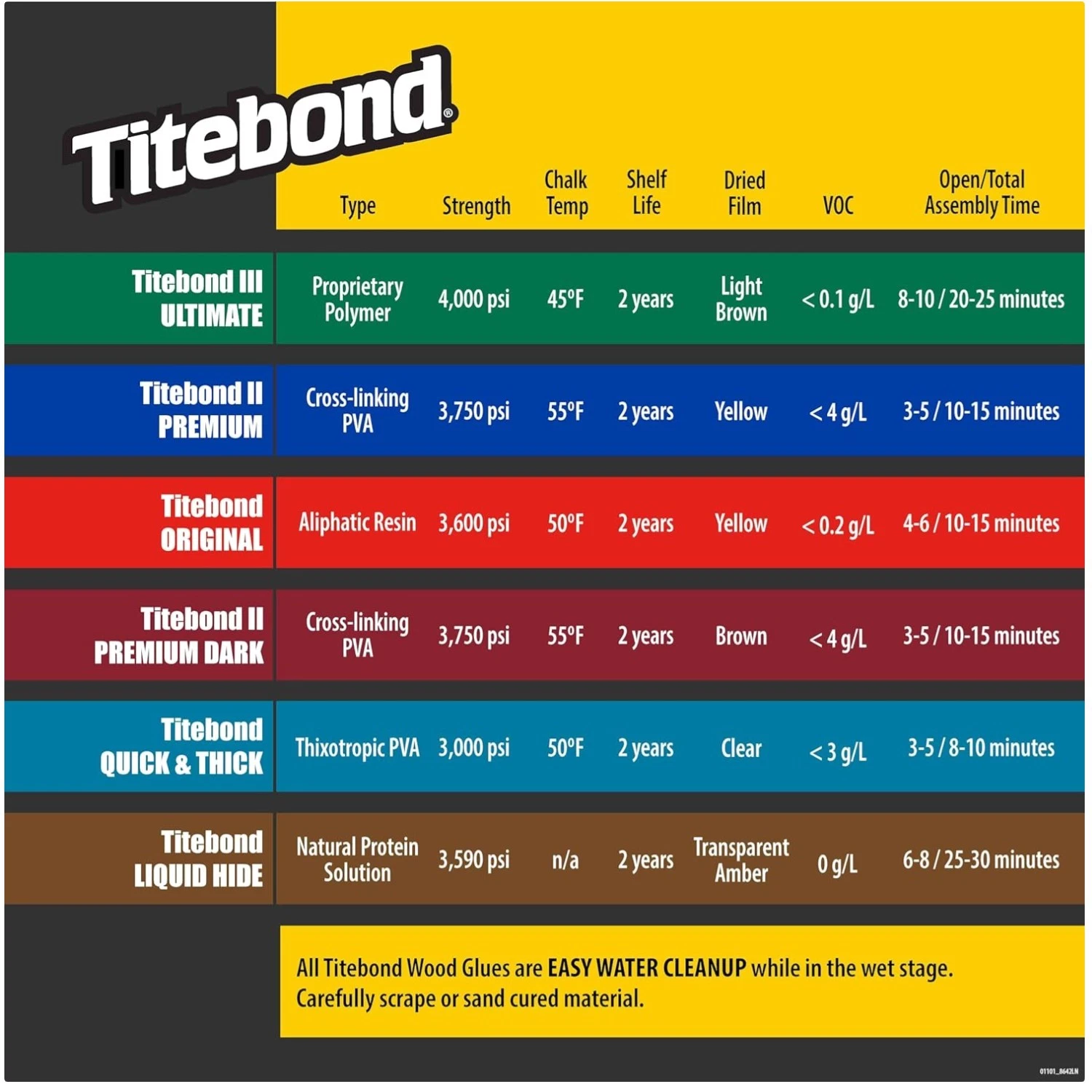

Been awhile since I did any woodworking 😅 which one is the brownest in color? I know I liked to have that one on hand for dark wood glue ups, and Titebond original for light wood species glue ups. Specially when needing a really invisible glue line, keeping in mind the tone color of the different TB's has always been a consideration of mine. I always like the TB III for the open time too.

Looking at the chalk tempt TB3 is 5 degrees lower than TB original and 10 degrees lower than TB2 - now that is an important plus for the product. I worked a couple years in an unheated commercial shop here in AZ, and in the winter we had trouble with being below the chalk tempt of TB2 now and then.
Information about "chalk temperature"
What is Chalking?
  • Definition: "Chalking" happens when glue is used below its minimum temperature limit.
  • The Process: The water in the emulsion evaporates too fast or the polymer particles fail to coalesce properly.
  • The Result: The dried glue line turns a brittle, opaque, chalky white color and loses its structural strength, leading to joint failure
Good info! I learned about this when I was faced with chalky residue on a small project a while back. My shop temp was simply too cool (pre minisplit days).
