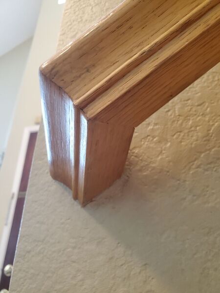

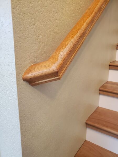

Hey folks, anyone know how these handrail return ends are secured to the wall?
Are you sure it's secured?
It doesn't budge Fred, I tried to pull it away with a pretty good amount of force, it's stuck on the wall, if it wasn't secured, I would think it'd pull away at least a 1/16".

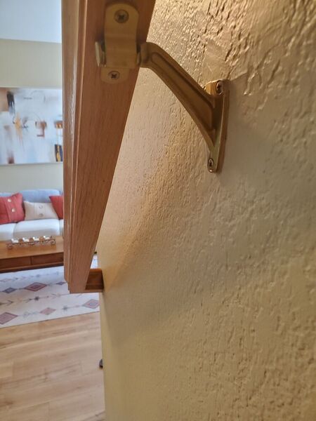

It may be screwed from the back through some blocking prior to drywall install. Or blocking added later and the drywall repaired. I did this method at one of our houses.
Any signs of a plug on the side or bottom covering a screw hole? The first photo enlarged shows this as a possibility.

Thanks Jim, I do think it's screwed from the backside for whatever reason, California building codes are pretty anal about things like this, earthquake and seismic, I don't know, just taking a WAG. I looked for any holes that may have been plugged Jim, but the only ones are for the return piece joining the main rail.

Hey Smitty, I pulled the first couple brackets to see if the end return would loosen up, and it was tight as ever, so per my reply to Jim, it has to be mounted from the rear or something.
Long story short, I gave up on removing it, and just settled for painting it in place. Not my preferred method, but since time is running short and we need to list our home in a couple weeks, I gotta move on. Thanks to all for your help!

By the way @JimM , what looks like a plug covering a fastener, was a knot.
