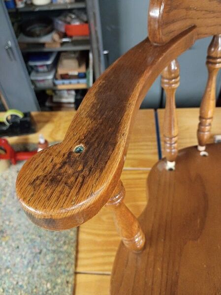

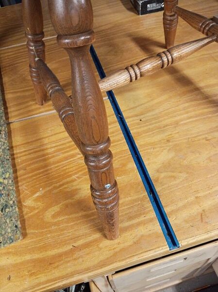

Screws in an attempt to tighten up some joints. Screws will keep the joint from coming apart, but not fix the wobble from the loose joint. And a few missed their target. Three different head types. Nails in joints are even worse, less tight and hard to get out without damage.

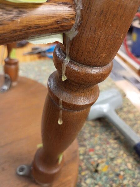

And glue drips never cleaned up.

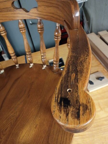

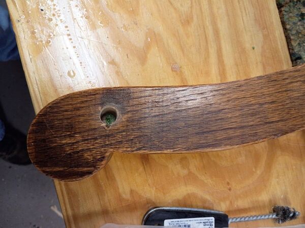

Arms were filthy. I could scrape the gunk with a fingernail. Cleaned up with dish soap and water. Body oils/acids ate away most of the finish. Will touch that up later when the surfaces are dry. 90% of furniture soiling can be cleaned up with detergent and water (AKA polar solvent). Every once in a while you'll need to follow with mineral spirits (non-polar solvent). Screws here, too.

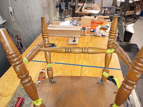

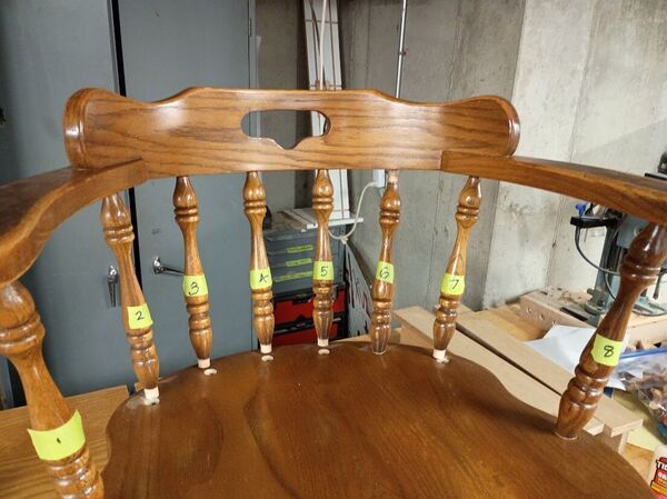

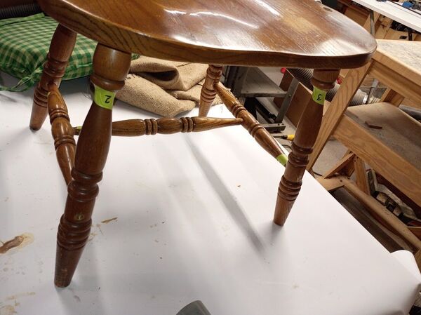

On to labeling the pieces. In my methods, every piece only needs one label. And I number them in clockwise order. There's no reason to label a stretcher left front (LF) and left back (LB). If you put the front to the front, the back is in the back. On the legs I start at the leg furthest from me, label it "1", then go clockwise. On the back posts, left to right. If there could be any confusion about back vs. stretcher pieces, I'll do the back pieces A,B,C... The problem with left vs. right is which way is the piece oriented, and are you labeling from the side facing or the side sitting?
Here you can also see the back pieces that have come out.

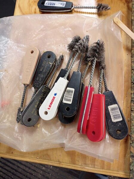

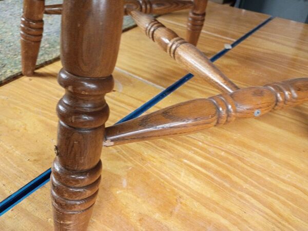

Take the joints apart that are loose. Using a soft mallet or Quick-Clamps in reverse will help remove the loose but sticky ones. Then remove residual glue. I use plumbing wire brushes and a mortising chisel on the mortises and a light sanding on the tenons. If there are wedges in thru tenons, you may need to drill or chisel out the wedge and/or saw it once out. Make new wedge pieces.

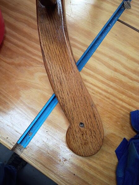

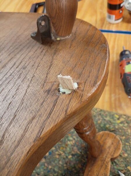

Fix any pieces that are damaged. Here's a back post where the screw missed center and split the wood. Glued and clamped back together. If possible will try to hide the crack in an inconspicuous orientation.
Also, as you can see from the wear on the legs, some of the stretchers must have been out for a while before DPO added screws.

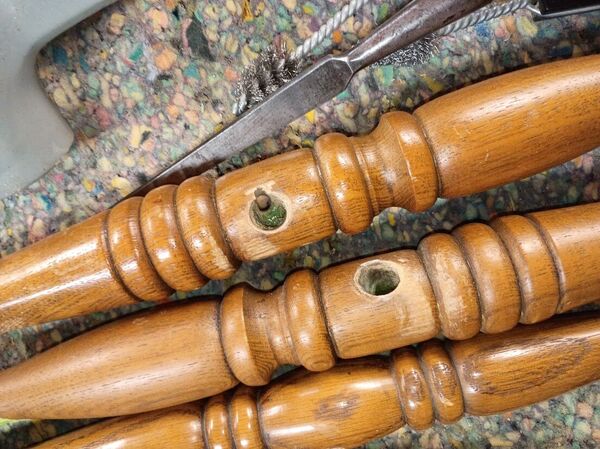

Here's the wire brushes and more of the back spindles

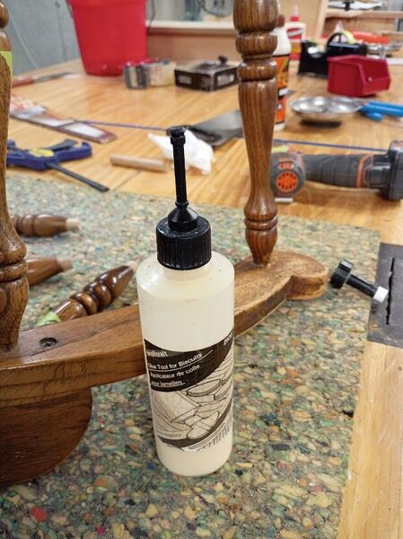

A handy glue bottle for getting in small mortises. It has different sizes, one for biscuits and another one for flat mortises.

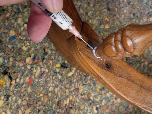

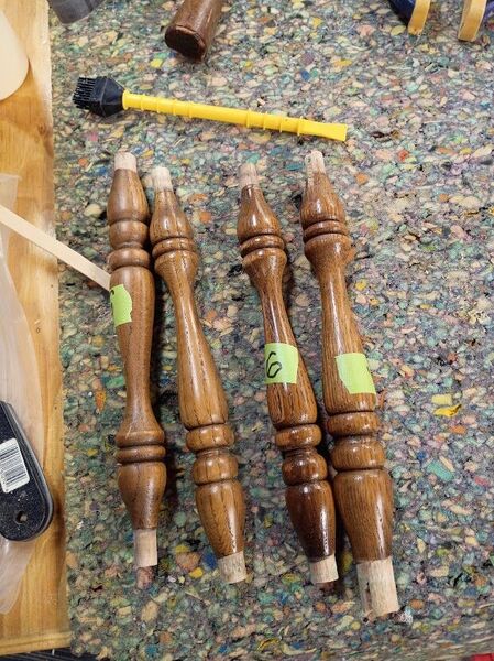

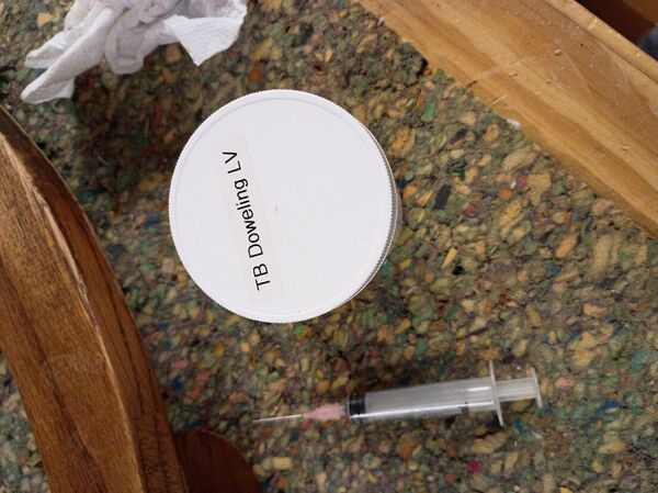

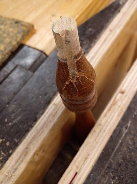

Trade secret: There were some back spindles that did not want to come out. In the past I've used Veritas's Chair Doctor Glue. But when I went to use it on another chair last January, I could not get it. I don't know if they discontinued it or just too cold to ship from Canada. Bob Behneke, the Titebond guru, was here at the ww club meeting and I asked if they made anything similar. He said yes, but they only sold it in 5 gal tubs. I needed about 1-2 ounces. He said they might have some in the lab, so he sent me some. It is Low Viscosity (LV) so you put it around the joint and it wicks in and glues up. I apply with a syringe.
Wedges for the end of arm spindles. Had some thin stock, cut on a band saw and tapered on a disc sander.

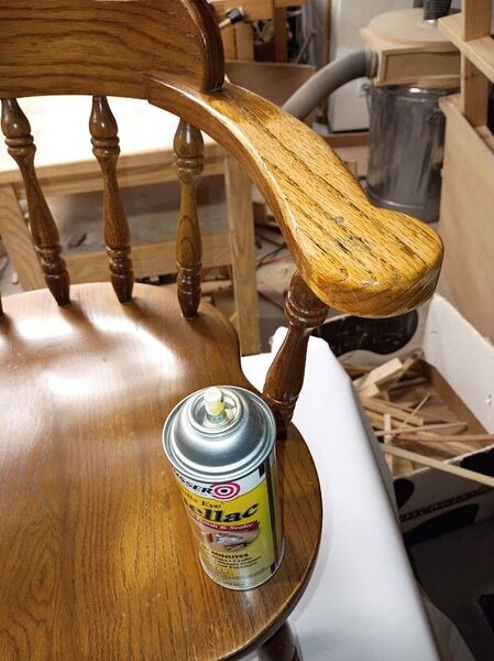

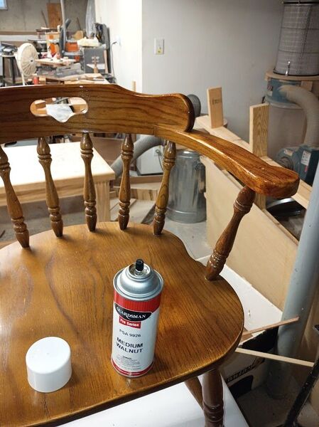

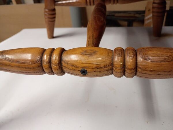

Cleaned up the numbers and glue. Then applied a coat of dewaxed shellac to seal in any potential silicone oil contamination (e.g., Pledge). Let it dry while I decided it was just easier to put in some uniform nice screws instead of filling all the screw holes. Then applied the first coat of toner. When it dries, will steel wool it out, maybe add more or use touch up pens and then apply clear coat of lacquer.IMG_20260730_151202345.jpg

You can get syringes multiple places. I used to get insulin syringes at my local pharmacy. If they won't sell them to you or you'd have to buy a large quantity, you can get veterinary syringes at places like Rural King or Tractor Supply. They are a larger diameter, but sometimes you need that.
If you can't find the low viscosity glue, some people will drill a small hole on a hidden side and inject glue in the joint that way. Just be aware that most mortises are way deeper than the tenon going in. So there's a lot of empty space in there.
