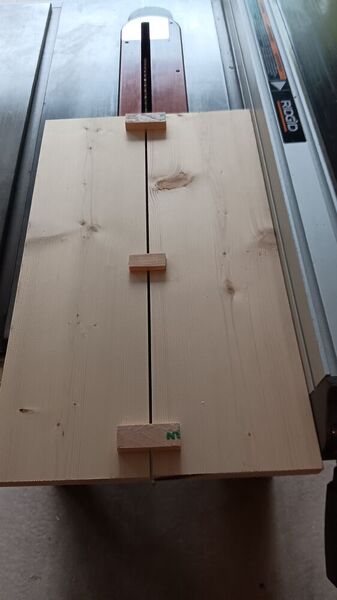

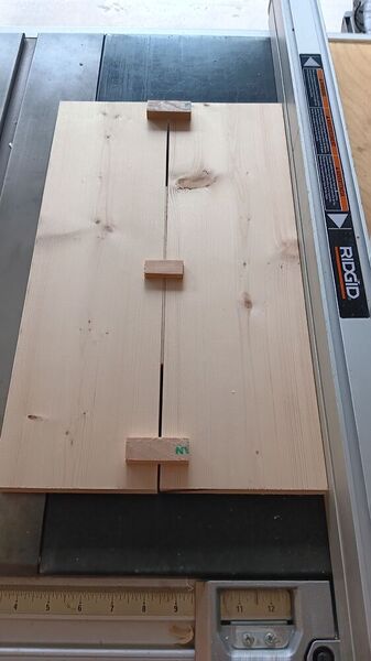

You take your boards to be joined and create a consistent gap between them where the gap is less than the blade's kerf width. In this photo I placed a 3/32" thick piece of scrap between the edges to be jointed. My blade is1/8" thick. I then CA glue several "scrap holding pieces" across the board's tops to hold them. (You can see the gap spacer between the boards). NOTE: You only want a couple of CA dots. You'll be removing these after your cutting.

Next... raise your blade height to come about halfway up on the CA glued "scrap holding pieces". Do not set your blade too high as you do not want to cut through the holding pieces. Next, move your fence so the blade is as dead on center as you can get it to the gap between the boards.
Turn your saw on and run it thru. Turn saw off.
Next knock off the CA glued screws holding pieces.

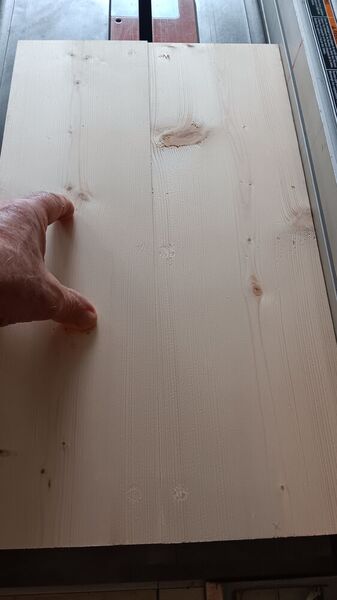

Your joint should look amazing!

Rick a brilliant idea! Thanks for the tip! I can see this working beautifully, you get a carbon copy off the blade on both edges, whether it's a good cut or rough cut, it's going to mirror each other right? You can't go wrong.
That's right @John Morris ! You get a carbon copy of of both blade edges. Just simply running your board thru and flipping against the fence is not the same. This technique truly joints the mating board. Even if your blade isn't a perfect 90° this technique still works.
