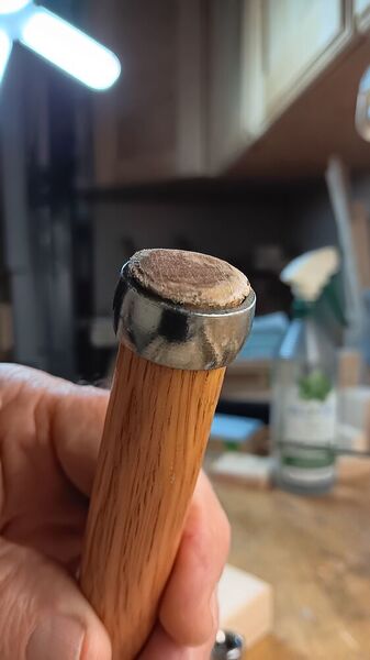

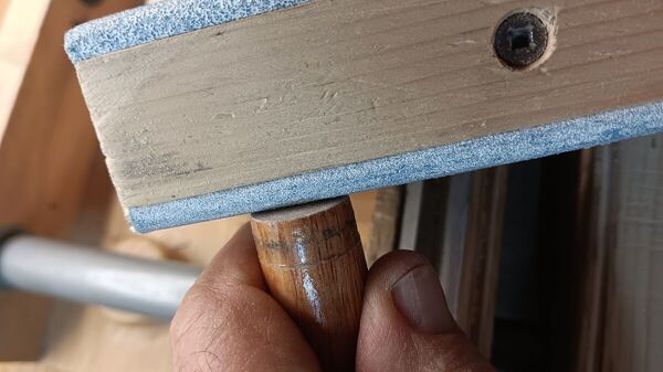

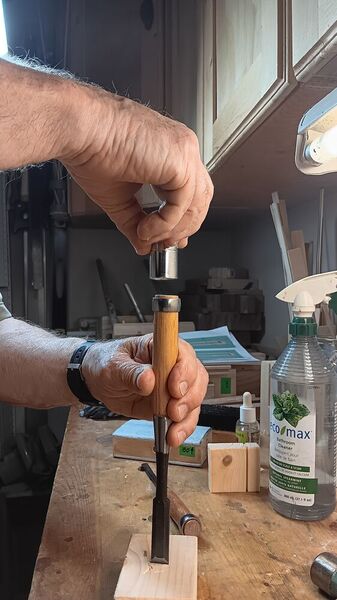

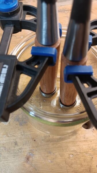

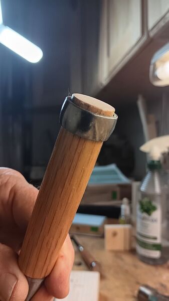

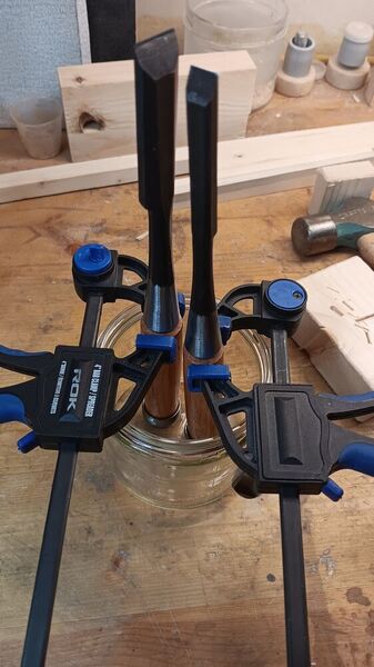

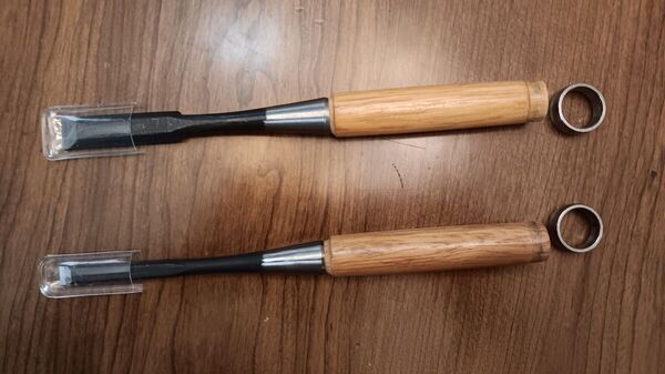

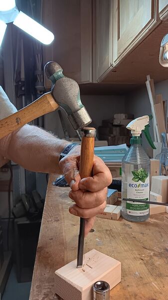

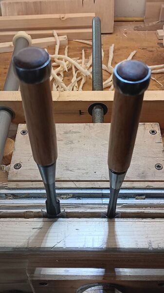

June 23Jun 23 Popular Post For this Father's Day, my son and daughter bought me a number of things, but in specific my son bought me Graham Blackburn's Vol 3 "Traditional Woodworking Techniques" book as shown. Love the book!! I highly recommend it.... and my daughter bought me a couple of Tataki Nomi Japanese Chisels. Both a 9 mm and a 15 mm as shown per Fig 1. They are beautiful!FIG 1Unlike Western Chisels, Japanese chisels need to be prepped for the hoop at the handle's end. Also like all chisels checked for flatness, sharpness, etc.However, these chisels were very sharp upon receiving them and flat. Almost hard to believe they came this way. Shaved end grain on a piece of Maple like slicing through paper. Very exciting!So this post is about setting the hoops.When you buy Japanese chisels the hoops are loose on the handle.Now you may ask, "Why are the hoops on Japanese chisels loose when you buy them?"Hoops (katsura) on Japanese chisels are left loose by the blacksmith by design. Because wood naturally expands and shrinks with fluctuating humidity and temperature during transit and storage. Therefore, blacksmiths ship chisels this way to allow the end-user to custom-fit the hoop themselves before the tool's first use.However... many woodworkers don't know this. So, I decided to share the process as I've learned it.First, you remove the hoops as shown per Fig 2. Note the orientation of them before you remove them. They are often tapered with a bevel. You must put them back on the way they came off. While off, deburr them if necessary.FIG 2You now lightly sand flat the top of each handle. See Fig 3. This preps the wood for a water soak.FIG 3Next is peening the handle's circumference area where the hoop sits. You are compressing the wood. This is called "Kigoroshi". This allows the hoops to slip on nicely around the handle before seating the hoop. In my case, the hoops were already loose enough.Seating is normally done using aJapanese Chisel Hoop Setting Toolbut they are expensive. Many woodworkers use a hex socket. In my case, I used a 17 mm hex socket. See Fig 4.FIG 4In Fig 5, you see the hoop now seated. There should only be about 2 - 3 mm of wood extending above the hoop as shown.FIG 5Next is soaking. With the hoops now seated, place the chisel(s) upside down in a jar of water. You only need enough water to cover the wood end. Don't worry about wetting the hoop. Let soak for 20 - 30 minutes. See Fig 6.FIG 6Now, you start the peening process around the water soaked top's edge as shown per Fig 7.FIG 7You use glancing taps a little at a time to mushroom the edge over as shown per Fig 8.FIG 8Here are the two chisels now per Fig 9 with the completely seated hoops. Let them dry for a few hours before using. The water swells out the wood and makes the hoops very tight.FIG 9Thanks for looking!Cheers!MrRick Edited June 24Jun 24 by MrRick

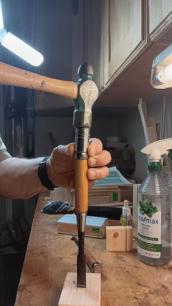

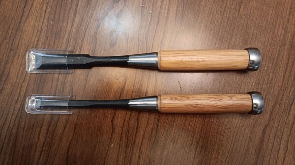

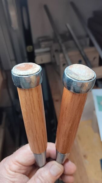

June 26Jun 26 Author One thing I forgot to mention..After peening the edge over and letting it dry from the water soak as shown above in Fig 9, you then lightly sand ( I used 220 grit).Then you finalize by giving a generous coat of Camellia Oil or 100% pure Tung Oil to the end of the handle. This seals the exposed end, slows down moisture absorption, and prevents the wood from drying out or shrinking, which keeps the hoop tight.Here they are now in all their glory:
