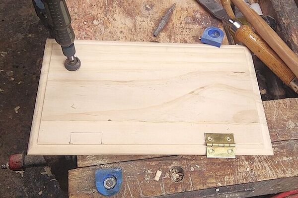

Hinges: These did not have any counter sink around the screw holes, so..after cleaning this up..
I used that bit to counter sink the Brass Hinges...
Count the turns (18) per hole, to get the head of the screws flush...

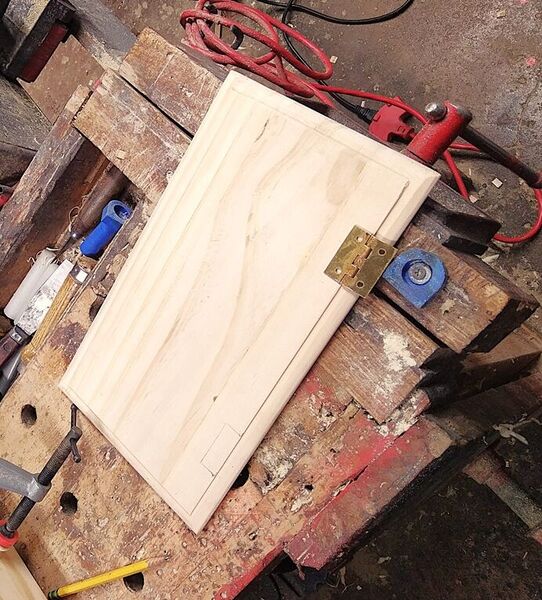

Mallet and chisel to dig out a place for each hinge leaf...Hammer to set the pilot hole punch..
Leaf need to sit flush...connecting the lid to the box was...fun..

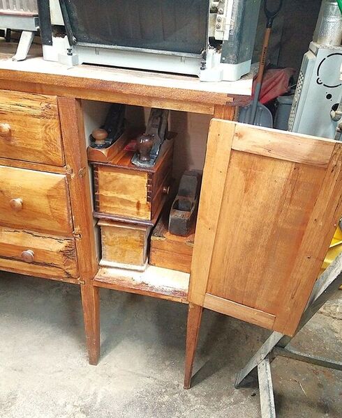

in answer to the question of WHERE this will be going..
I think that will just have to do..close the door..
