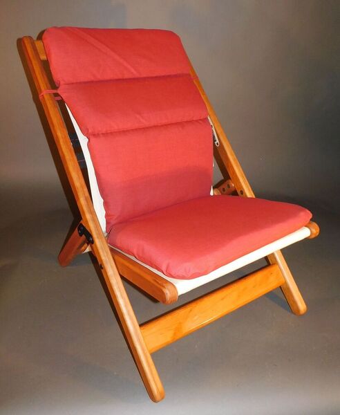

Cushion Arrived. Fits better than the 1st one I bought.
Sits well. Works as designed to work. May require a footrest should I want to nap in it.
Other than maybe one more coat of teak oil to the cherry this is the end of this project.
It will reside in a corner of my bedroom after I get a chance to clear out the corner.

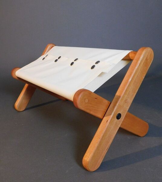

Decided I needed a foot rest to prop my aging legs on when sitting in this chair. Simple design. Canvas sling over 1" dowels limit how far the X frame open.
A cushion for it has been shipped from the Jungle store. No tracking info yet. Red fabric I hope is close to the fabric on the chair cushions. Memory foam core. Straps that will wrap over the dowels and buckle underneath. Teak oil finish eventually. I'll post another pic when the cushion arrives.
4D

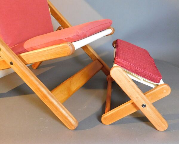

It appears that the cushion I ordered is on a slow boat from China and won't be here until late August. In any case the frame is done with two coats for teak oil on it.
Snaps up so the cushion (whenever it shows up) will cover them.

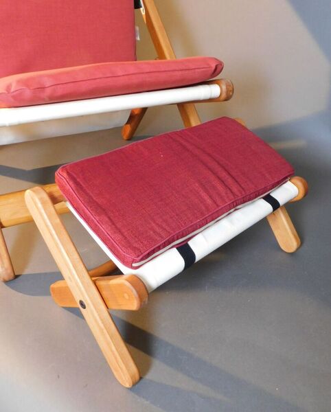

Cushion arrived yesterday. Came vacuum packed and took me 10 minutes to get through the tape and bags and tape and another bag to find it still in good shape.
A little darker than the cushion on the chair, but close enough.
The straps that hold it on turned out to be elastic and wanted to close up the frame when clicked together. I made a "push" bar that hides in the center under the canvas that pushes the frame open to counter the pull of the straps. I'm going to have to consider this prototype one. The bottom dowel you can see should have been 4" up the sides rather than at the end. When you want to get out of the chair that dowel is right where your feet want to be. In use it feels great. A place to put my calves on to hold my feet up off the floor. In use spaced a bit farther from the chair than shown in the photos.
